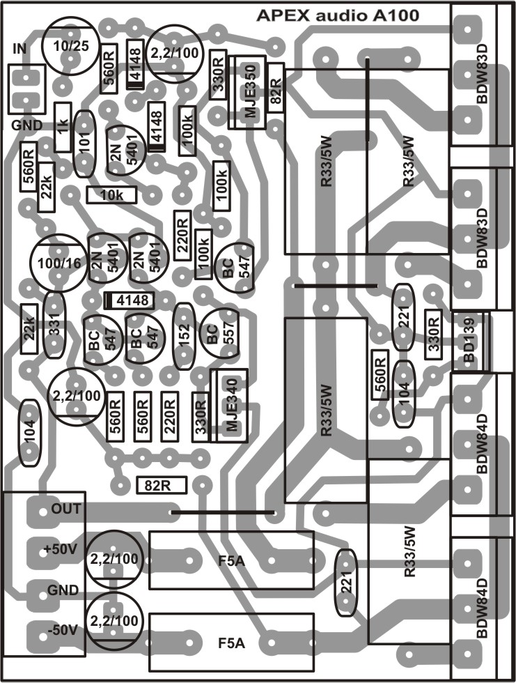

By the other side, I have already built a single-pair output amplifier, and my needs are for a double-pair (small PA applications), since mine worked fine in the living room, but had a big lack in power when tested inside a medium size room (restaurant).
So, I also vote for a more powerful AX-14 version, even with Mosfet output (I will try NX-14, and would like to have it with two output pairs).

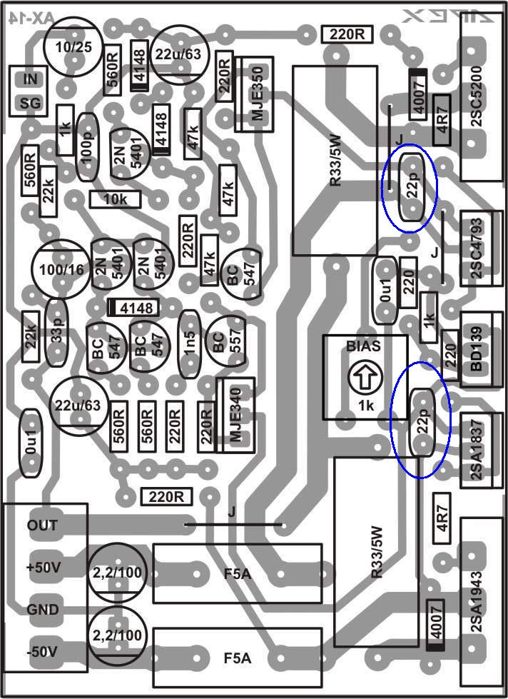

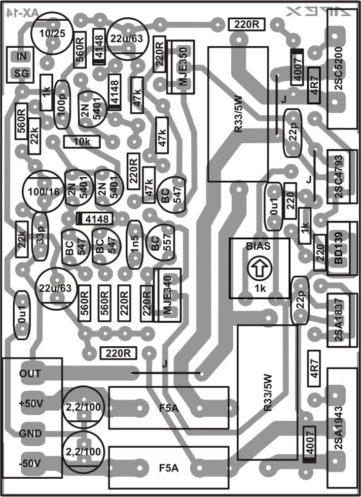

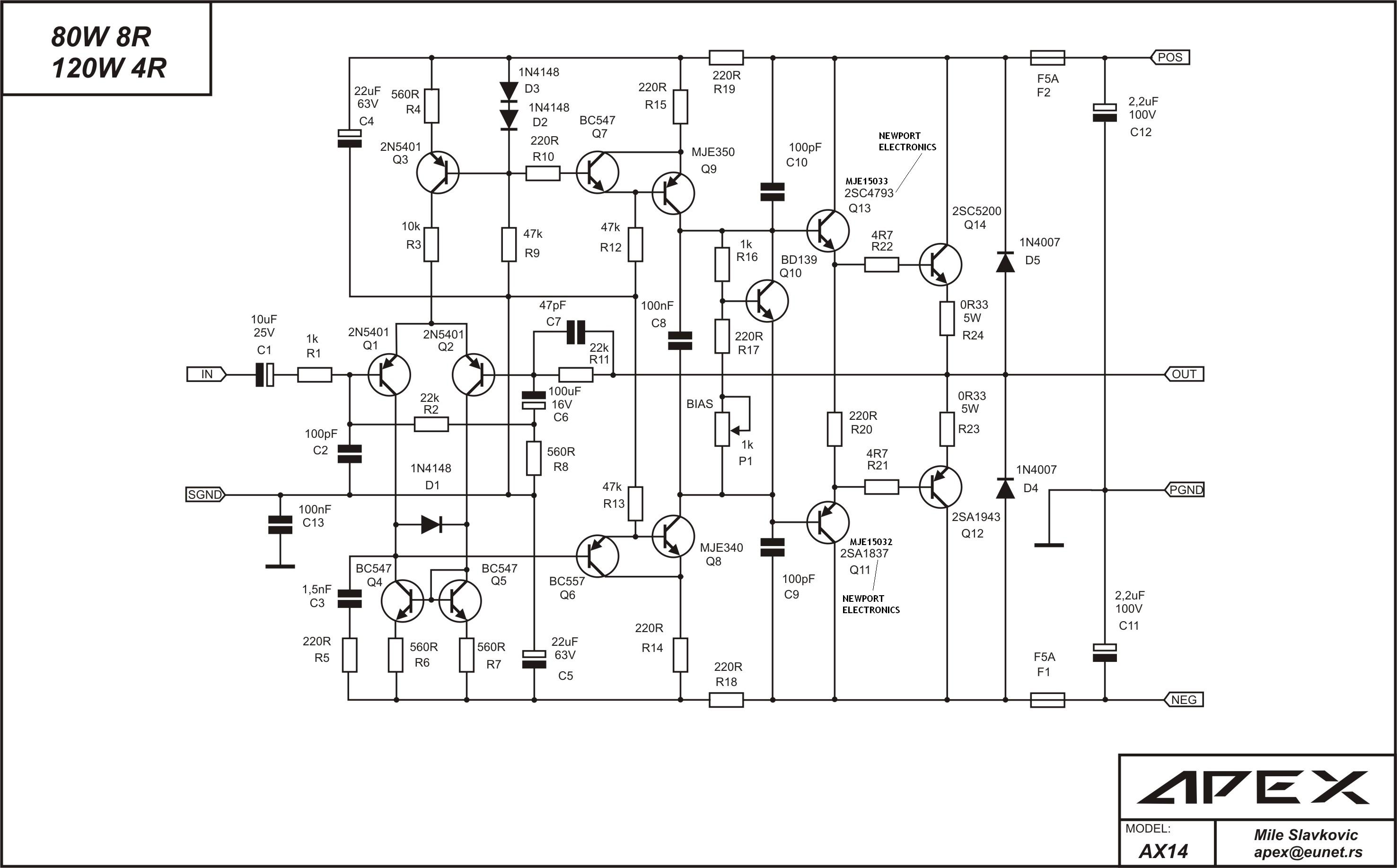

sorry for repeated question... i just finished ax14 i just want clarification before i put power on it :D . the left picture is the original schematic while the right one is for the actual pcb schematic... which one is correct? d4 and d5
I repeat answer: both connections are correct. If you want add more outputs use first circuit, pcb for AX-14 with single pair of outputs use second circuit. Use 10R instead fuses for first powered and set bias to get 500mV on 10R.
Hello Mile,
If I need 20 clean watts, which has a more hifi and accurate sound - the Studio Reference SR50 or this 100W Ultimate fidelity amp ? I will be building either of the amps and etching my own board. (first time)
If you build either of the amps you can compare them. AX-14 sound more neutral on mid and high. I like bass from SR50, but speakers is more important for sound quality.
