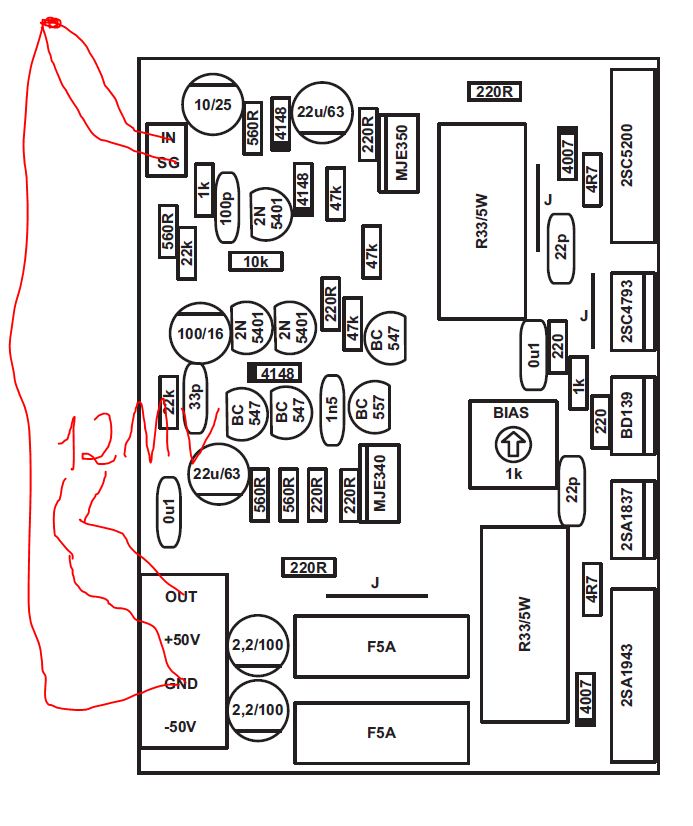

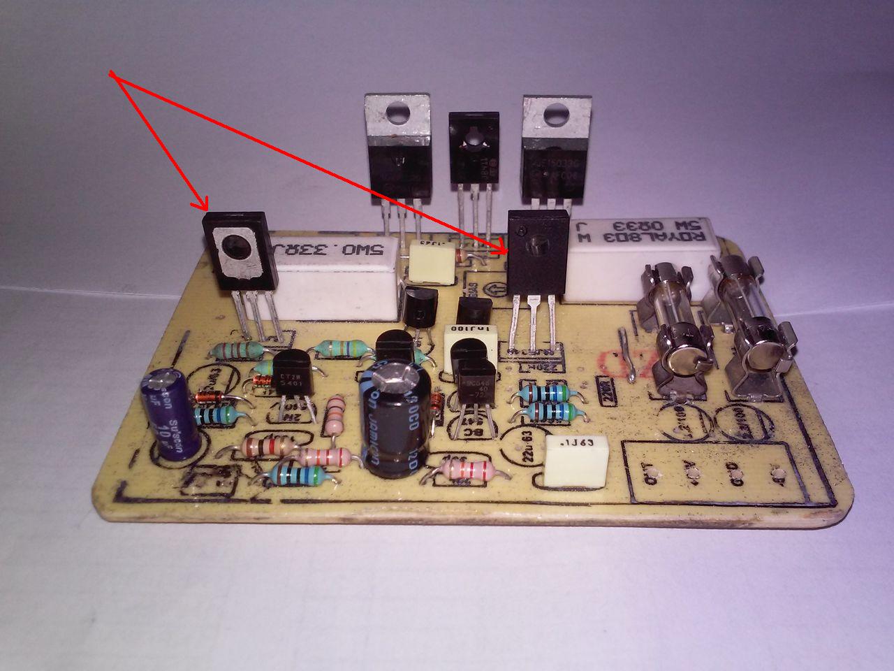

I test al transistors, they all seem ok, the amp worked for a few minutes then it died, i'll post some measurements tonight.
You must describe problem (oscilations, overheating...) just died can't help.
Are these tranzistors in wrong position or they are different parts?I test al transistors, they all seem ok, the amp worked for a few minutes then it died, i'll post some measurements tonight.
I've done some measurements on final transistors:
The psu in +/-30v, and on the output is 28vcc
2sa1943
GND-B-29.6v , B-E -0.02
GND-C-30 , B-C- 0.04
GND-E-29.5 , E-C-0.03
2SC5200
GND-B-29.4 , B-E 0.02
GND-C-28.9 , B-C 0.02
GND-E28.9 , E-C 0.02

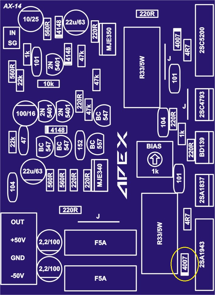

Measure voltage on input and VAS transistors... check diode polarity there is mistake in first post.

Voltage reading taken incorrectly or written incorrectly.
2SA1943 collector should be negative -30v and 2SC5200 collector +30v from GND.
what psu you are using smps or transformer with bridge and filter caps.

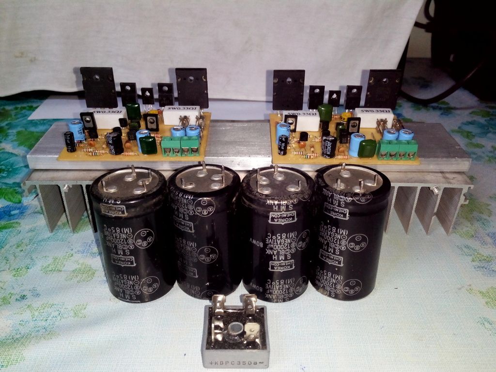

Size : 72mm x 61,5mm
Using 1/4w resistor
Some contribution to APEX amp Series

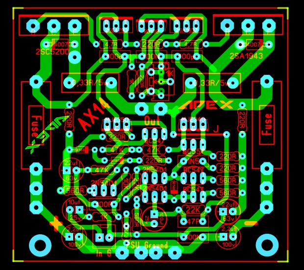

What pcb version you prefer for this AX-14?Nice work,
Regards
PCB from post #1
Yes i see that is a beautiful pcb, but drawing a pcb isn't an easy way.Apex know this.This just redesign, just move fuse on a side.
Regards
Most of good amplifiers are drawing haven fuses close way each other,i believe that isn't without any reason.This way (+,-,gnd traces close each other)minimize the EMI.
Yes like SR800 pcb
SR800???Yes like SR800 pcb
