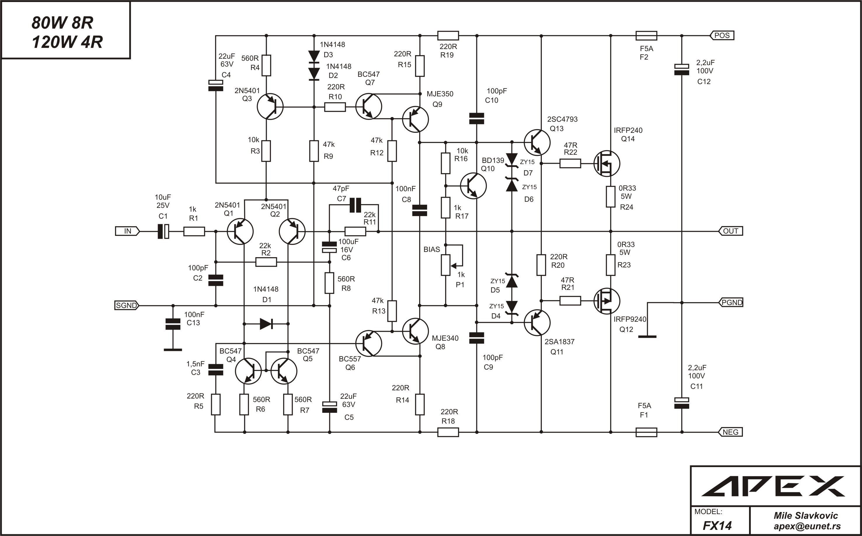

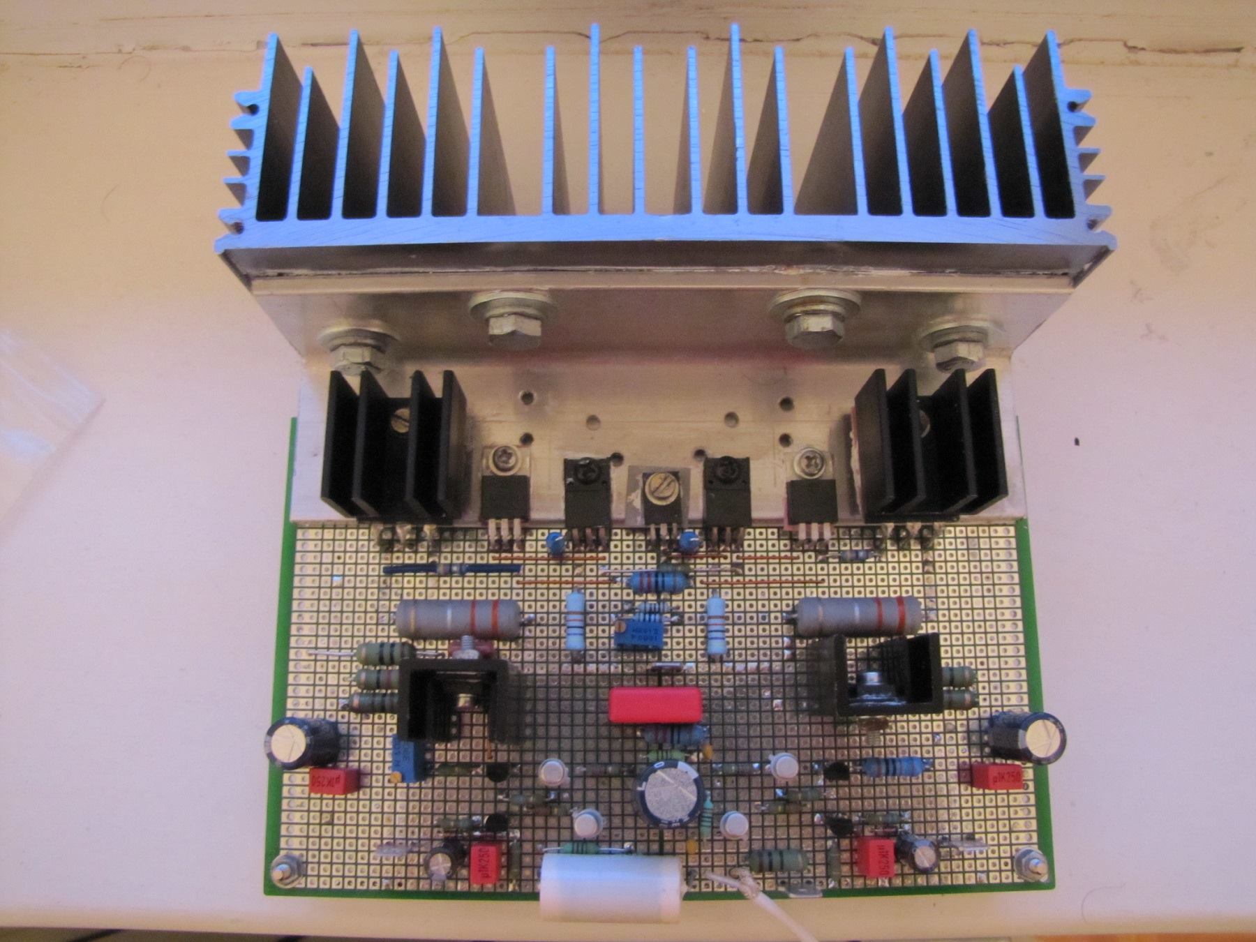

I think I will try It anyway. To 180deg reversing transistor can be easly cascoded for higher voltages anyway if needed.
I have made a drawing of ax14 but with cascoded j-fet front, the performance in the symulation is stunning but stability is not great in sim.

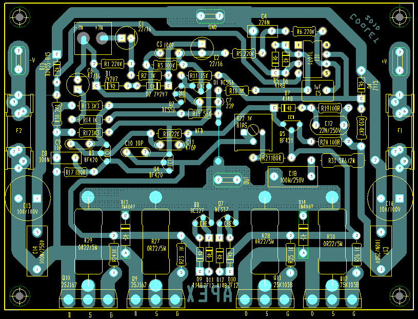

I will try to draw some layout for ax11+ amp.
You can not use current mirror with pure push-pull VAS

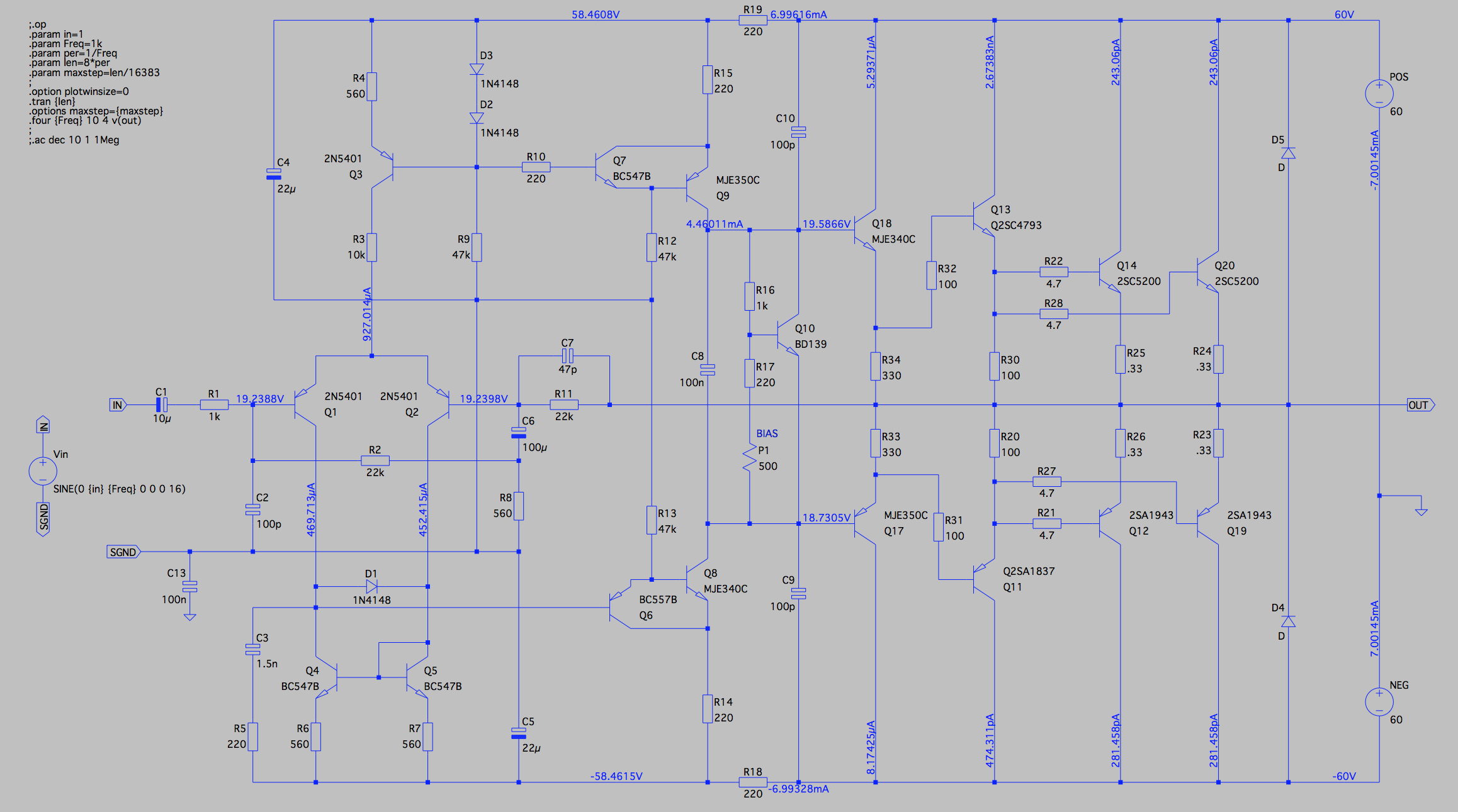

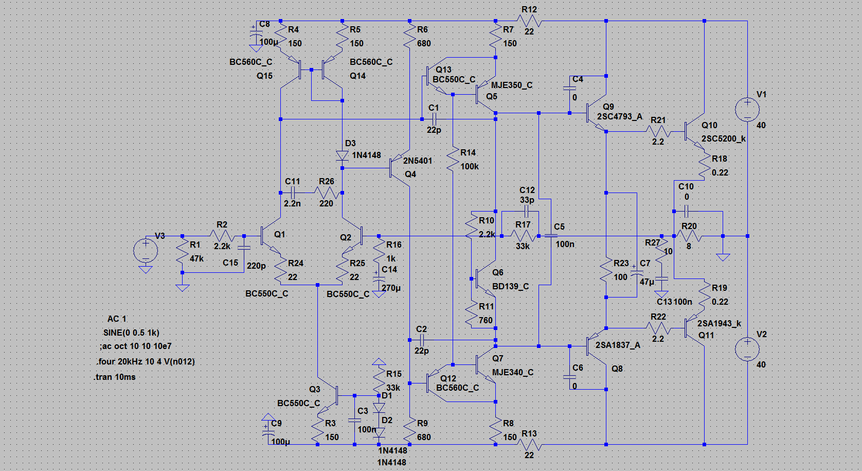

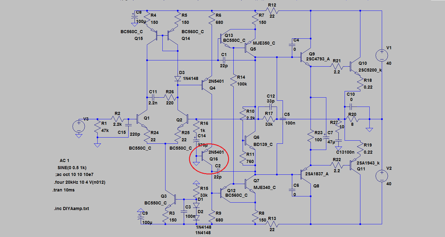

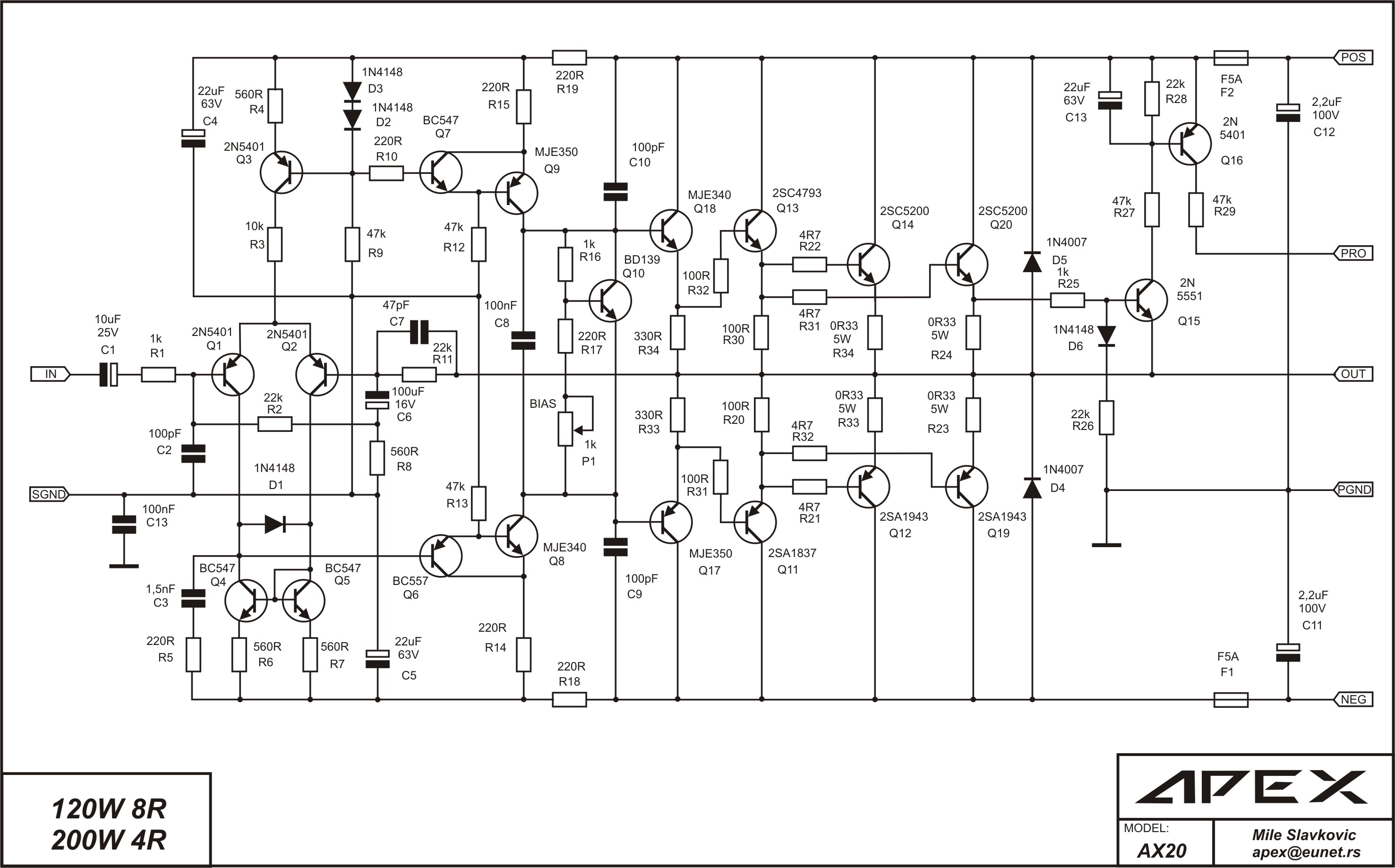

AX20 simulation
Here is a simulation done with ltspice for the AX20. As I'm trying to learn more on ltspice, I was curious about the AX20 and wanted to simulate it.
I embedded the models not in the ltspice default database so anyone using it should be able to run that sim with the same models.
I encountered a few discrepancies about part numbering around the output stages, so although most of the parts have the same number as on the schematic (attaching the one I used), some resistors have different numbers.
Once the simulation is able to run, I can immediately see that something can't work as it is on that schematic, as there is nothing to fix the potential on Q1's base, so I see a huge offset there at nearly 20V, so the output signal is totally offset as well and with a signal not pushing it to clipping, it does clip on the top side.
This thing is missing something to bring Q1's base to ground level...
