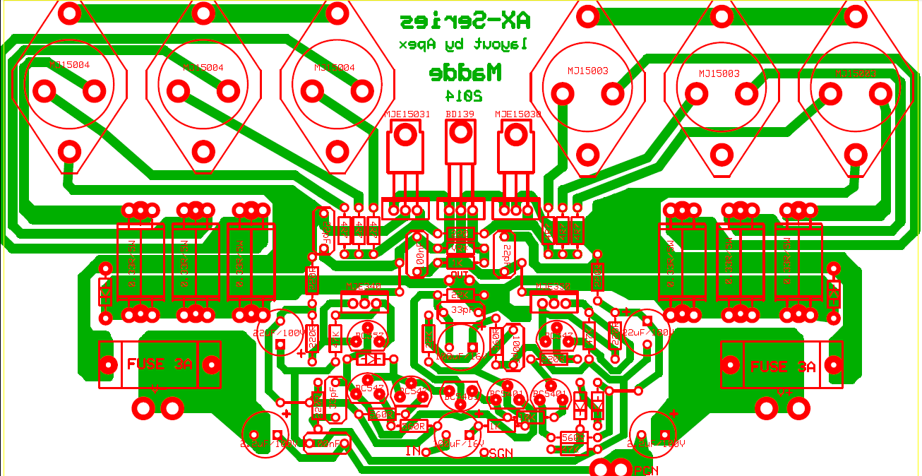

Hi !
Can I use his design http://www.diyaudio.com/forums/soli...imate-fidelity-amplifier-221.html#post3502644
to make a pcb and start the build ?
Is this PCB design copyrighted ?

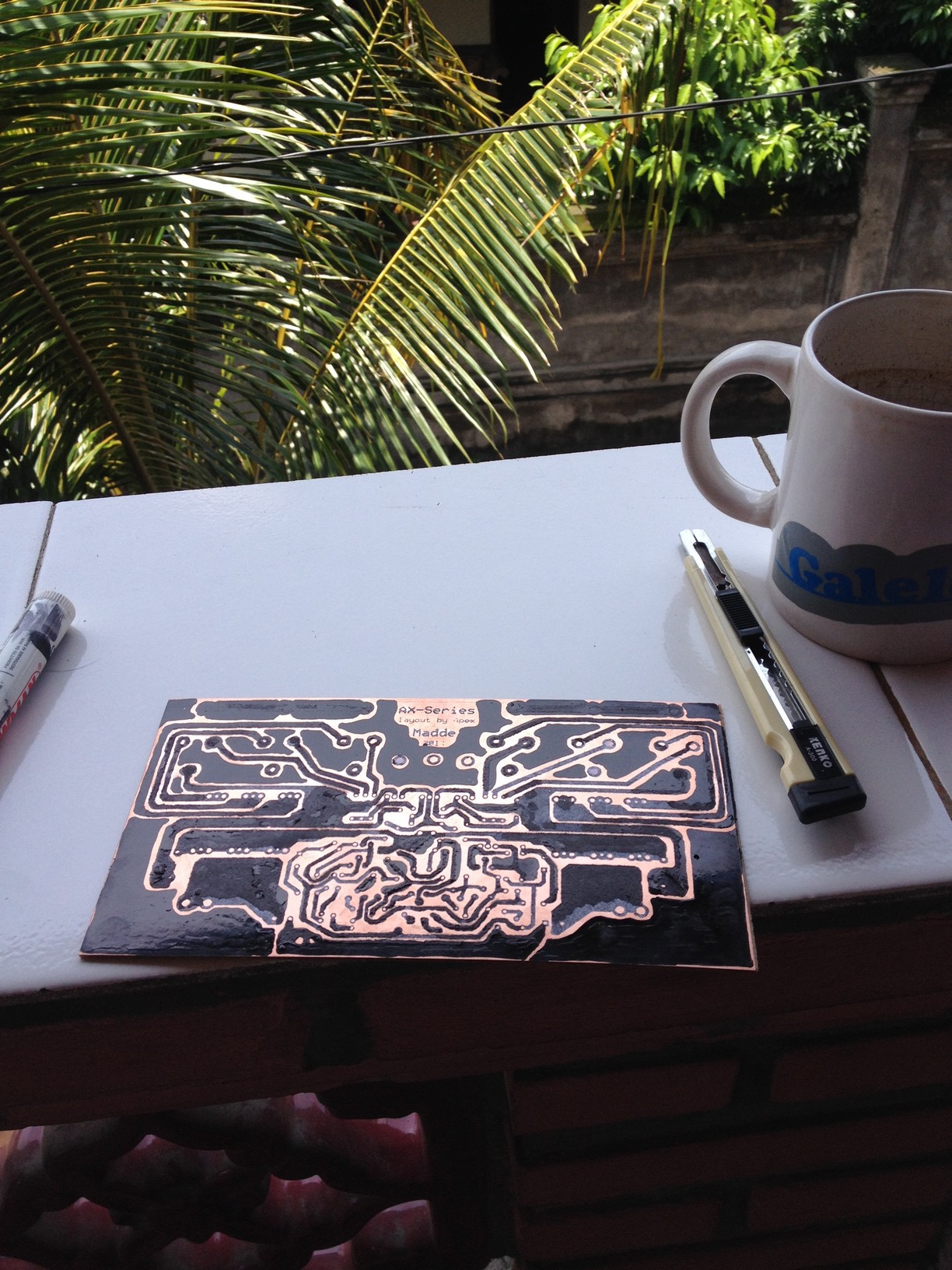

I'm already finished my board,
- start supply with 12VAC with protect 10Ohm (series with board).
- input short to ground
DC offset measured 3.9V
what first step to do fix this problem?
I find track missing...

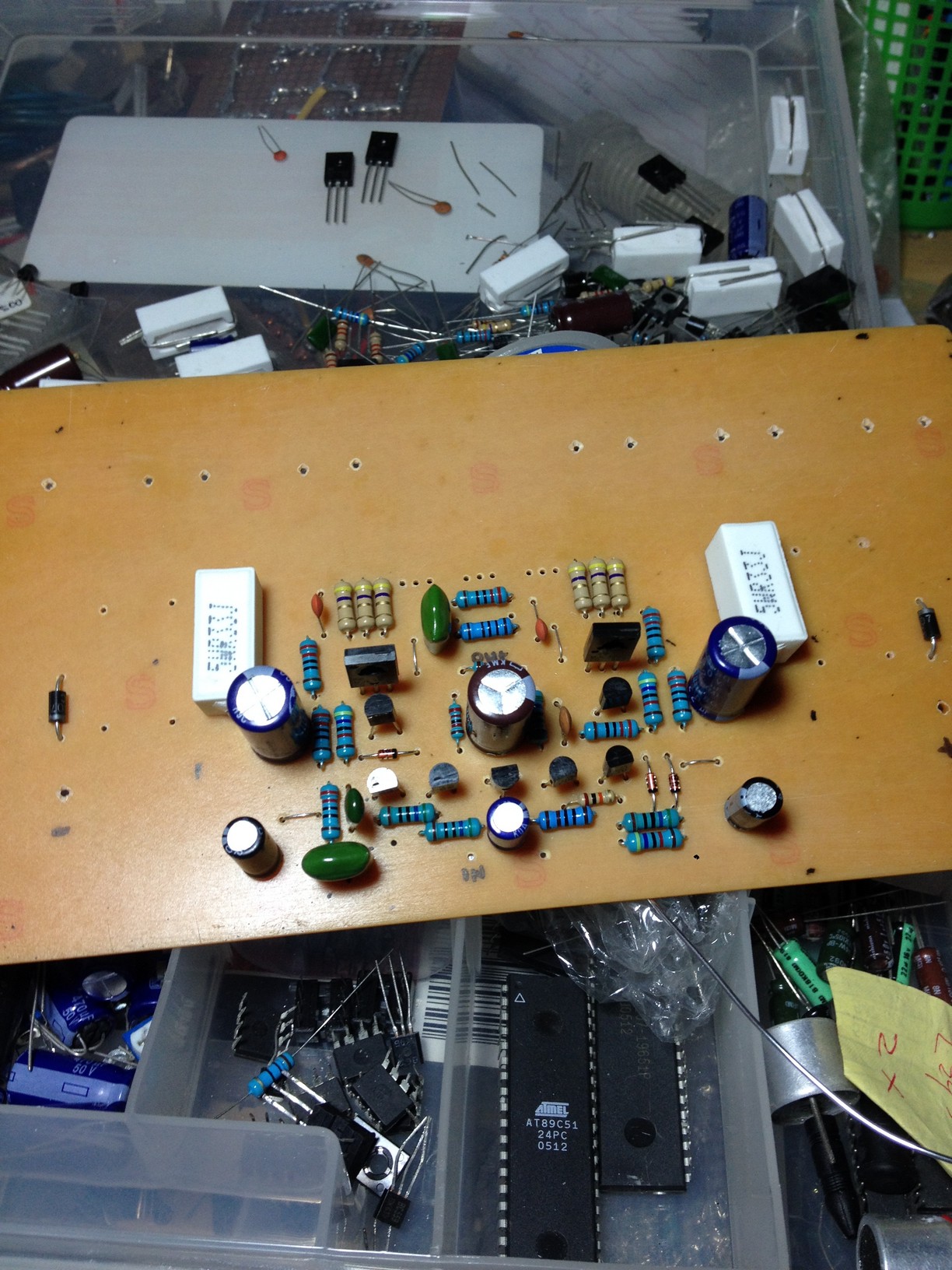

Hi Apex,
i solved my problem (hum and very hot TR final),
- first steop, i replace MJE350 and BC547 with new one (this solved not stable DC offset)
- second step, i try to bypass signal ground to power ground and this solved my huuumm problem and DC offset get 50-80mV (of course with no hot TR final)
sound very nice (so warm with deep bass )
NB : my layout for test using 5200/1943 tr final, next step will change using MJ15004/MJ15003.
