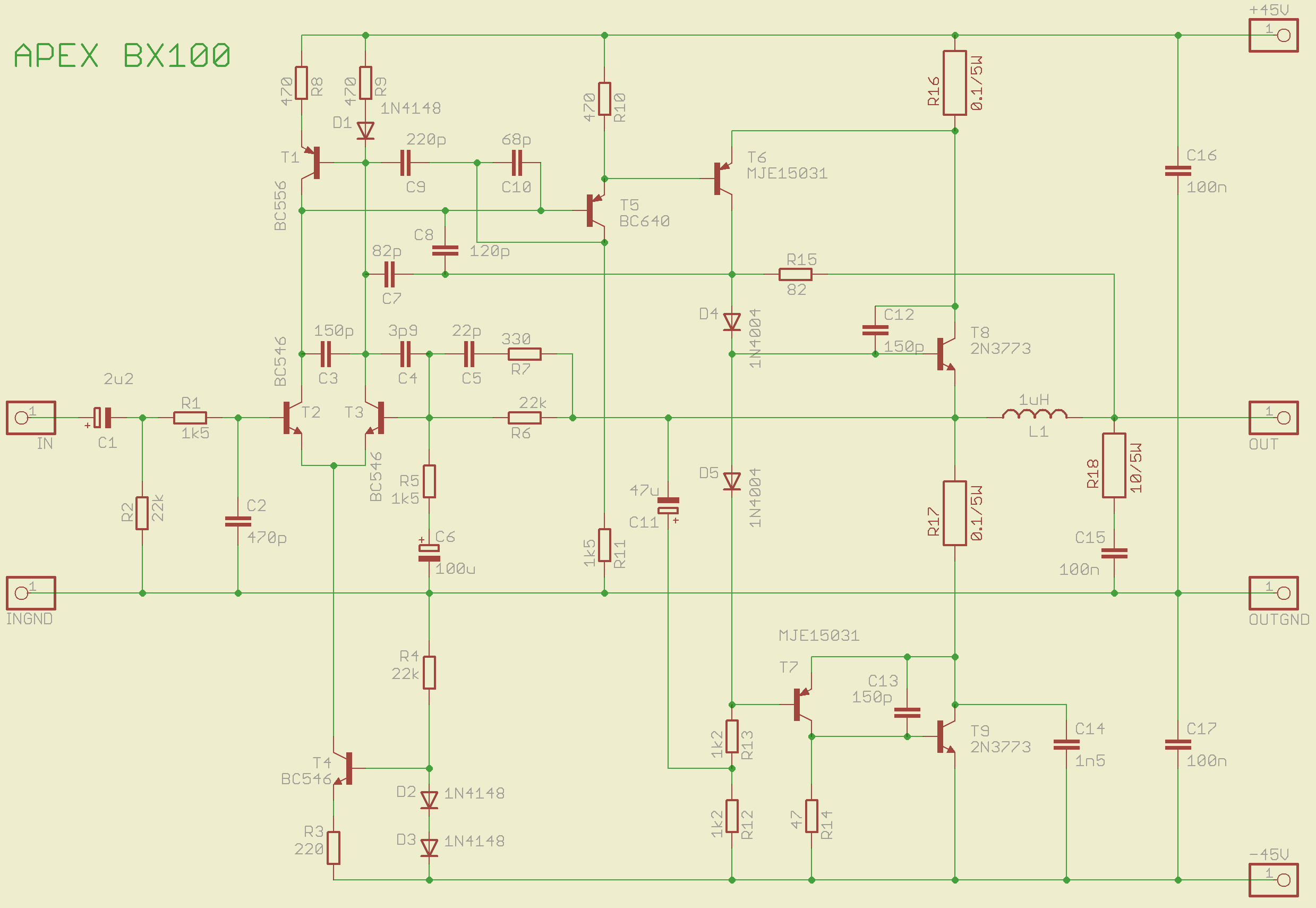

Using eagle. Let's verify that I captured the schematics without mistakes, then I'll work on board layout.
The 2N3773 being TO3, to avoid any extra wires, I'll make the board so we can have the heatsink on the board.

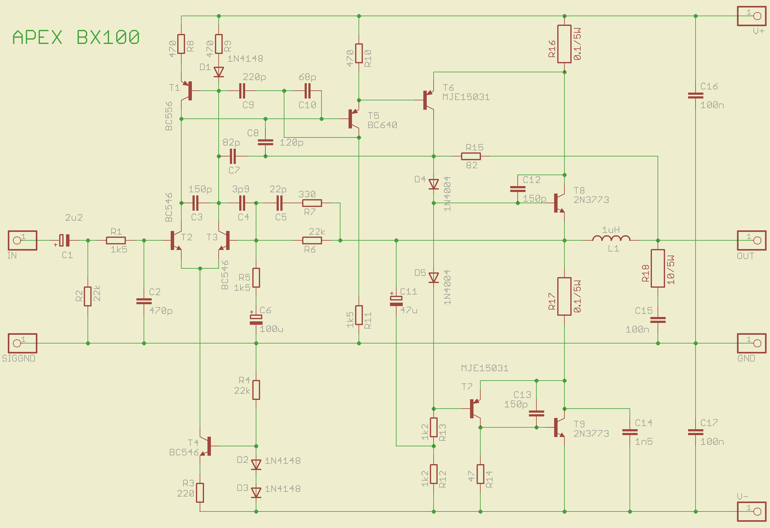

I have a doubt about the polarized caps from my previous schematic. The ones I called C6 and C11 (they're not named on the original sch). Logically I would think C6 should be bipolar, but on the original schematic, C6 and C11 are inverted in relation to each other, and C11 should have its negative end towards the V- rail. So that one is reversed and wrong on my schematic. But then what about C6?
I made a change to my schematic. I reversed C11 but left C6 as it was. Tell me if I'm wrong. I think C6 would be better as a bipolar.

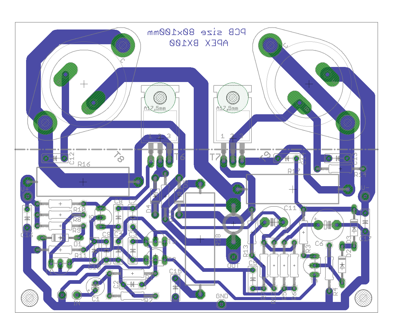

I made a first shot pcb layout. So bring in the comments and let's improve on it.
The board is half a euro size (80x100mm), but almost half of the real estate is used for the heatsink. Those TO3 take some room...
This amp would only run as class B. Perhaps we could add a bias adjustment and push it to class AB. I would use a TO126, maybe a BD139 or something like that and it would go on the heatsink as well.

I made the board myself to test my layout.
Cool, so you know for sure it works fine and without issues.
The board being so tiny, makes the much cheaper to manufacture, but I was checking of having a board like this made and it would be at least 70 euros (plus shipping) to make one, and at the cheapest board maker that I know of. Then while increasing the quantity, I found that having 10 boards made would cost the same exactly, and the cost per board continuing to go down from there, below 7 euros per board (plus ship), this can become feasible, as long as the purchased quantity is well over 10 boards. So this seems like a group buy possibility, if that amp gets a bit of popularity, the quantity could reach 100 maybe...
This would require making gerbers, and while doing this, perhaps making last minute fine tuning on the layout.

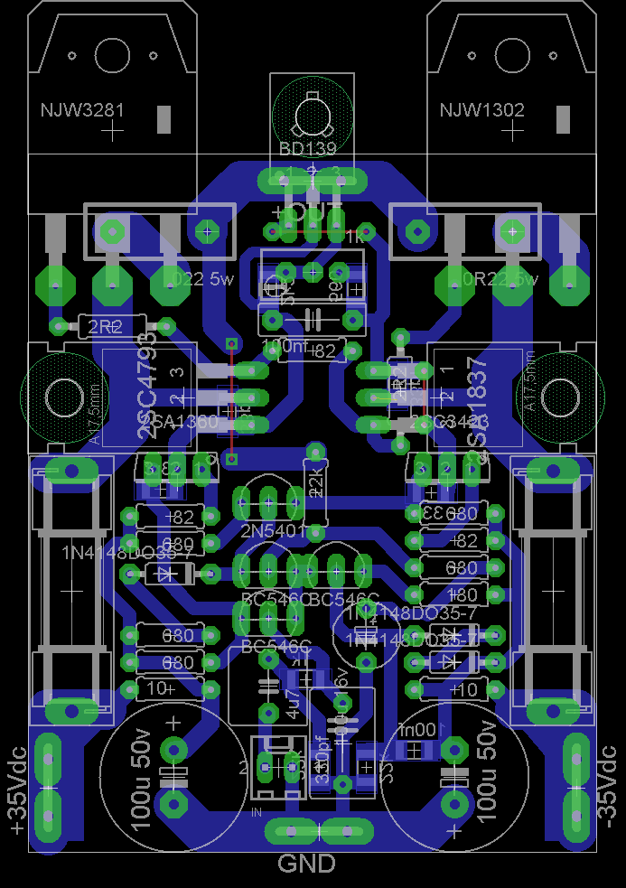

Here is mine. Strait derived from Borys one. I just made some slight changes to use Panasonics FC caps, Mica-Ag for signal to ground caps. I use some SMD resistors and caps to save space. Panasoncics and Mica-AG take a uge amount of room on a so little board. (54*65mm). I use NJW3281/1302. This nice little board can fit quite good to Home theatre project with 5 chanel in one box.

Nice work, this is class B hi-fi amplifier like QUAD 405 no need to change it to class AB there is many class AB amplifiers in this thread. BC546/556can be use with +/-56V maximum but if you want higer rail voltager use 2N5401/5551 and add two more pairs of output like in QUAD 606.

Nice PCB, AX11 is very usefull aplifier,

I think soldering smd parts is for those who still have a good eyesight and steady hands. I myself would never attempt to solder such parts (I'm too old for this now).
One thing that would be nice though is to try to get rid of the straps. And if using smd parts is just to stay within the original board size, then why not make the board a tiny bit wider, there is no physical limit to the board size, it turned out that way but there is nothing wrong with increasing its size a little.
If there are no smd parts to solder, I would consider building that little amp...
