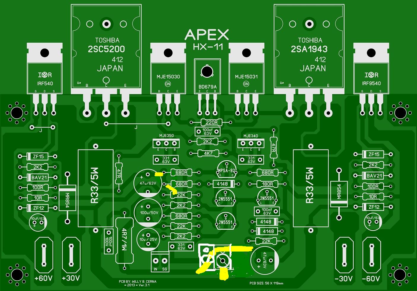

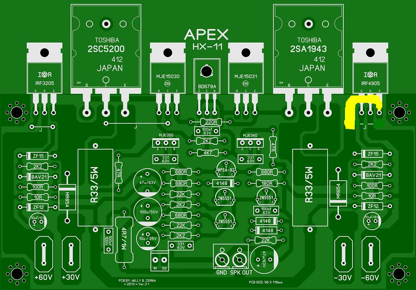

wiljj my friend,at schematics at "negative side" of amplifier 15V zener is between G and S,D is directly connected to higher negative voltage. i'd say that you mixed up S and D connections,sorry if im wrong but please re-check by schemtics... otherwise,it looks great as all your pcb's :)
HX11 pcb must be corected like this...
Sorry guys and thank you for correcting my mistake....
really appreciated...

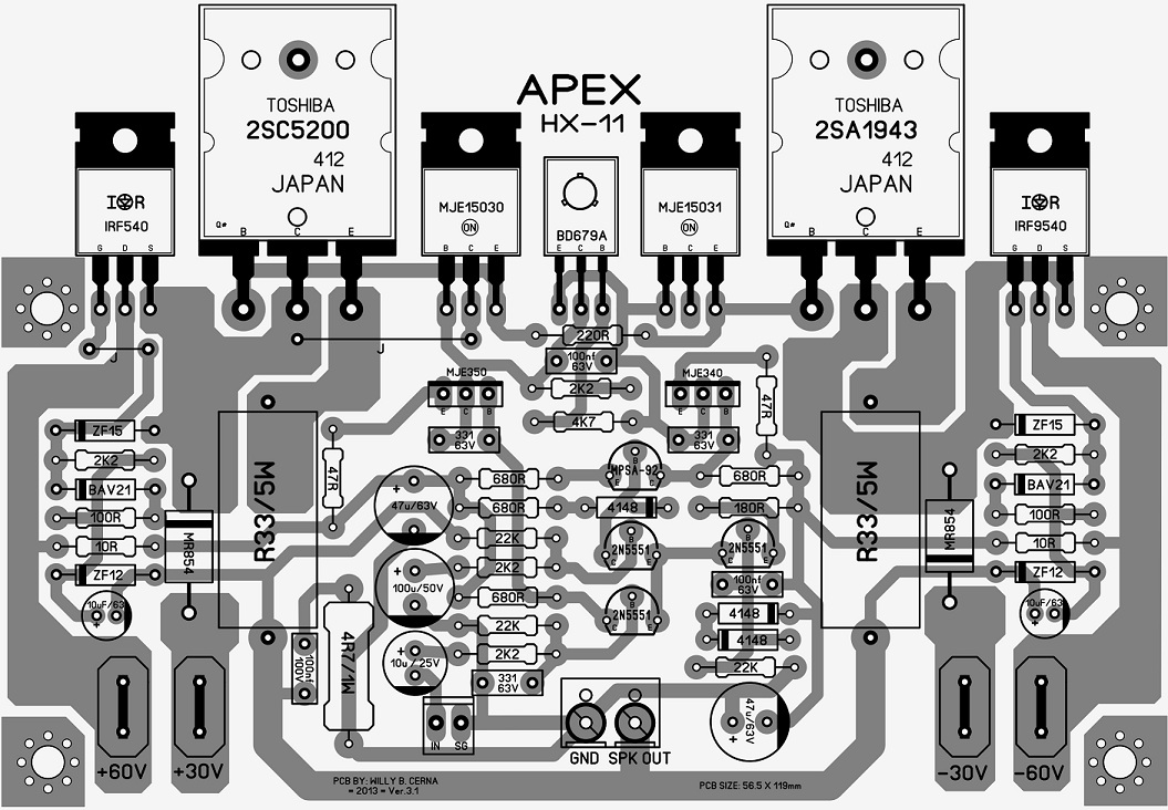

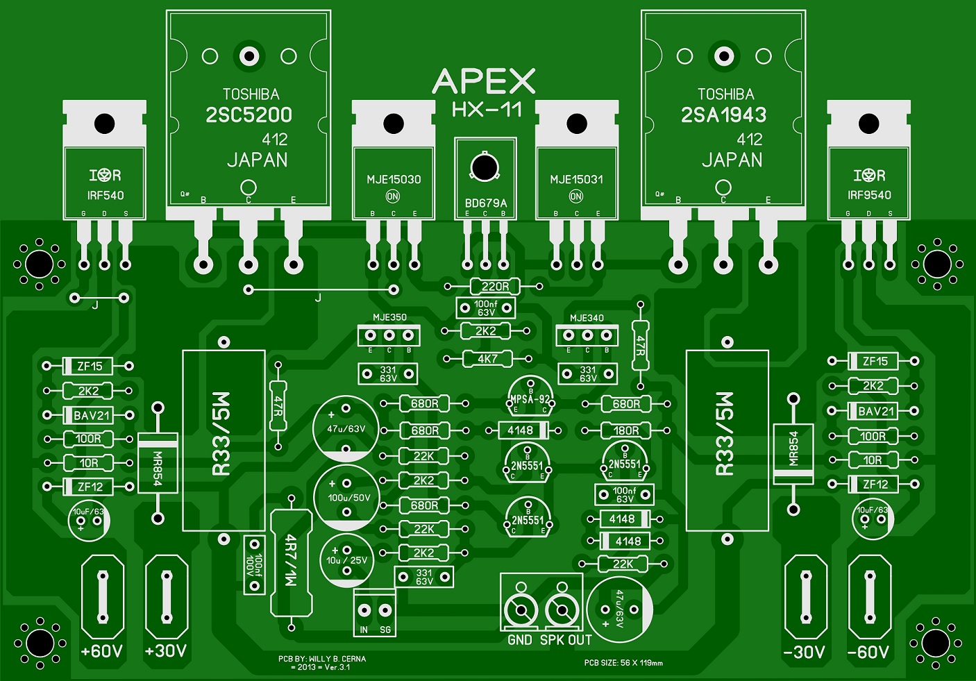

Here's the file for APEX HX-11 Class-H Amp.

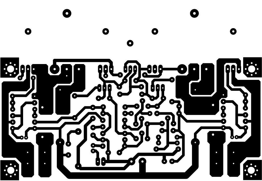

  • APEX AX-11 Ver. 3 PCB.pdf
  • APEX AX-11 Ver. 3 PCB Mirror.pdf
  • APEX AX-11 Ver. 3 Gray.pdf

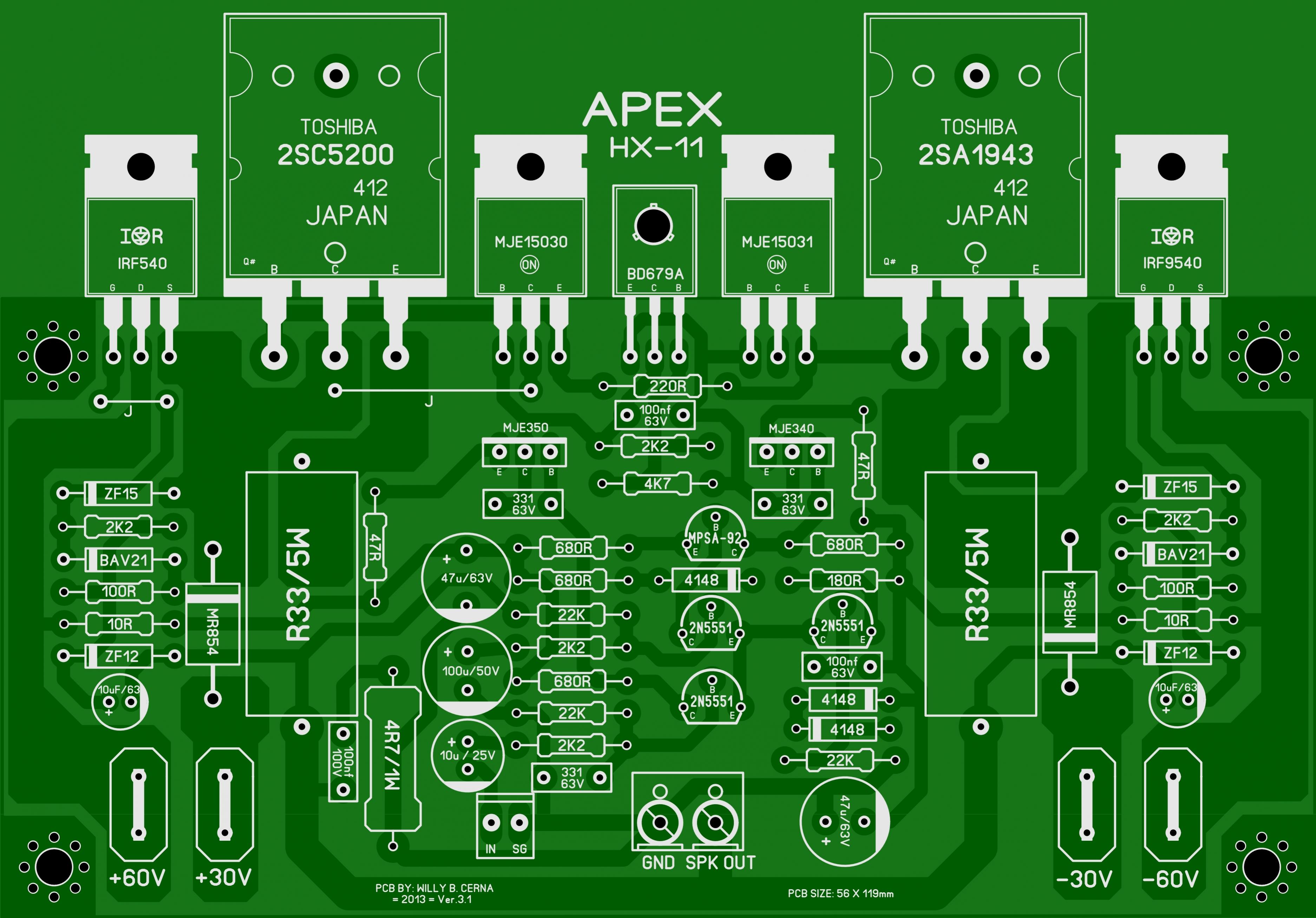

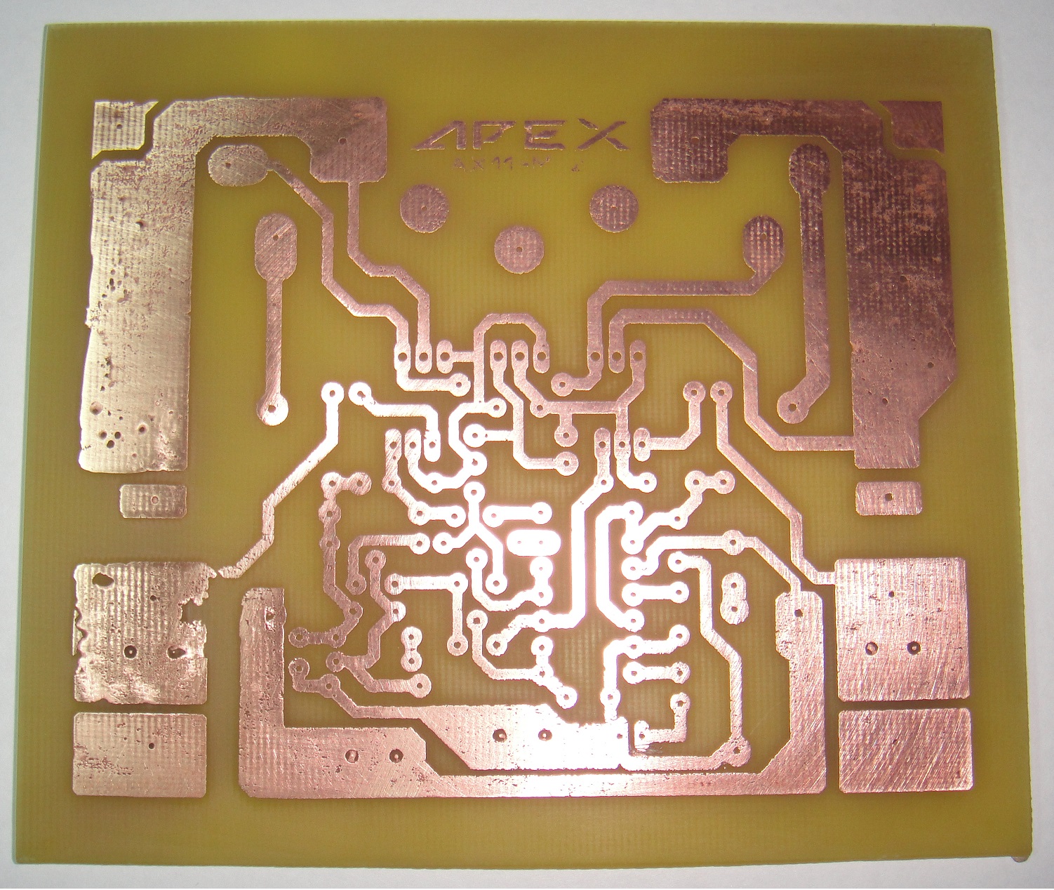

Hello guys
I did the etching last night but have some problems with the brand of photo paper I use, I have some areas of the copper where the tuner didn't get well but I wan it to try again this board can still functional only one trace need to be fix for testing purpose I'm going to use this one, and I still have 3 more to go maybe if I change the photo paper brand I might get lucky, the fonts letters are to small so next time I will make them a bit larger so the AX-11 MKII will be more noticeable, I just want it to be honest I'm not so good at this thermal transfer, I might try later in the future photosensitive boards to see how they work, well here is my "almost alright board :rolleyes:.
Regards
Vargas

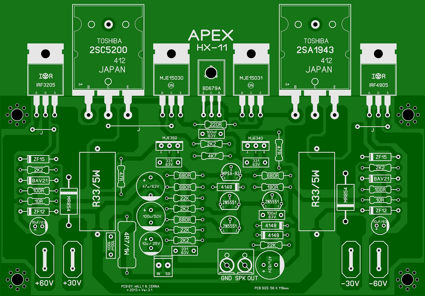

To all diy friends,
Please disregard post# 2276, today i found 1 open track on C pin of MJE15031, will have to correct that error tonight and repost the file again.
If anyone found some error please let me know so i can correct accordingly....
Thanks...
