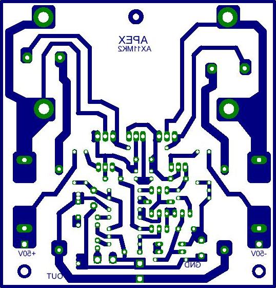

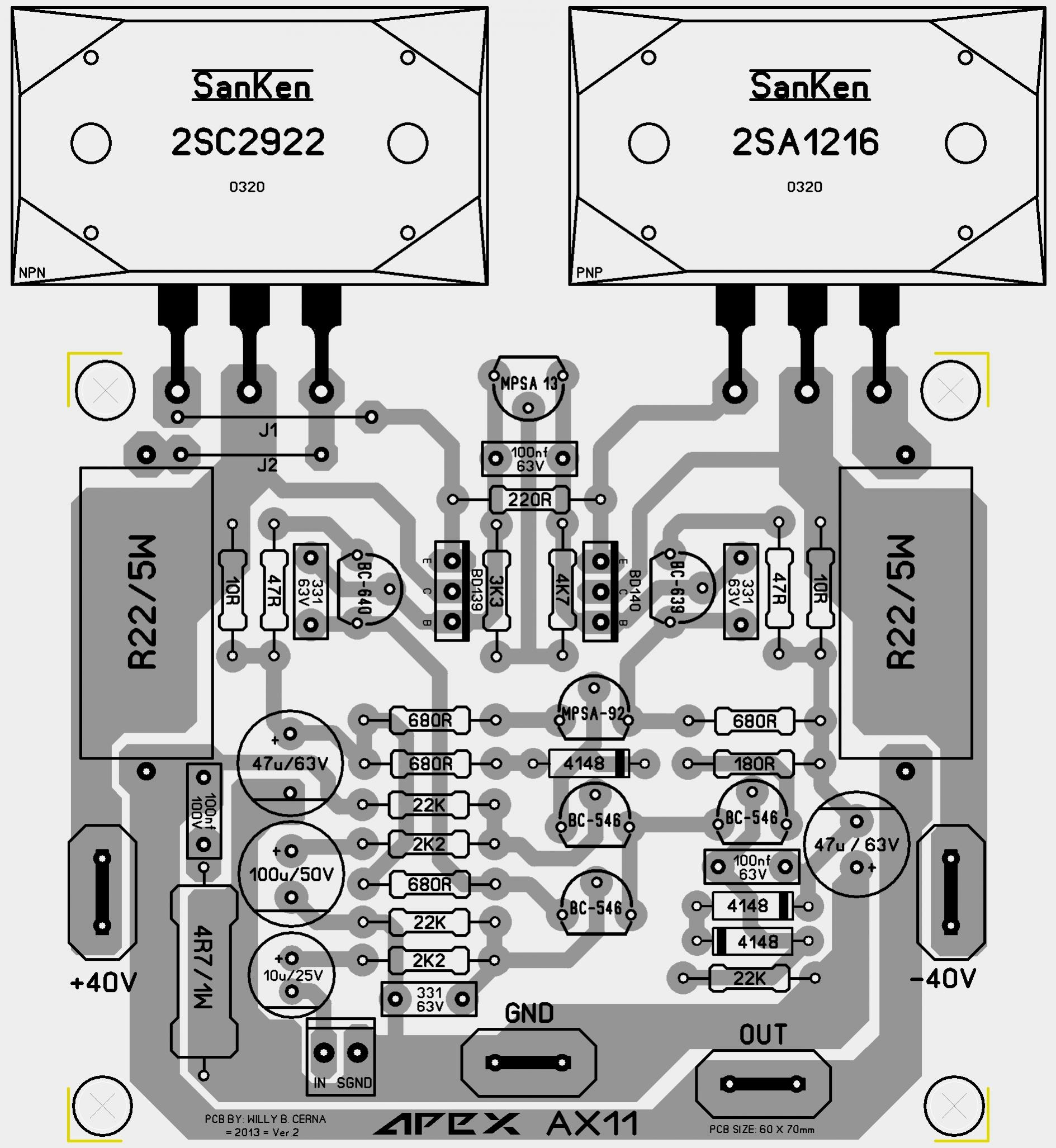

My TO3 version of AX11 for more power.
Used BD679A instead of MPSA13
MJE15030/15031 instead of BD139/140
MJE340/350 instead of BC639/640
MJ15003/15004 instead of BD249/250
Also you need 2N5551 or 2sc2240 instead of BC546, if you use higher voltage.

Part list:
1. MJ15003 – 1 pc.
2. MJ15004 – 1 pc.
3. MJE15030 – 1 pc.
4. MJE15031 – 1 pc.
5. MJE340– 1 pc.
6. MJE350 – 1 pc.
7. BD679A – 1 pc.
8. MPSA92 ( replacements 2N5401,BF421,2N5416) – 1 pc.
9. BC546 ( replacements 2N5551) – 3 pcs.
1. R22/5W – 2 pcs.
2. 220R – 2 pc.
3. 10R – 2 pcs.
4. 100R – 2 pcs.
5. 4K7 – 1 pc.
6. 3K3 – 1 pc.
7. 680R – 4 pcs.
8. 22K – 3 pcs.
9. 2K2 – 2 pcs.
10. 4R7/1W – 1 pc.
1. 47uf/63V – 2 pcs.
2. 100uf/50V – 1 pc.
3. 10uf/25V – 1 pc.
4. 330pf/63V – 3 pcs.
5. 100nf/63V – 3 pcs.
1. 1N4148 – 3 pcs.

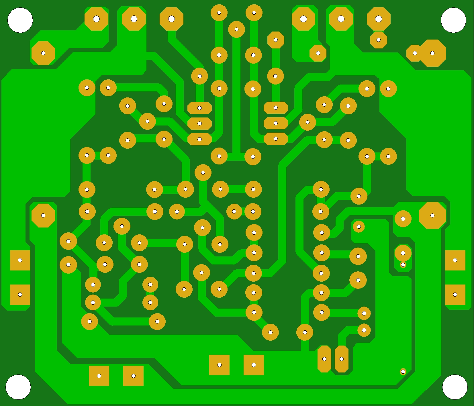

PCB dimensions 94x90mm
