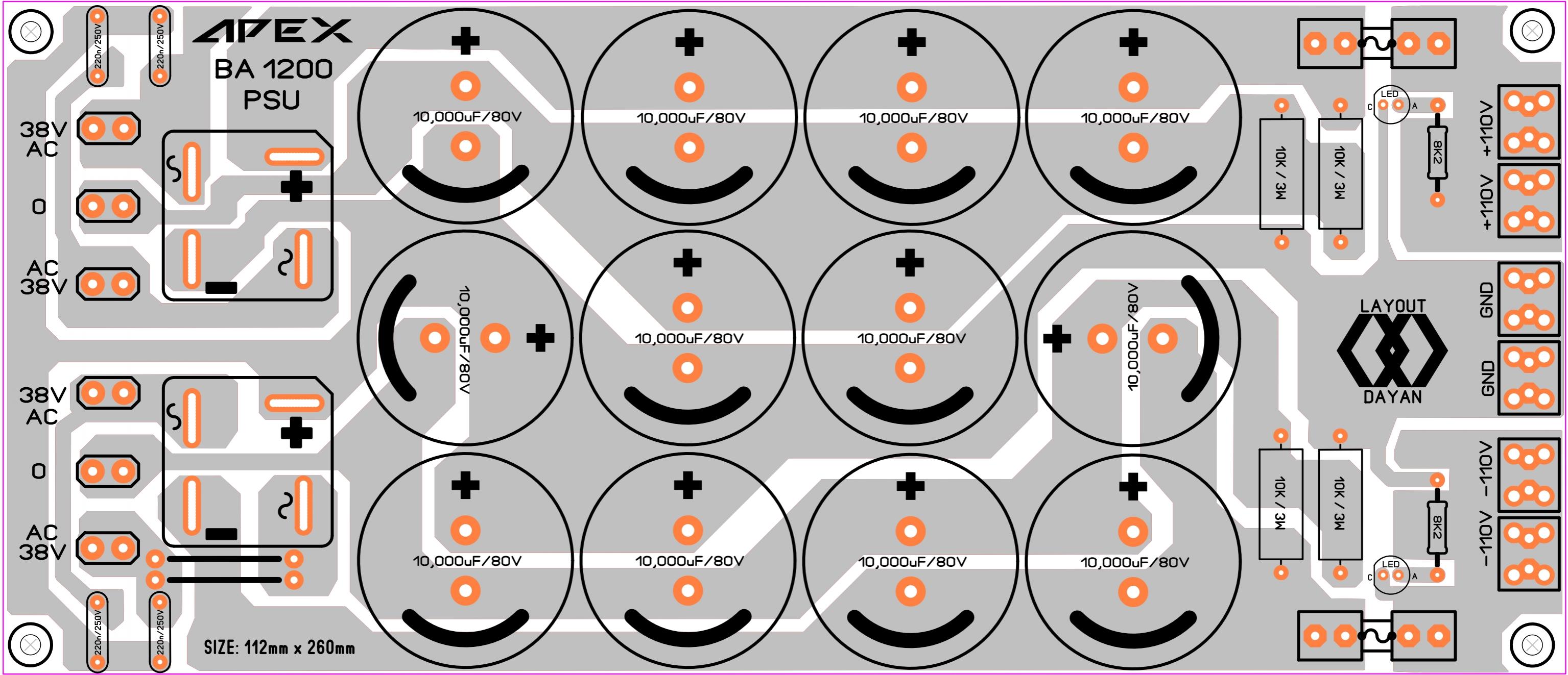

You are right sir.Look like your ground psu didn't connect tu in/out ground...
Now it is working.
You are right sir.
Now it is working.
If you use same psu with amplifier, ground will connected anyway.

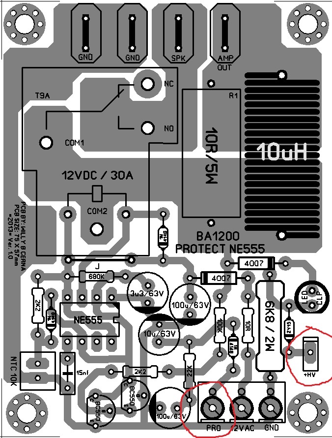

+HV=+high voltage, the + of power supply.
As it isn't a current sensor in this amplifier you must add a small circuit for bias (voltage on emitter resistors) for overcurrent detection.Output of this circuit will be the Pro.connection
You can find this add on circuit somewhere in the thread.
BA2000 pcb not tested
how much power it will give 120vdc.? 4 ohm and 2 ohm?
can u share the protection schematic on this board?

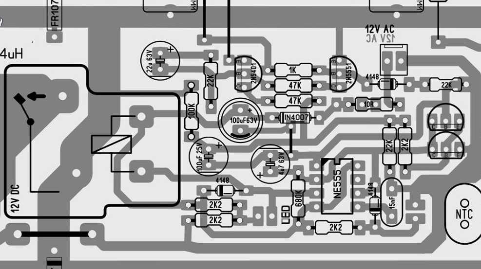

BA 2000 DRIVER BOARD.
HI MILE CAN U SHARE THE SCHEMATIC OF THIS BA2000 PROTECTION ,

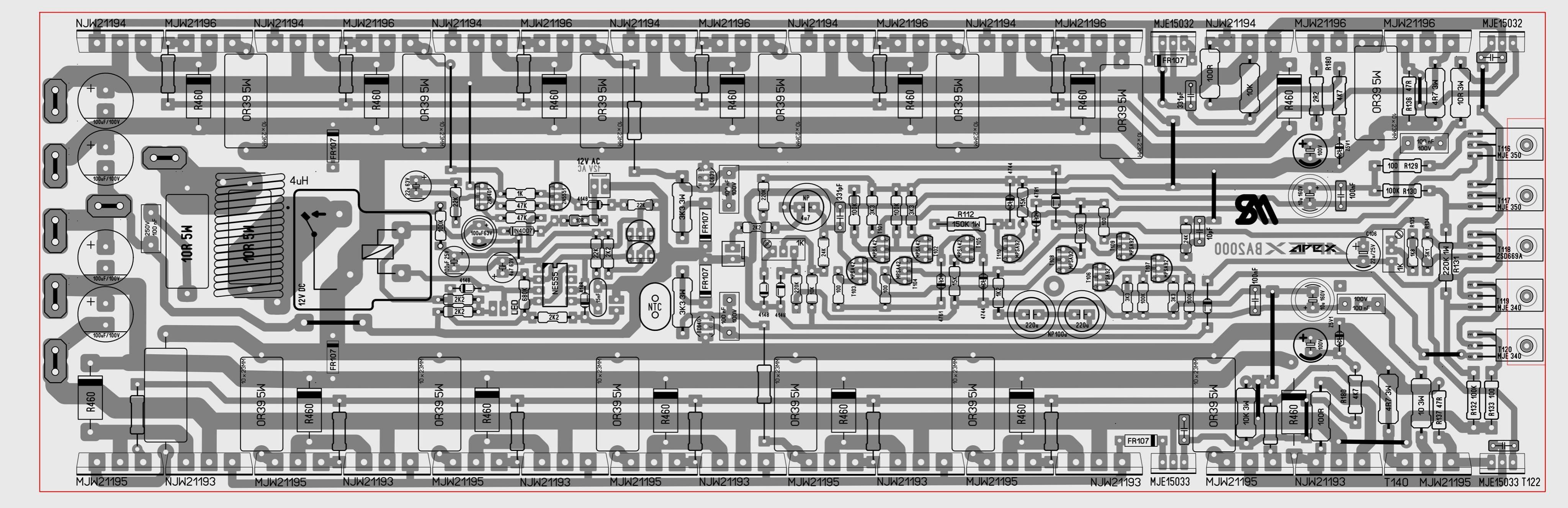

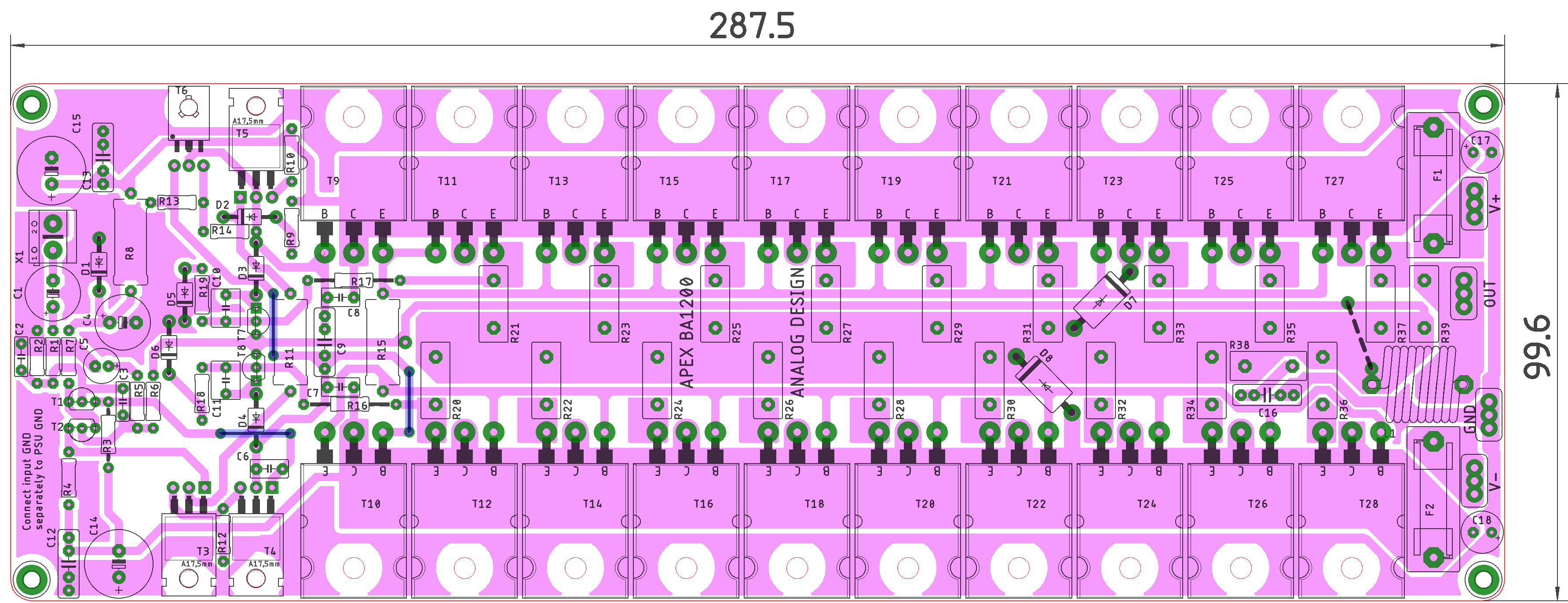

Have a gerber file. . Thank u . . .ba1200 driver board
hi apex sir,
ba1200 driver board. tested.

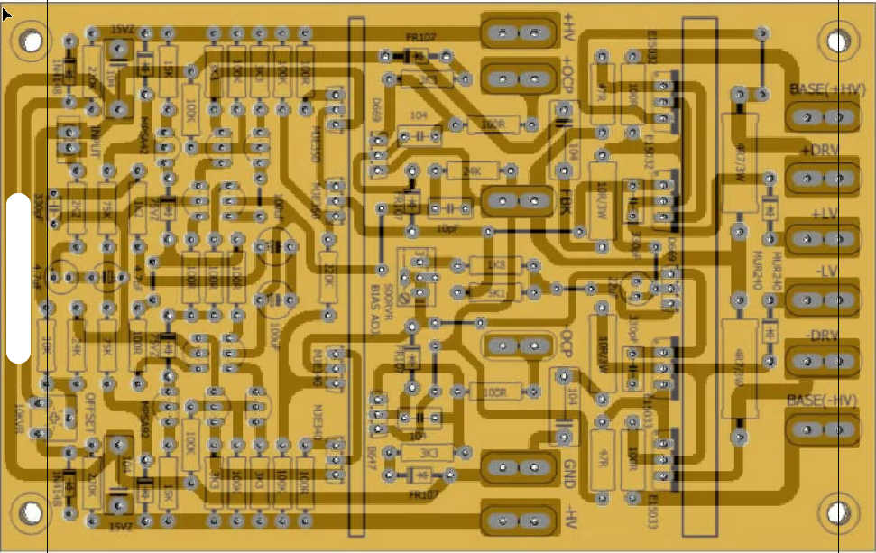

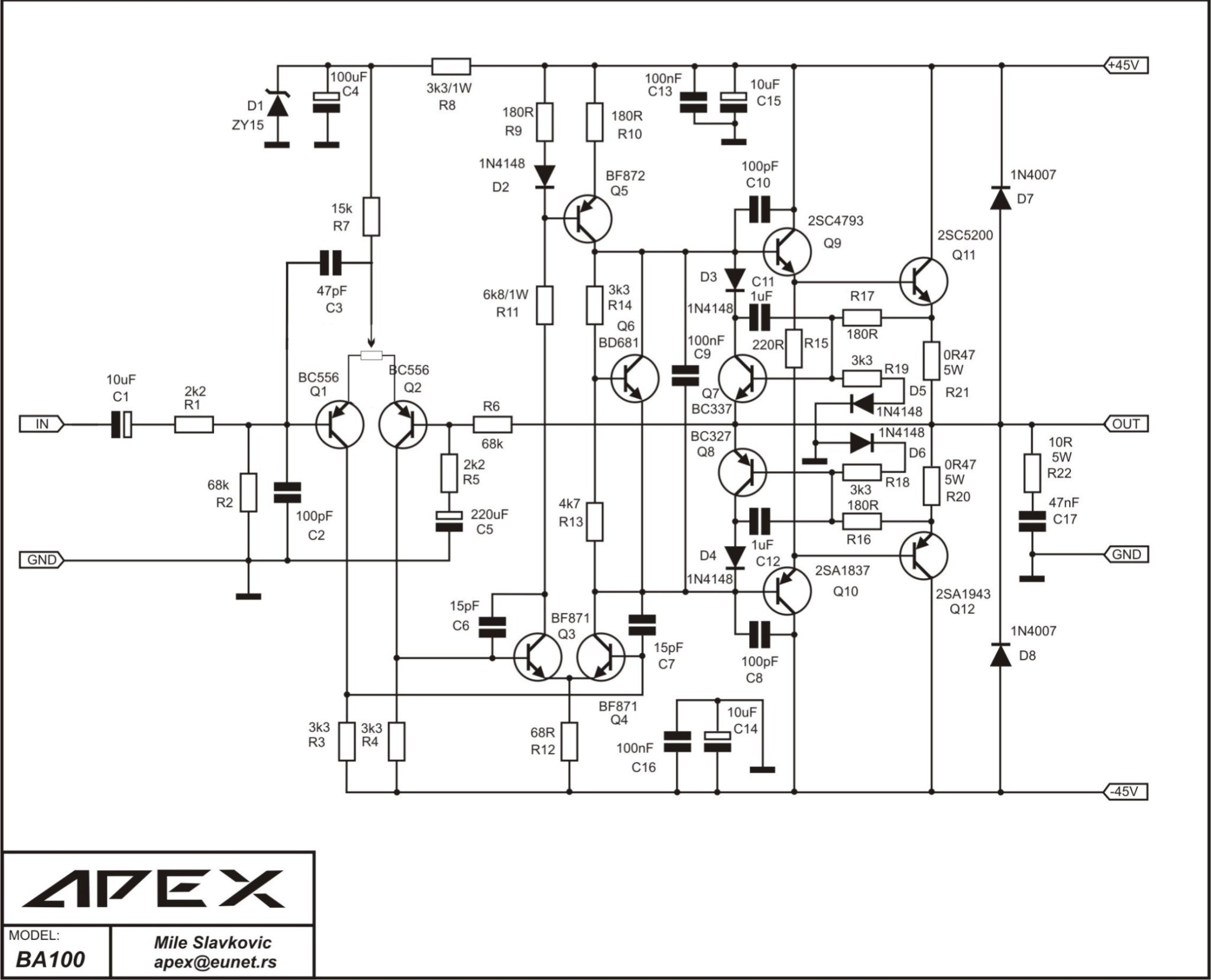

Hello Mr. Miles , if I add DC offset trimpot just like in this pic, is that ok. Please reply.BA100
Low power version for fun.
not Apex, but connecting a trimpot like that is scary, if something happens to the contacts, then you have problems, there is a better way to do that, the idea is good in general, you may also want to match the differential pair for vbe and hFE at operating current...
