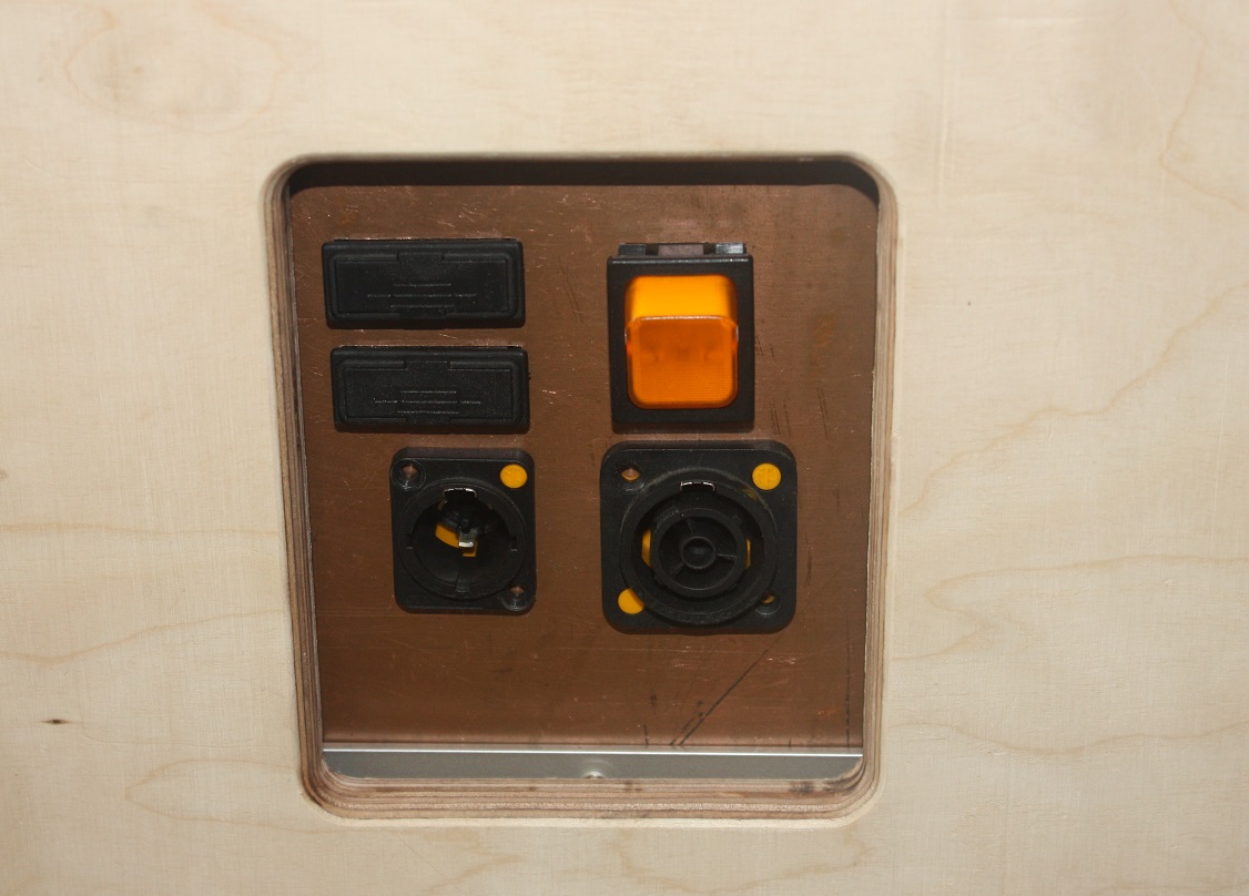

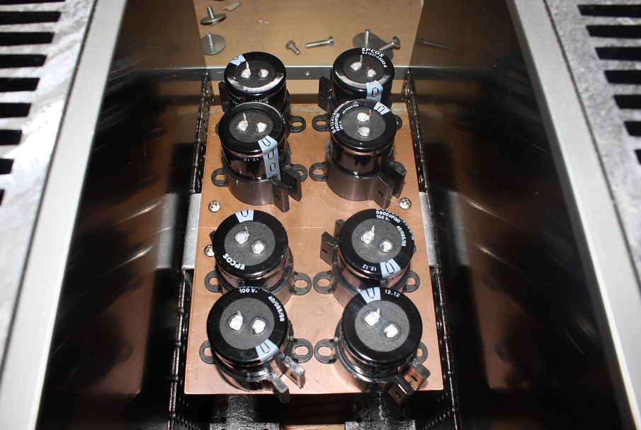

'back' and 'front' mounted, and ready for the connectors

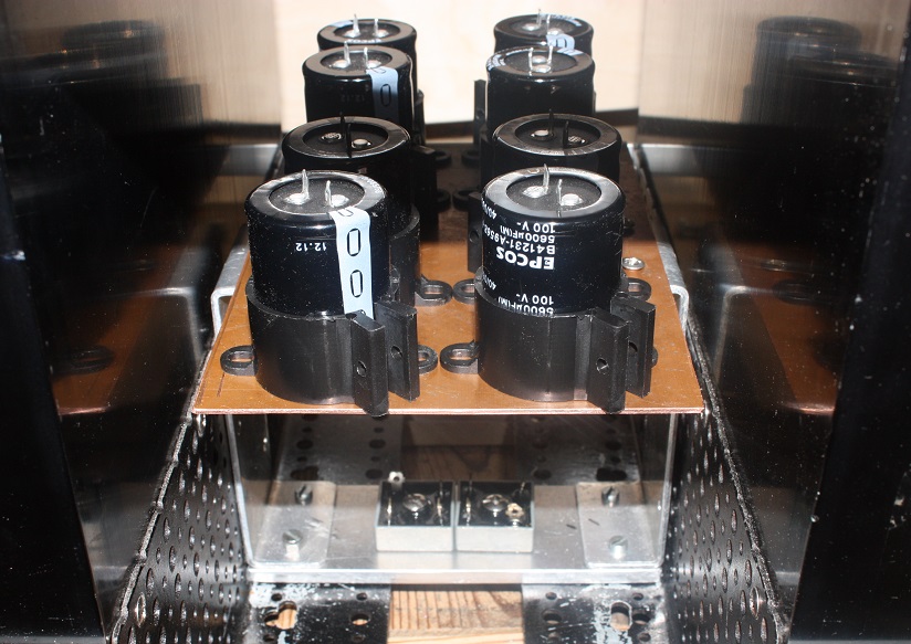

and sidewiev of inside layout

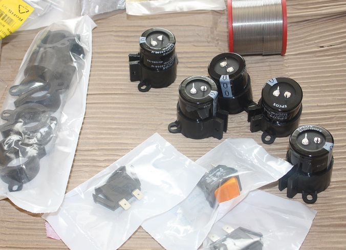

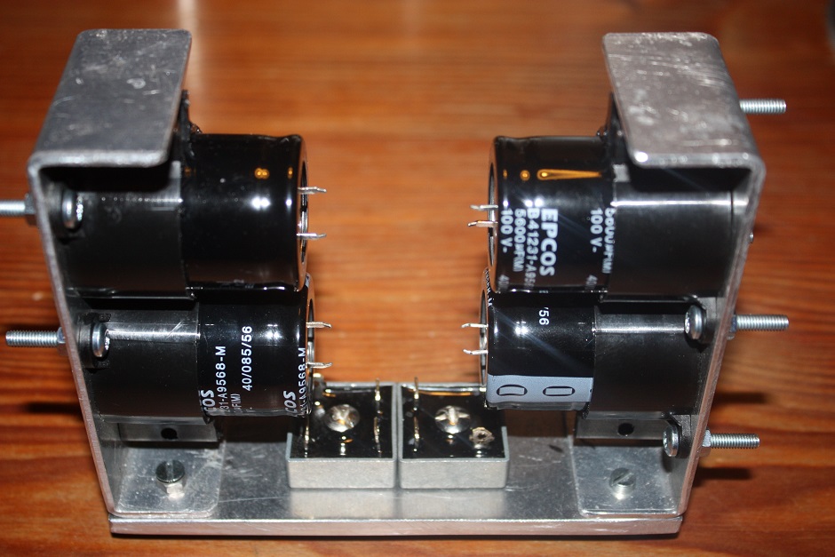

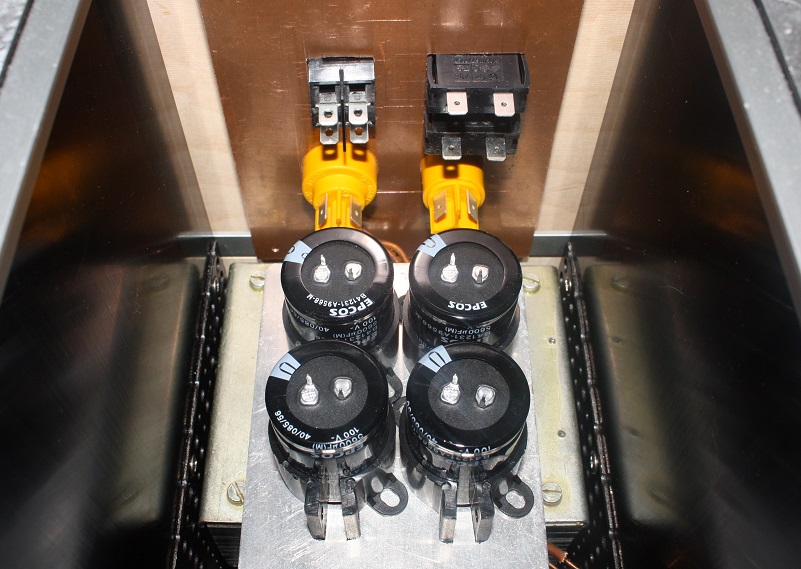

supply caps will carry the main amp board
(in total,12x 5600uf/100V/6A, 35x45mm)

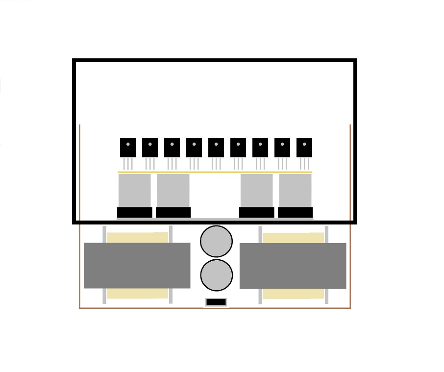

The sinks will dissipate more heat, or run the Output Devices cooler if you can get the Outputs lower down.
yes, I know
output will be mounted just below middle of the 200mm heatsink (height)
remember, trafos are actually below the heatsinks
supply caps carrying the main board basicly stand on top of the trafos
and caps are 45mm
I want easy access to mounting screws on output devices
and I need to do some hardwire mounting on outputs
I just have to put my faith in those big heatsinks
and that the convection system actually works
and hey, remember, both heatsink are for one mono channel
(NPN on one heatsink, and PNP on the opposite)

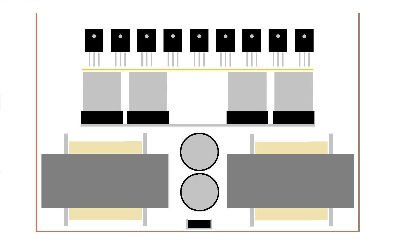

edit, since my sidewiev could appear confusing, I have attached a smaller drawing, showing heatsink also
well....that depends on a number of things
the way I do it, the devices are not more seperated more than in any other designs of this size, if you look at the whole picture, from one end to the other
largest distance from ANY component to middle of amp will be about 100mm
its basicly like one big IC

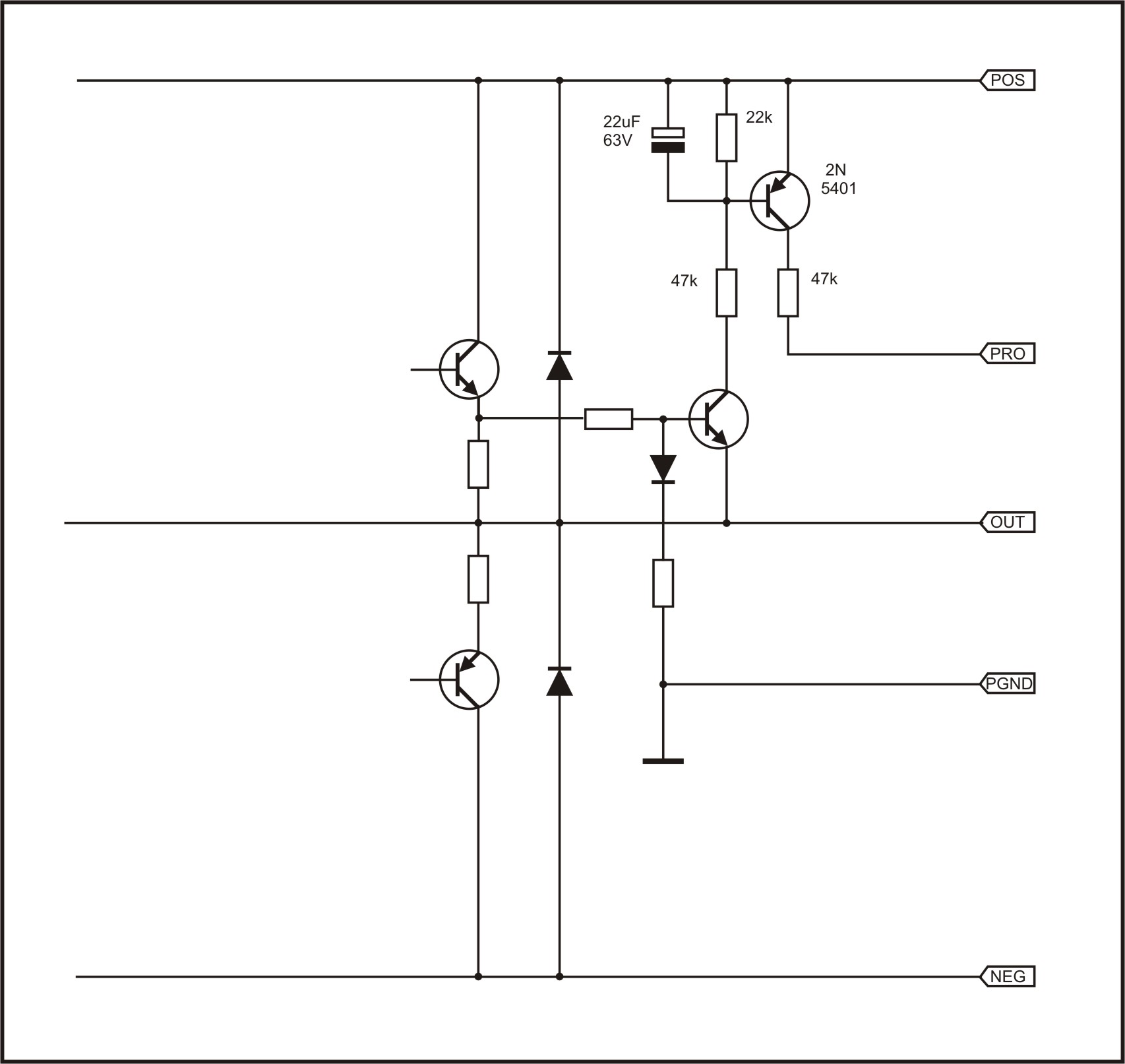

Overload current detect can be add to any amp to activate PRO input on NE555 protect.
how its fit to any amp with diferrent supply and output transistor type.....any advice for the value of component that not present on the schematic?
best regard,
read Cordell.
He suggests that N & P should not be separated.
He goes further, suggesting alternating N&P, such that the N to P leads are very close together for more effective canceling of radiated fields.
i am more of a Leach fan, followed their debate in the
Audio magazine years ago...
