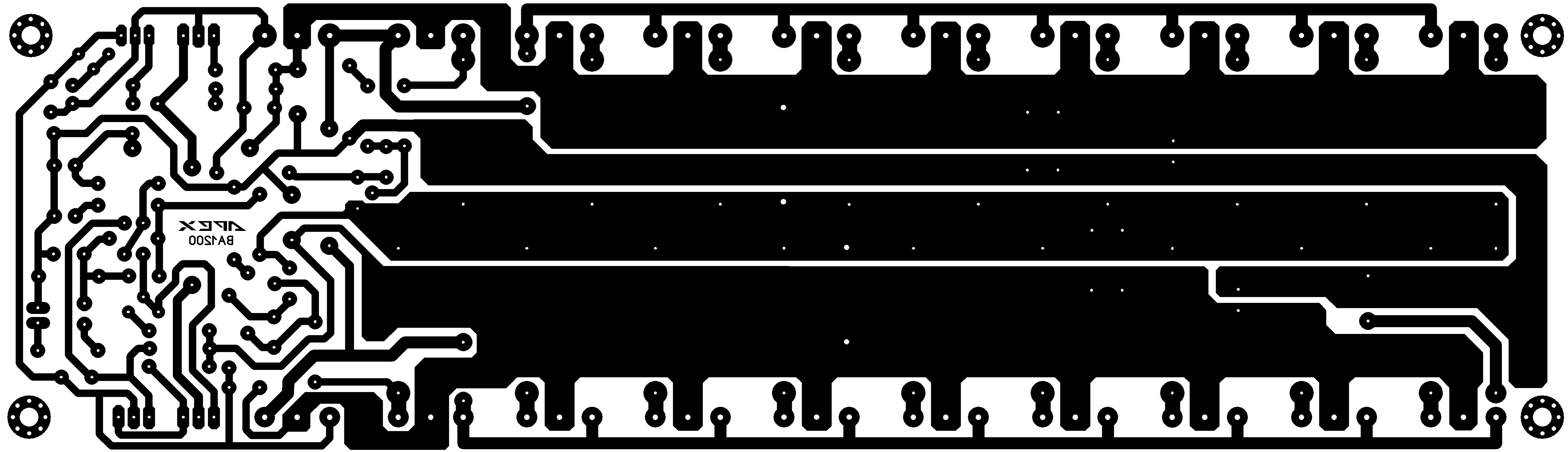

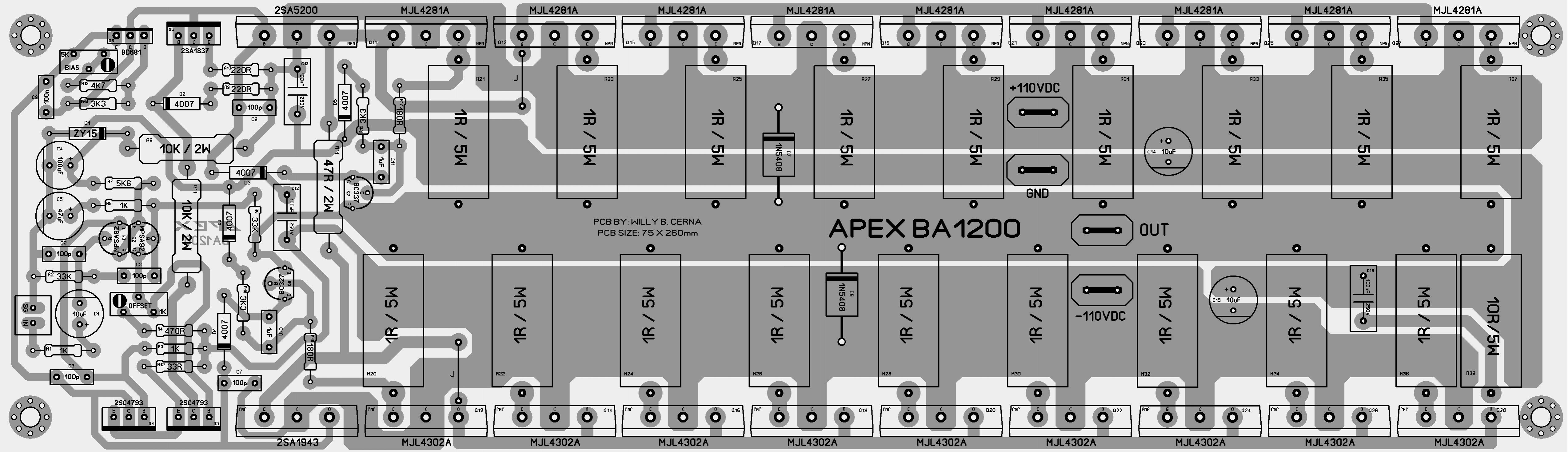

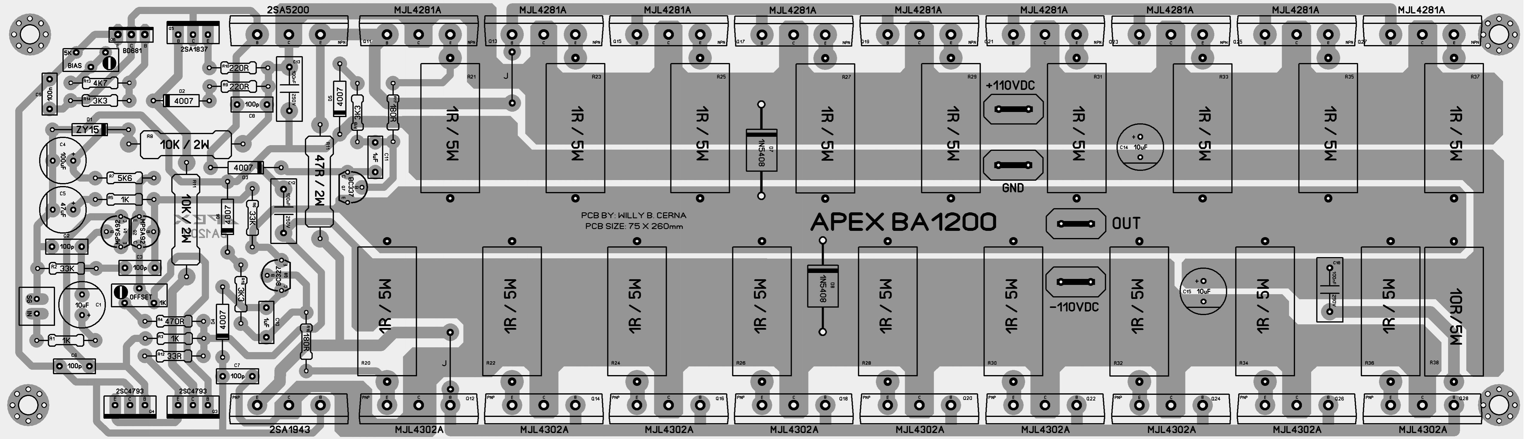

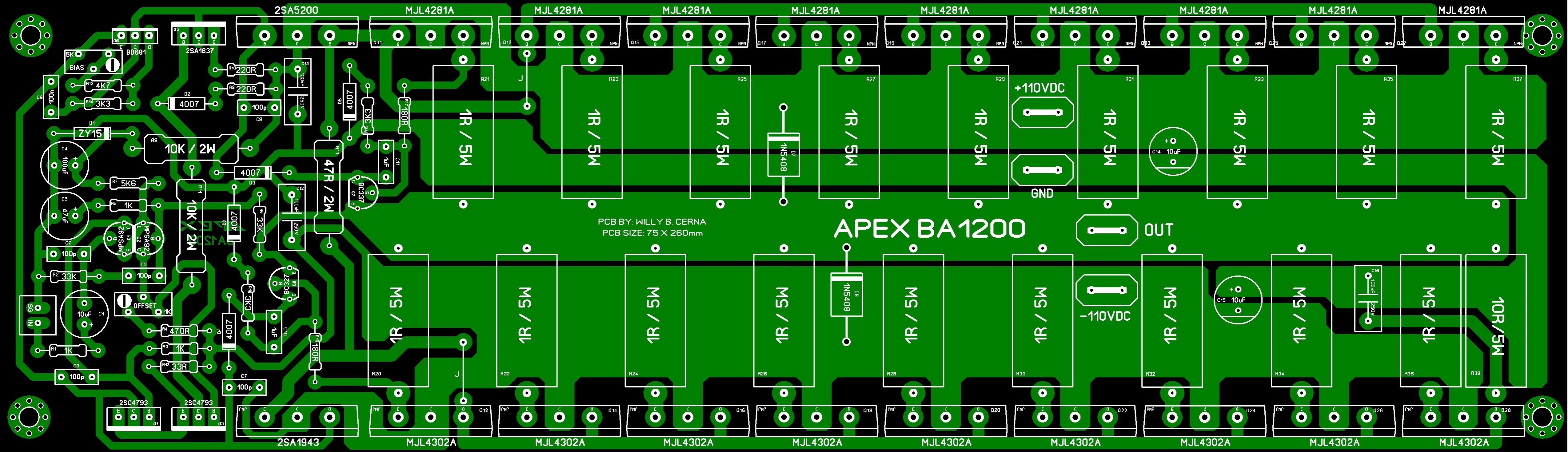

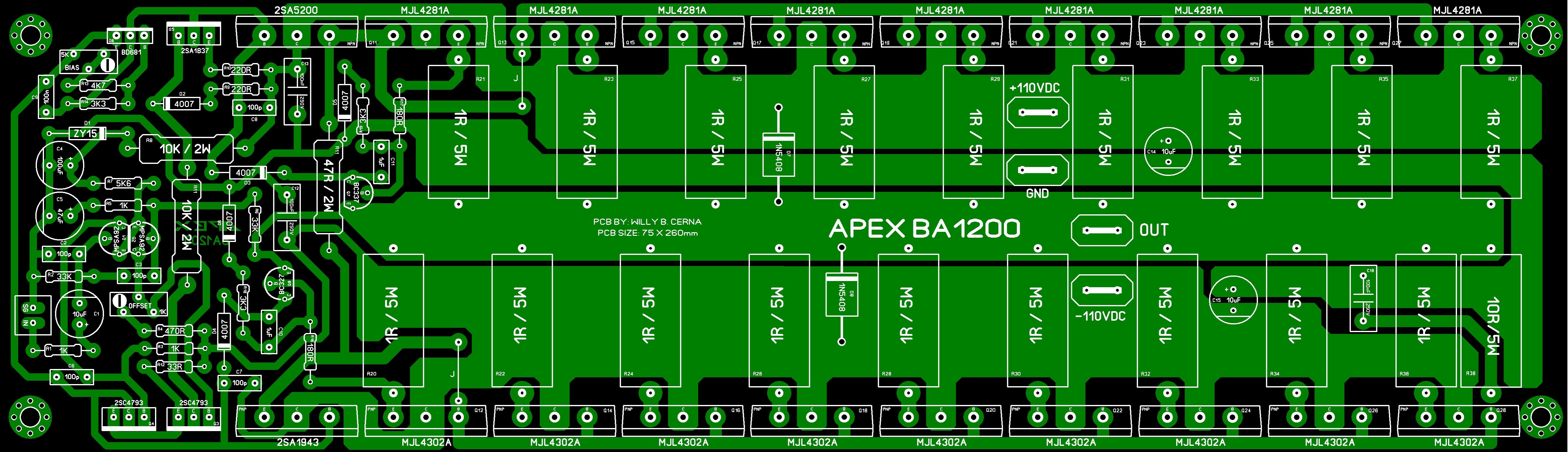

hi apex, thank u for the such a high power class ab amp for diy.
hi willjj78 well done for the pcb design, good job.
can u share the top layer of this in pdf.
which software u use to design this pcb?
Thanks Nazir...I'm using Sprint Layout 5, here's the file.
  • APEX BA1200 Silk Screen.pdf
  • APEX BA1200 PCB.pdf
  • APEX BA1200 Component Guide.pdf

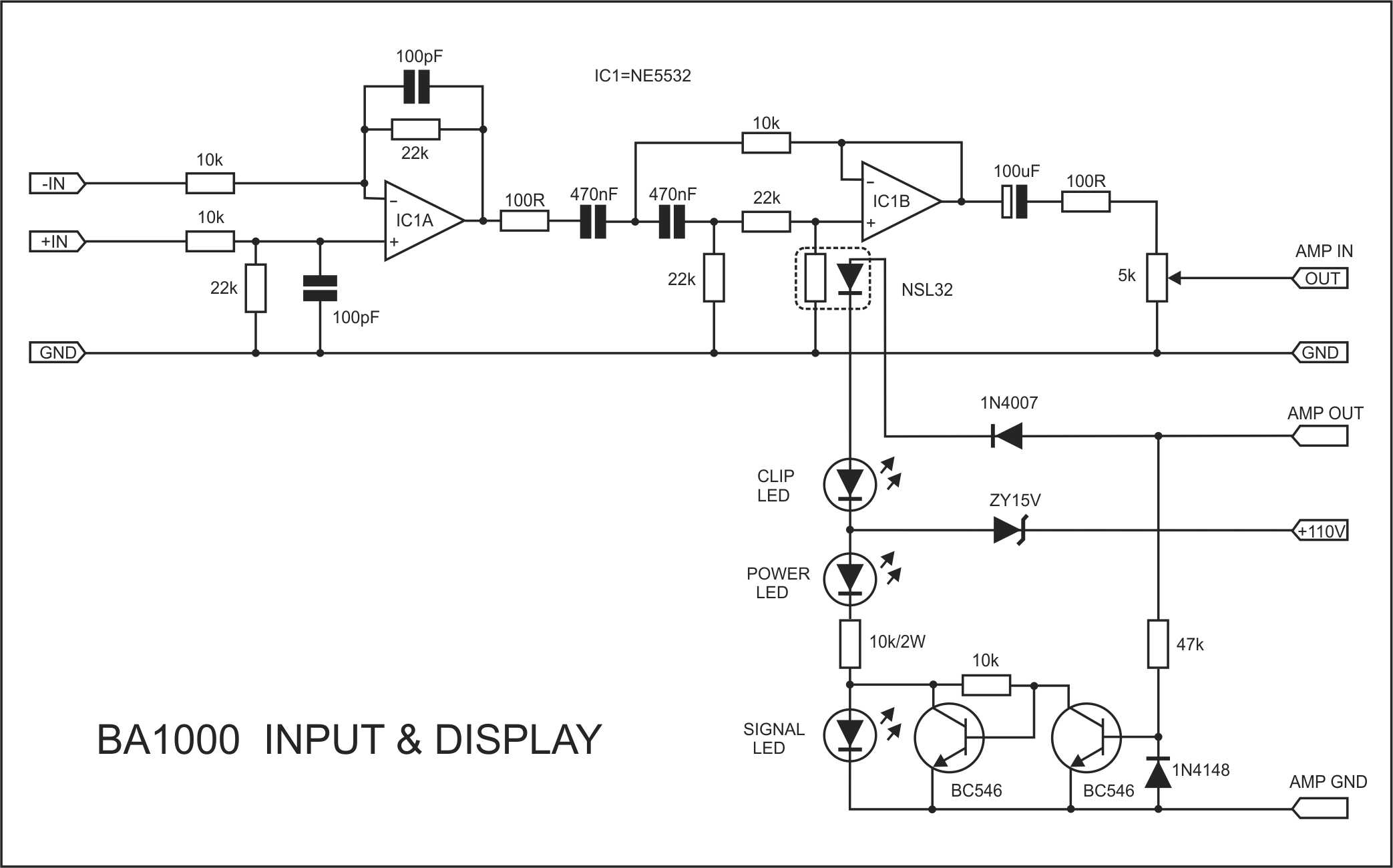

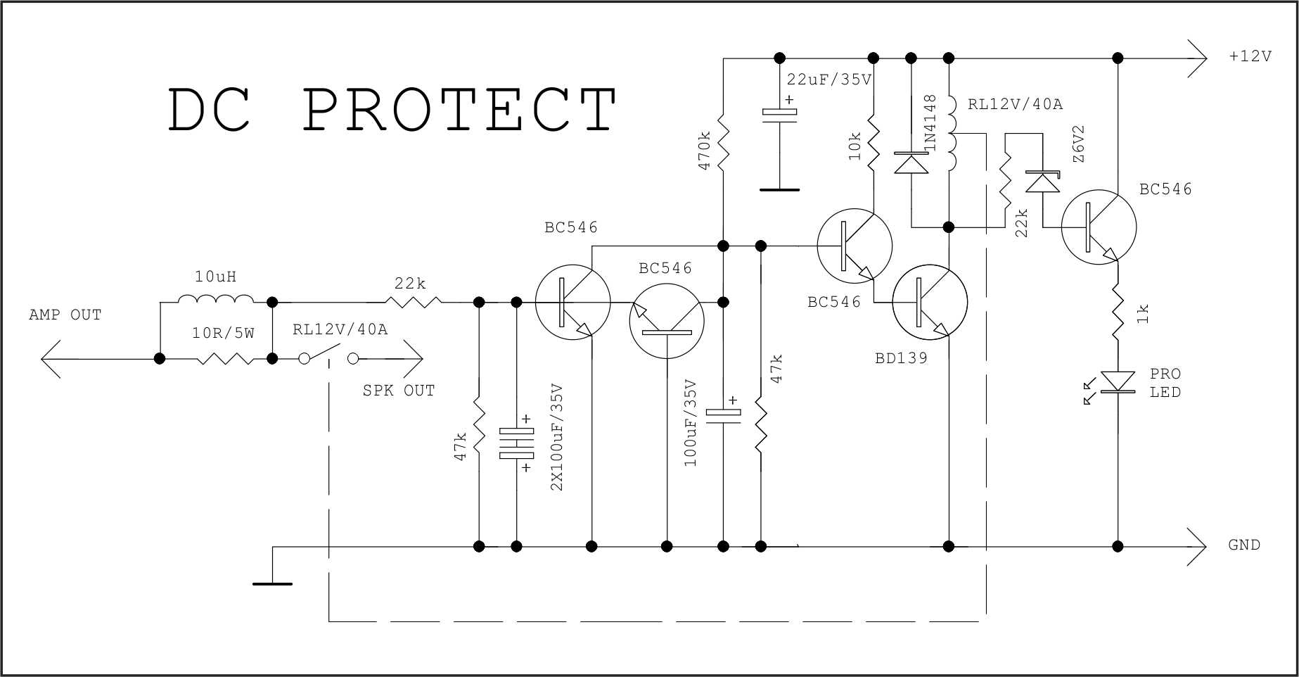

Apex, post181.
The relay driver should be saturated to operate properly as a switch.
It is normal to use a sat hFE of around 10 for this duty.
I would aim for a base current coming from the EF of around 4mA, for a 40mA relay coil.
The 10k in the collector of the EF is far too high.

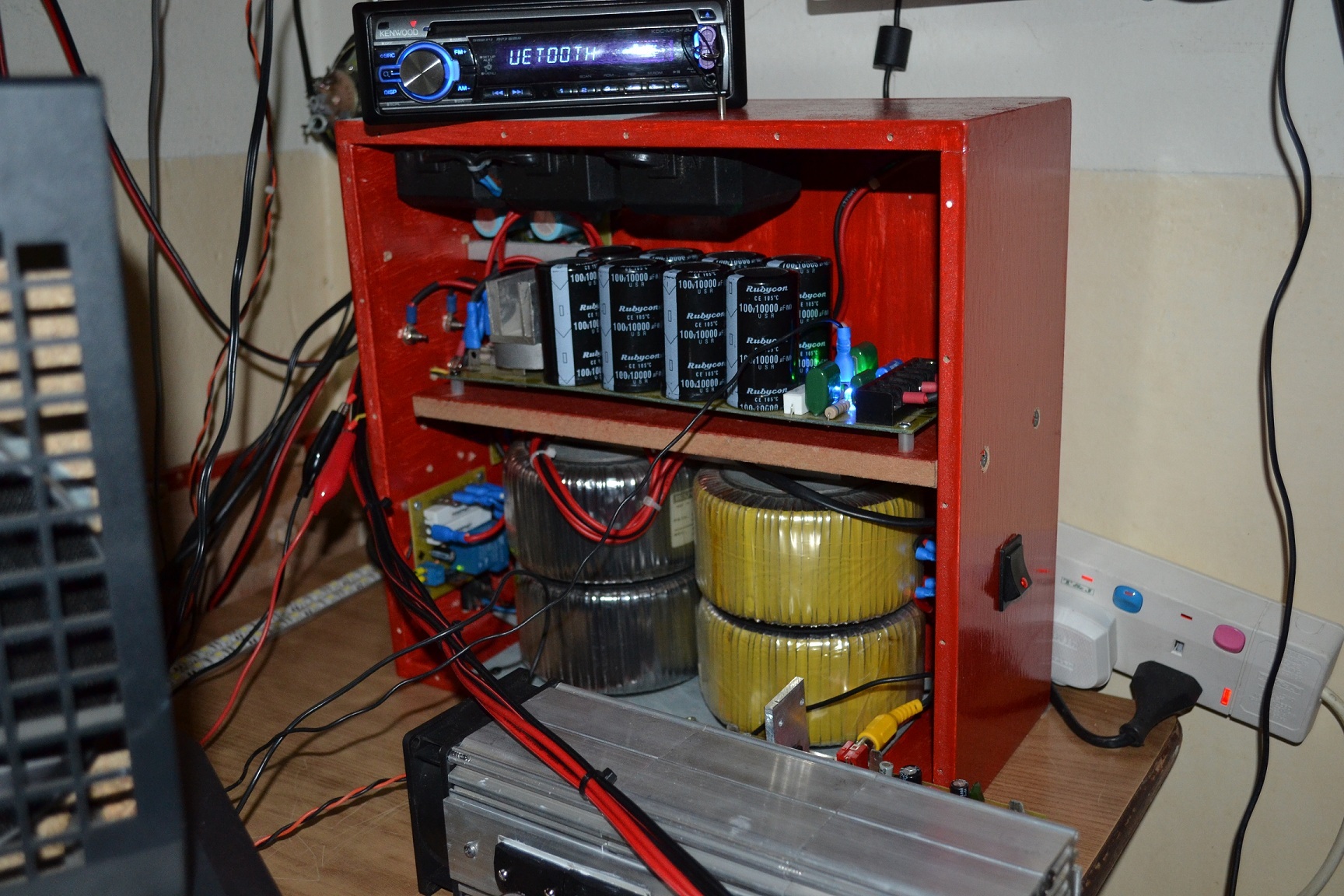

does any of you have experience with connecting two trafos in series ?
thought I could use one trafo for each rail ?
they are older IE core trafos with 3x 33V
supply caps would be 100V types
That's possible... I even did it with 6 toroids in series with 29vac each..
See photo 4 of them in series...
