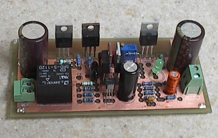

I have etched and stuffed the new board. Hopefully, this time it runs stable. I feel more confident about it this time (spider sense is tingling).
MJL21193 said:
Hi Glen,
I tried 100 ohm degeneration resistors first, then 220 ohm. The 220 ohm made a slight difference, and told me my suspicions (about the OL gain) were correct. Pulling the mirror - further tiny increase in stability, but when I pulled the EF, that made the real difference.
I knew the EF acts as a buffer for the Cob of the VAS, but I considered the options: This amp MUST run stable, it can't be prone to oscillation, there's too much power involved. I don't want a Chernobyl on my hands.
Besides, this is a temporary fix, I have some better high voltage VAS drivers on order: 2SA0914. These have a low Cob (5pF).
I will use the MJE for debugging until I get these.
OK, the new board is looking good and has a very good probability of sucess
It is a pity that you didn't have the better transistors at hand for the VAS though, as the previous version may (and should) have been stable with them.
A big trannie like the MJE150XX for a VAS is waayyyy too slow in this position and it adds too much phase shift to the loop.
If you combine this with a huge output stage that adds a big capacitive load to the drivers, the overall phase shift could conceivably become difficult to manage.
That might be why you didn't get away with it this time.

Hi Greg,
How do you like my new distraction? Cheaper than even the cheapest women.
I simmed it both ways, with or without R2, and didn't find a significant difference. I'm seeing 0.088% THD at 493 watts into 4 ohm at 30Hz, which is better than adequate for this amp. I really haven't been paying much attention to the THD of this amp, as it's not as important as stability (I think).
Now, as for the values, I don't know if they are optimal. Wg-ski above, suggested the drop across these is too high at ~750mV, but again I defer to the sim and it shows the output will stick to the negative rail at any value less than 470 ohms. Erring on the side of caution, I look at Rod's P68 again and see he has used 560 ohms here.
I have the board ready to run, just need to drill some new holes in the heatsink to mount it. I'll then take it for a test drive.
One thing that concerns me, and that I really should have addressed earlier, is that the Vbe transistor will monitor temperature on one side of the heatsink only. Maybe a bit over cautious, but maybe I should rig a diode string to "watch" the other side too?

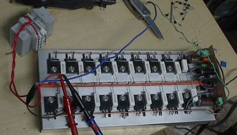

Ok, I have it running. At the +/-35V supply it's running rock steady. No sign of oscillation. This time around, I got the bias generator pretty much dead on - with the pot in the centre, I have ~20mV across the emitter resistors.
Running on this supply, I have connected my 8 ohm dummy load (the bundle of cement resistors with heatsinks on the side in the picture below). Some observations:
Output before clipping: 25.6Vpeak (18.1Vrms) into the 8 ohm load with rails supply sagging to +/-29VDC. This ~41 watts output.
Heatsink temp: An even 40*C all over in the position as shown in the picture below - fins down, no air circulation.
VAS and CCS temp: 56*C with no heatsink on either. Temp taken at the back centre of the package.
Dummy load temp: 110*C at the centre plate between the two rows of resistors. Heating the room, that is.
It somehow slipped my mind that the 2SA1011 is a 160V device and would make a more suitable VAS. Still not ideal, but better than the MJE15031. I do the exchange and fire up the amp again. There isn't a noticeable difference in the sine wave output, but the squarewave is a little sharper, especially negative going.
The problem is with the clipping behavior, With the MJE, clipping was very clean, a little jittery on the negative going wave, but very clean overall.
The 2SA1011 on the other hand is terrible - really harsh clipping. So bad it makes the bias LED blink. Not only that, but when the signal is taken away, I have 10VDC on the output. This is only with no signal. With signal, the DC at the output is <2mV.
Although I used this for the VAS in the Patchwork project, I never could properly sim this transistor, as there's no model (that I can find) for it. In that case, I used another modified model from a device that had similar specs (can't remember the specific one).
So, what's going on?

Would increasing the Miller cap defeat the purpose of the low Cob VAS?
Could the clipping problem be attributed to the low rail voltage and current availability, since this output stage does have a big demand?
Clipping behavior aside, the most pressing problem I have now is the appearance of DC at the output when the signal is taken away. If I turn off the FG without unplugging the input cable to the amp it's fine, normal DC offset. But if I unplug the cable, I have 10-20VDC at the output. What is the problem here?
i think the capacitance of the VAS changes as Vce changes.
A low capacitance transistor//ideal cap is better than a high capacitance transistor.
I would go further and remove the 1011 which is a driver type and substitute a true low capacitance transistor for the VAS. Then EF it to generate the current required for the next stage.
Project Stability!!!
With all our help here, we can help get this man's amp stable!
Question......
Why would an TO-220 MJE-based VAS be too slow? 30 or 35Mhz transistors??? Rod uses them in his amps just fine, and I've used them myself because they run cooler than TO-126 at high voltages.
I used MJE 15035 on a heatsink for a 17mA VAS to drive a CFP and it works fine, and since it has a good power rating, and a heatsink with no insulator, and it doesn't get hot, just slightly warm @ +/-75V
Although, my design just used only one driver pair to drive 5 pairs of MJL4281/4302.
*Now I notice your zobel of 0.1uf/4.7. Have you tried 0.22uf? I had slight stability issues myself with that zobel until going to a 0.22uf cap instead. Maybe even try 0.47? Also, since you have 8 output pairs, multiple drivers, and a large output stage. I would assume a better zobel would keep it under control better.
I doubt it would hurt, because any treble within the zobels range just dissipates as heat in the 4.7resistor anyway, just use a large zobel resistor just in case, and also this is a BASS amp, so HF performance isn't critical, but keeping out the HF noise IS.
I was comparing your design to Rod's P3A and P68.........
Rod's design in BOTH P3A and P68 use a 100pf cap on the b-e junction of the drivers. Your amp has no such compensation. I did this myself but used 1000pf (102) and it worked fine, even plays great with treble under testing. You may want to try this to improve stability.
Also, have you tried smaller than 500K for an input resistor? Maybe 100K or 47K instead? You did mention your amp has DC offset with NO input( or open input with nothing plugged in). Have you also tried grounding the input cap for troubleshooting to see if that offset goes away? Most amps I know make some noise with nothing on the input, or if you touch the input wire with your fingers with nothing connected
