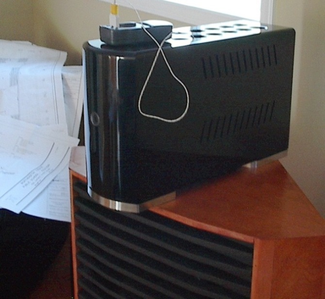

Yes, the idea is to have this run as silent as possible. You need to remember that I am counting on getting a lot of cooling from the chimney pipes that are in the case. These will "suck" hot air from the heatsink and pump it up through the pipes. This can be as effective as fan cooling. In the meantime, I have the two front fans installed for backup. These will kick in when the temp goes up.
The single fan at the bottom of the case, near the front end amp board will be running constantly, mainly to keep air circulation around this circuit board. I have connected that using a dropping resistor to have it run at 6VDC. At this speed, it is nearly impossible to hear, even with the case cover off.
While I had it on my bench, I checked the power supply sag under load. No load voltage on the rails was 71.5VDC. This dropped to 67VDC driving the 8 ohm load to clipping. This is about what I expected from this power supply.
I have slipped the cover on to see how hot it gets. I have only had a chance to see it at idle (will do some demanding test today). I see the chimneys appear to be working. Heatsink temp in open air before putting the cover on was ~40*c. After the cover went on this climbed to 43*c. I could feel the heat coming out of the pipes. I held a small slip of paper above and there is some good air movement. I'll run it hard later to give it a real test.

Wait, wait, what you're saying ... is that after you putted the cover on the temp rised by 3 degrees, and you say that the chimneys work ?? Isn't the temperature supposed to be lower maybe... ? :rolleyes:

The chimneys work better as the temp goes up. More temp = more convection = more cooling. Imagine the temp inside a wooden case with this much heat production.:hot:
If I can keep the temp below 60*c on the centre of the heatsink during intense use, I'll be satisfied. I'll make that the threshold for fan operation.
Anyway, I'm monitoring it now. I have played a few bass heavy tunes and see the temp at 47*c. Now playing "The Island". Lotsa explosions, rumbling and such to give it a thorough workout.
Loud yes, noisy with fans running NO! I hate fans, but they are a necessary evil. Last thing I need to hear during the quite scenes are a couple of jet engines roaring.:down:

It didn't get that hot. Even after an hour and a half of nearly non stop high volume bass, 57*c was the hottest it got. This was measured near the middle of the heatsink with the probe touching the thick part. I also measured the air temperature at the exit of the chimney pipes - 41*c, so it's pretty clear they are doing what they are supposed to.
So, in the end, a bit of a waste to install fans for the amp to drive the 4 ohm load. In the future if I decide to run a lower impedance, then I'm sure they will be needed. Also, the ambient temperature here today was only ~20*c inside. During the summer it will be hotter.
Still have a few things left to do but I'll put those off until the fall maybe. Concentrate on other projects for a while.

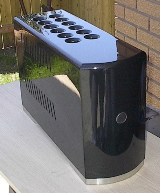

I got a decent picture today. I took it out to my shop to grind the back plate a bit so the cover would go on fully.

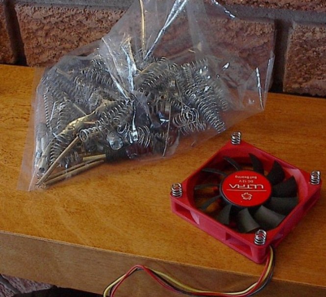

Yes fans work well as long as they and the heatsink they are cooling is clean. Anyone who has cleaned a blown heatsink (CPU cooler for example) will know what I mean.
Fans are hard to make quiet. Even if you get rid of the mechanical vibration noise, you still have the air flow noise to deal with. I solved these with the constant running fan in the amp by slowing it down and mounting it on small coil springs (see pic below).
I have christened this project "Terremoto" - Spanish for earthquake. Cheesy enough?:D

One of the ebay amps I bought has a air filter on it to clean the air.
When I bought my big heatsink it came with a mains fan and that moves a serious amount of air but as you say it is very noisy.
My other amp uses a couple of low current 12 volt DC fans and they are much quieter.

For the record, there are some ultra quiet fans offered from AKASA.
The one type it is the orange series AK-184 90mm with double ball bearings.
The second type offered up to 120mm (the larger the more quiet) with double ball bearings and a pre-installed thermistor in the output of fan thus the rotation speed it is automatically controled, depending on the temp of the outgoing air.
I've installed in my workstation PC five AK-184 fans on the side covers and two 120mm (thermistor type) on the back plate with special ruber bolts of SHARKOON and the resulted noise it is indeed very low.
Fotios
Great looking project, really glad you managed to finish it :D . Would love to hear how that sounds with the sub, bet its really clean and low. I'm planning sealed LT compensated woofers for my 3 way but they arn't nearly on this scale!
On the subject of fans, I have these in my PC:
http://www.noctua.at/main.php?show=productview&products_id=4&lng=en
They are practically silent when slowed down but don't move all that much air. With a very close spaced fin heatsink it should be pretty effective.

I put a filter on the first PC i did and it was every other day taking it off to clean it. I'm not into maintenance - too busy and lazy for that. Now, if it could be self cleaning, like with a wiper blade that scrapes the dust off into a tiny vacuum...:) Next time.
Thanks fotios. I'll look into getting a couple of these. Nice to have on hand instead of the cheap noisy ones I have.
