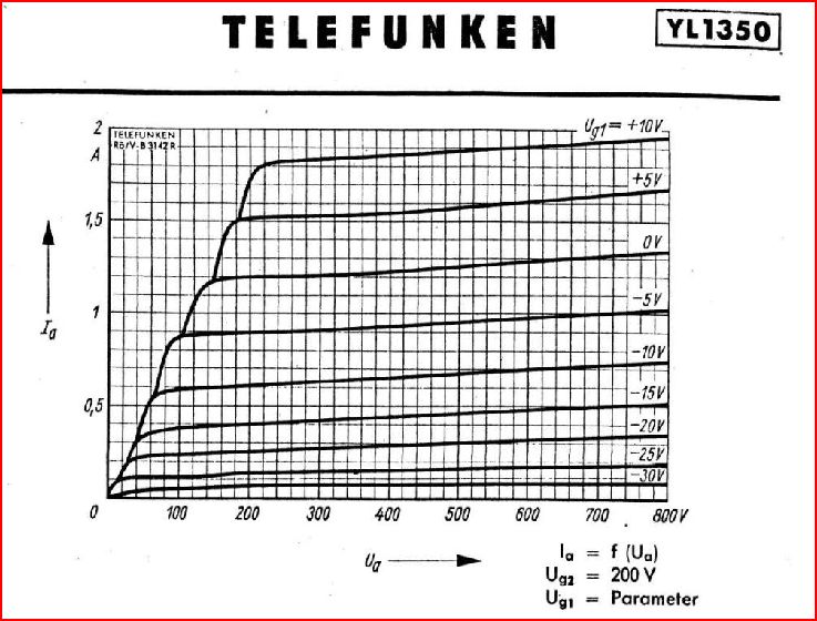

With two EL509/519 a 200W amp can't survive very long,Pa max=35W !
Input power 300W with classB, 2/3th (200W) to the output lieves 100W (50W pro tube) to be dissipated.
It could be possible with a pair of YL1350 (sold by Ask Jan First).The Pa max= 75W.
Only small problem,heater on 12,6V.
Mona

Right,
I'm not bent on the 200W output as much as 150-175. They are Sowter, so they are rated at full power at full bandwidth, but avoiding saturation is a good thing.
The 1.5K A-A is why I'm leaning towards an 8 pack of EL34s or 6L6 tubes. I cannot find the UL data for 6L6 though. I was thinking at around 340-360V in UL, if each pair is good for 30W, then 8 should get me 120W. The GC variety even more.
The EL34 is attractive because its easier to drive and 8 should give me 150W or better.
Regarding the oddball YL tube, I have two filament windings, so a 12V tube is no big deal.
Thanks!
Yes, that's where I got the data, but they are 20 years old and Brian said he did not remember or have documentation of the tubes intended.
They have a static DCR of 11.5 ohms across both primaries, so I would think they can handle a good amount of current making the possibilities a bit mor open.
