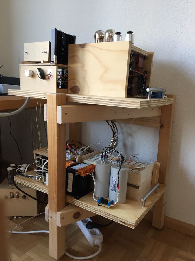

in most cases I prefer to use wooden "chassis" as my manufacturing skills are limited regarding metallic parts.
One example is attached.
This is my current class A tube switching pre-amp.
It provides switching between the 01A and 2P29L tube and between Gyrator/Anode choke as well as between C-R-C and C-L-C filament power supply.
This tool helped me to decide on how to proceed further towards the next pre-amp implementation.
All the best,
Ulrich

Congrats Ulrich very good wood work.
Cheers
Felipe
