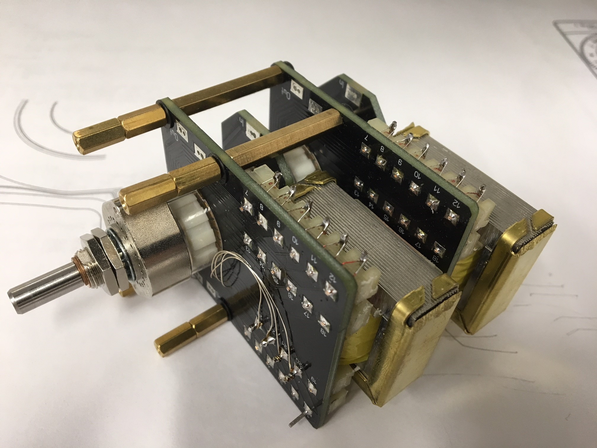

New AVC
Just connected the new AVC on the output. All i can say is, wow!
Took this preamp to new levels. I can definitely hear a distinct difference between a resitive input volume control and an AVC volume on the output. The 01a has plenty of current to drive the AVC despite the concerns. With volume around 50%, output impedance is around 600ohms which drives cables and following preamp beautifully. I’ll run some sweeps in the following weeks along with my new/old HP8903 i picked up last month. Think of an AVC like a step down IT transformer driving grid current on a transmitting tube. I think my GM70 amps like to see this impedance.

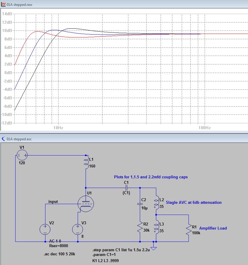

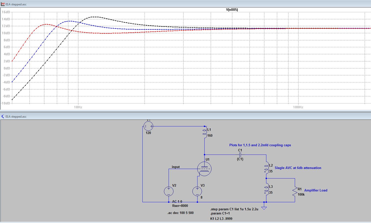

I don't have a complete schematic except for some simulations I did in LTSpice per attached.
Design is simple, tube rectifier to choke loaded power supply to a voltage regulator, coleman supplies, filament bias, plate choke.
Chassis has a divider with ultra perm mu metal to provide additional shielding.
Also using a soft start delay for warm up, I also use an octal to 4pin adapter to try different rectifiers like the 83.
The preamp is dead quiet
Absolutely not! It was somewhat with a resistive input volume control but not with the AVC. I have thrown just about every genre at this preamp and it performs beautifully. I was using an Audio Research SP6 prior to building this pre-amp. I expected a subtle difference, however in the first 5 seconds it was obvious this preamp is much better than the SP6. Not sure if its the Z or a combination of the 01A DHT and the AVC.

Khmmm....it is no coincidence, that more people -I'm too- are sceptical...Absolutely not!
This choke loaded 01a output impedance about 5k (before coupling capacitor).
It's greater, -at least one order of magnitude- than optimal for AVC.
