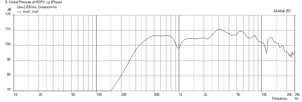

K-Tube Model
I am trying to model the K-tube tweeter in AkAbak. I am using a rectangular cross section rather than round and I have the CSA tapering to about 25% of the initial value over the length of the Karlson aperture which ranges from 3 to 5 inches long. The Karlson aperture is approximated with 14 segments. The width of the tube varies from 1.25 in to 1.0 in. The compression driver is a generic one that was provided as an example in AkAbak capable of producing about 105 dB in a 53 cm wide x 47 cm deep exponential radial horn. I am getting a rather ragged looking frequency response - not sure if I am doing this right but the efficiency is only in the 90 dB and falls off to about 80 dB at 20 kHz. Let me know if I am on the right track or this is all wrong looking.
Thanks,
X
This is the output of the CD with the radial horn as a baseline

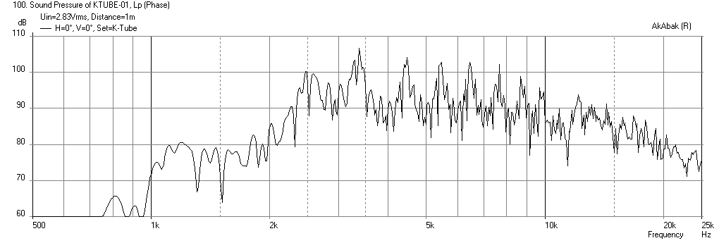

This is a 5 in long x 1.25 in square K-tube (2.5 kHz x-12 dB/oct Butterworth high pass filter used)

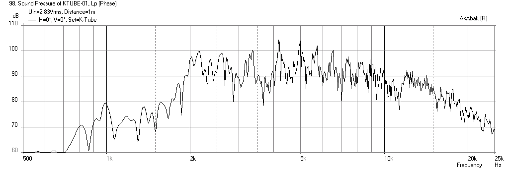

This is a 3 in long x 1.25 in square K-tube (2.5 kHz x-12 dB/oct Butterworth high pass filter used)

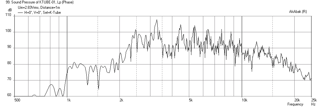

This is a 3 in long x 1.0 in square K-tube (2.5 kHz x-12 dB/oct Butterworth high pass filter used)

While it won't be as efficient as a horn, it'll be better than 90dB and falling. Can Akabak support a circular cross-section? I don't have absolute SPL measurements, but it was at least comparable to mini a Smith-horn and conical horn I fabricated. All measurements below using BMS 4550 and a 1.5kHz PLLXO.
Blue trace = Smith
Red trace = Woodhorn
Green trace = K-Tube
