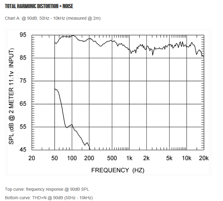

- double bass drivers by SS, MT by Accuton, price 42.000$ pair
And look at response and distortion!

Are we supposed to be impressed by that freq response and distortion plot of the $42k MKS?
Here are measurements from my Nautaloss ref monitors made using about $80 worth of drivers in a full range plus sub woofer using Vifa tc9fd's and qnty 6 buyout 6.5 inch woofers.
This is at about 95dB levels at 2m away. I get about -40 to -45dB distortion above 200 Hz and -35dB down to 50 Hz. Also spent $130 on two class D amps and a minDSP for active XO. And since they are full range tops the phase is fairly flat/linear from 200 Hz to 20khz so it sounds very good as far as imaging and soundstage goes.
http://www.diyaudio.com/forums/full-range/247598-nautaloss-ref-monitor.html
I agree with that as Cornu's have elevated midbass and sound huge. Just surprised that such expensive speakers were not as low in distortion as I would have expected.
When I first read the review on it (and then looked at the measurements) about a month ago.. I laughed. :D ..42k, built like a "tank", engineered like sh!t. :p
Oh well. :eek:
Not the topic of this thread though. ;)
