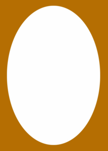

This is all a bit more complicated than I hoped. I liked bbggg's suggestion of an oval cutout brace behind the baffle and parallel to it which must stop the sides vibrating a lot:
In fact my MA R300 oldies have a couple of braces down the sides which must be the same idea:
Having just bought several metres of pine battening for the edges and for cross-bracing behind the woofer, I am now questioning if it is the right road to go down. Some triangles of timber, perhaps even just softwood rather than hard wood might be good. Am also thinking about the way they couple to the floor through the bottom, perhaps the front baffle should be diagonally braced to the bottom panel more?
