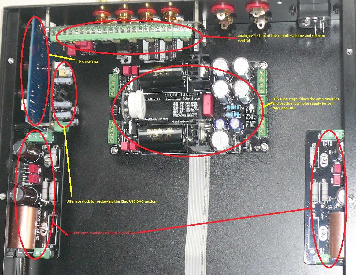

I think this one also qualifies as Gainclone, if only in the loosest possible sense...
Upfront, this will be a commercially available Kit/Finished item from diyhifisupply, however I think it may still give some ideas to some here, so I think it is worth posting up as well...
The whole project is as follows:
Small diyhifisupply project enclosure package fitted with:
192KHz/24 Bit Asyncronous USB DAC
Input Selection/Volume Control
Tube Amplification Stage
Nat Semi Chip based powerstages
Powersupply based around a custom 260VA Torroid Transformer with suitable windings to power the rest
Measured output power is around 45/65W into 8/4Ohm at clipping.

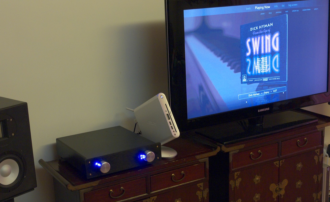

It looks like this (the picture includes the PC that stores the music and the TV that acts as monitor for this PC):
Not the most inspring casework (for one it's black), but solid and professional looking.
The insides at some point in time during the build, prior to wiring everything up (it now looks a little messier, but not hugely):
Here another set of piccies showing how it fits together:
diyAudio
All the signal circuitry is build into the Project case extruded Alu shell, the power supply is bolted to the case bottom plate, which closes up the case.
This whole thing was wired with 1mm solid silver in PTFE tubing for speaker connection, 0.5mm solid silver for the grounds and 0.25mm solid silver for the signals, power supplies are wired with coloured stranded copper.
The modules used in turn...
The DAC is basically a heavily modified Musiland Monitor 01 US. It is powered from a the Powersupply module that accompanies the clock module fitted (it has enough spare capacity). Outputs were taken from the positive voltage outputs straight into a pair of 0.22uF Teflon coupling caps.
Next is a Input selector/volume controlmodule based around DS-1666 100KOhm "stepped attenuator on a chip".
The output from that feeds the Universal Tube Stage (here with full 30dB Gain).
This in turn drives a modified "Fusion" Module. The original Fusion Module is intended as "afterburner" for SET Amplifiers (it is essentially a current multiplier). It is based around one of the "usual suspects" Nat Semi chips.
Here the Fusion module is modified to give some gain (around 3 - yes, I know, Nat Semi LM38XX Chips are not stable at gains of less then 10, well they are unless you are me, there are some circuit tricks that overcome this limitation) and the actual "Fusion" circuit is disabled, as the small signal tube stage lacks the necessary power to make this work.
The result is actually a lot better than I expected and a lot better than it should.
