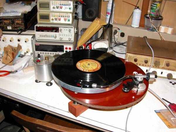

Simple DIY Turntable AKA "The Phenolic Wonder"

Phenolic plinth, TD-125 MKI main bearing, sub and main platters. Linn Basik arm and AT-120E/T cartridge. Fishing line drive via Tim Audio motor pod. Surprisingly quiet and overall fairly decent sounding.
Edit 2014: I gave this to a deserving friend a couple of years ago where it has continued to give good if not stellar service..
