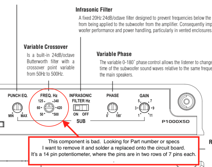

I need the part number or the values and pinouts for the subwoofer cross over component on the Rockford Fosgate Punch P1000X5D Amp that goes here:

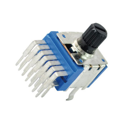

and looks like this

Can anyone give me the part number or at least the specs and pinout info for the subwoofer crossover on this amp?
I need to replace the crossover component soldered to the amp's board.
Alternatively, with the right info, I could remove it entirely, and solder in wires and/or resistors with correct values to simulate the crossover being set at the highest frequency for the sub crossover, and just use it like that. I have an upstream sound processor, so I don't need the amp's xover anyway.
The subwoofer crossover component is a 14 pin potentiometer like the one pictured earlier in this post.

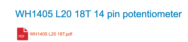

Here's some info on a look-alike part that I found, but IT COULD BE THE WRONG PART... so that's why I'm asking for help.

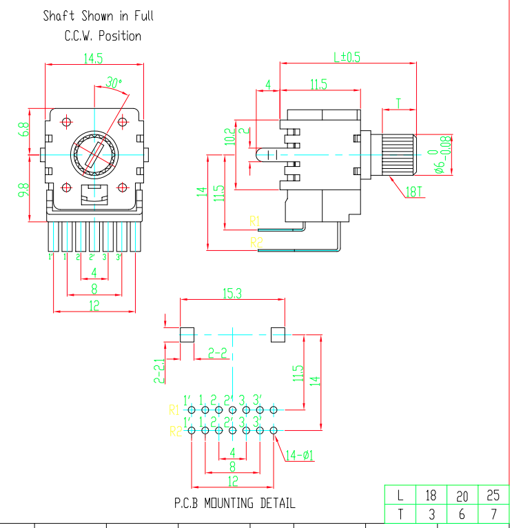

(This is the pinout for the unknown part I found)

My symptom is this: 3+ years after sinking the amp in brackish water, the subwoofer stopped playing -- no highlevel sub output, regardless of the input or the amp's settings. After some diagnostics, I found slight corrosion on the pins for subwoofer crossover (inside the amp) and I discovered that when I place my finger on the pins on the back of the subwoofer crossover potentiometer, then it starts working again!!!
For whatever reason, only my finger works for this temporary fix. If I touch or press the same pins or anywhere else in the area with the plastic end of a small screwdriver (for example), it has no effect, and the sub output remains silent.
*Maybe reflowing the solder would fix it -- I don't know -- But the problem could also be inside the pot itself. Moreover, I'd rather just replace it the part with a compatible potentiometer, or wire some straight wires and fixed resistor values in its place, so that I can count on having a reliable fix. I don't need the sub crossover anyway. I have a sound processor where I can condition the sound and set the crossover point upstream of the the amp's line level input.
