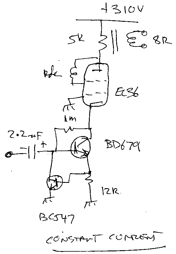

I decided to try this schema:
And at VERY low levels it sound as it should but when I raise the volume a little the sound get distorted.
When messauring the current at the cathode,it is at idle 35mA and if I raise the volume it goes down to zero...
Any one can help on this?
I soldered a Rk and an elyt over it and injekted the signal in G1,with an 6C45P and have listened some,the Va is about 300v and it sounds quite good...
