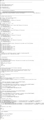

You can use old winhlp32 in WinXP to replace the winhlp programe in Win7 or Win10, but more important and complicated is to configure the registry information correspodingly.
So someone made a package including old winhelp32.exe and the cmd file.
Just run the cmd file to finish all the job.
I've try this package in my win10 64bit and win7 64bit, it's simple and working, there is Avira antivirue installed in all my two computers, it's safe.
I apologize for only just now seeing this and responding.
I'm not comfortable just running it so I looked at the *.cmd file. It appears to be designed to work on Windows versions up to Win7. If it ran correctly on Win10, well, I'd be surprised but I didn't examine it that carefully.
But let's be clear: WinHelp has been deprecated for several past versions of Windows. Microsoft provided "fixes" for all versions prior to Win10. As of Win10, Microsoft no longer provides the fixes to have WinHelp work with legacy applications. (See here for one of many MS forum posts: Winhlp32.exe for Windows 10 64 bit to access legacy help files working - Microsoft Community)
I've previously posted on how to use a copy of Win7's winhlp32.exe on Win10 to open the LEAP help files. At that point, you can navigate within the LEAP help as always.
But that's not the problem that I was hoping to solve. What I want is to open LEAP ES or CS on Win10, click on a "help" button in the LEAP GUI, and have WinHelp open up to the "context-sensitive" relevant topic in the LEAP help. Is that what your code/fix provides?
