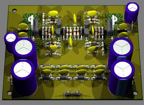

This came out of the active filter board group buy - with nearly 500 boards sold, what are we going to use to power them? I started a design here, and Jens is tweaking it.
The basic concept is a "universal" positive and negative supply capable of several hundred mA output with:
discrete rectifiers - either 1n4007 types or TO-220 high speed
CRC filter
Discrete regulator with plenty of heat sinking available.
Rather than use the ubiquitous three pin devices, the board will use discrete components to allow using this board for higher voltages as well as the 12-15 used for op amps.
A low noise precision voltage reference will be used.
We're not looking to duplicate an extreme regulator like the Didden/Jung Super Regulators. We are expecting a reasonably quiet, stable regulator suitable for audio.
Since we now have Jens' design services, what would you like to see incorporated in a multi purpose regulator board? We'd like to keep it within the free Eagle size limit of 80 x 100 mm.

Idea: Place Pass Transistors on one PCB edge to facilitate single external heatsink as well as PCB mounts.
desirable and/or possible?

idea 2
The space for the electrolitics is rather small.I would like to use bigger caps than the ones used (i guess 12-15mm).
You could combine the space for the rectifier diodes.You either want to use standard or TO220 devices.This way you could reserve more space for the electrolitics.
Also wider tracks for the higher current parts.
I very nice layout though.
Kees.

Here's another one.
Has anybody thought about a relais for shorting the outputs during startup/shutdown?
I've heard that these filters will make the strangest noises when shutting down.
A delayed - on and fast - off would be nice.
Kees.

Wow, and it's not even Friday!
Comments -
The pass devices are not at the edges of the board, but the heat sink provided should enable these boards to handle an amp or more, correct?
Any way to make a spot for LM4040 or similar instead of zeners? - maybe they could share a common pad.
We lost the TO-220 rectifiers. An extra pad at one end of the diodes would allow that without taking up more board space. I know your feelings about them, but the board might have more universal acceptance with them
The bigger main filter caps are good.
Would you explain the purpose of the extra resistor in the tail of the LTP?
Comments -
Bob,Thats exactly what i meant about the space for the diodes.If you provide extra pads for the TO220 devices within the space of the diodes you don't lose extra space and still can use both.
The same goes for the LM4040.One extra pad within the space for the zener will do.You just cut the third leg of the lm4040.
As for the heatsinks, for the purpose it is intended the size should be big enough provided you choose the right transformer.
Say 3 to 5 Volts drop across the output device and a current of 200 to 300 mA max. will give you 1.5 Watt dissipation.The SK104 has a coefficient of 11K/W So at room temperature it should not get hotter then 36-40 K.
Kees.

kro5998 said:Here's another one.
Kees.
Probably ought to be a separate board, since it will have signal on it. I've been thinking along those lines and that accepts a 12V trigger - I'll work up something tomorrow.
Still would like to see pass transistors on a single edge
advantages are many
1) wider variation of input voltages and transformer options
2) reduces cost of finding and purchasing 2 PCB heatsinks
3) Can use simple L bracket or even chassis mount

Nice work Jens

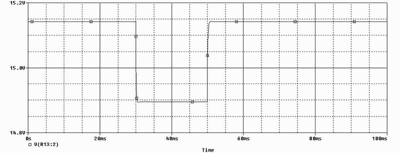

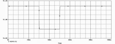

Have you made any calculations/simulations about the possible performance? Speed, noise, PSRR, regulation properties, output impedance?
kro5998 said:...what is the diameter of the Buffer caps?
The main filter caps (C4,5,23,24) are 17mm, the output caps (C10,18) are 10.5mm

I added some a few extra parts to bring to the output impedance with a factor of 10 to about 25mOhm (@DC)
PSRR looks ok and stability is not an issue....

Would it be a good idea to rotate the component layout 90 deg on the board and put the output contacts in the same position as the power input on the filter boards?
Then it would be possible to piggyback the boards with short leads....
Why don't have LM431+LM385 pinout. If you have that you can use almost any reference in TO92 package. LM329 will fit without any hassle. Look at my JSR-06 PSU for inspiration.JensRasmussen said:Update/evaluate voltage ref to TL431.
Look at snobbers... Carlos are you listening??
If you have room why don't you add SOT23 transistors also. There are many good SOT23 devices out there.
It might also be an idea to have an extra LP-filter for the reference but this has also to do how much the noise is from the regulator itself.
C13, C15 why? Don't you loose feedback in high frequences?
Have you noticed that you have equally many parts as in a super regulator but it is still a discrete regulator.
