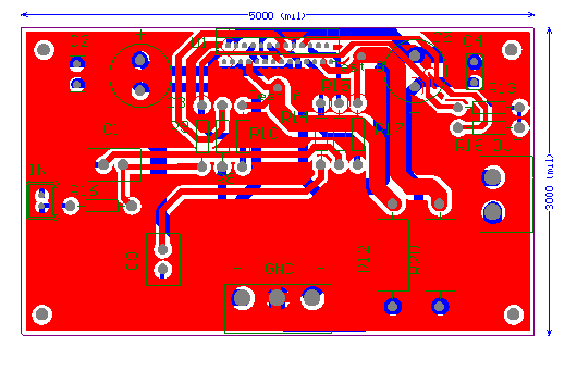

Hi gays,I have designed two LM4780 pcb projects.One is standard two channel stereo amps,one is in parallel.The boards size is 127mm x 72.5mm,double-sided pcb,single chip.
the prices of small batchs is $20 USD/1PCB,30 pieces boards.If more, prices can also be reduced.
this is parallel layout projects,the standard stereo projects with the size of the parallel similar,same boards.you can use it make a stereo amplifier.
anyone interested?

I like discussing more technological details even more, making this project more perfect. I have designed a 4780 of bridge mode again.

Looonnnggg tracks
Digi,
All of the paths in your layout are kinda long and so it'll be interesting to see how well this works. I'm worried about mains buzz (ground loops) and poor response due to inductances. Also, what are the component values and types?
Is the board really 3 x 5 inches??? Why so big??
What are the goals of this project?

I use top-down layout technology,and star type ground wire(no ground loops).it's can effective driving away buzz.The shortcoming of this technology is a long track, there are boards to be kept and offer some space for the stars ground
but it have really good performance and looks beautiful.
I am not clear. . . But I want to make into the real thing, I like pcb layout and design, it is one art in my view.
