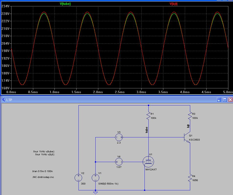

Addressing primitive common cathode valve amplifier stages Vs common emitter transistor amplifier stages; If you were to get a high voltage CRT driver transistor and make an equivalent amplifier stage to one using, say a 12AX7, 12AT7 or 6DJ8 (or whatever), with the transistor emitter degenerated to the same transconductance and Ic the same as Ia, you’d have an amplifier stage with at least an order of magnitude better linearity.
As for the nebulous claim the SS power amplifiers have worse open loop linearity than valve amplifiers, a typical SS “Blameless” amplifier (as described by D.Self) may do 0.01% THD at full power at 20kHz, with a loop gain of 30dB at that frequency (and progressively less at each next harmonic). This returns a (sans gnfb) non-linearity of substantially less than 0.5%
To illustrate the point......
I've made sure to use decent models for both the BJT and the tube here.
Fourier components of V(tube)
DC component:199.762
Total Harmonic Distortion: 1.112822%
Fourier components of V(bjt)
DC component:200.063
Total Harmonic Distortion: 0.100932%
