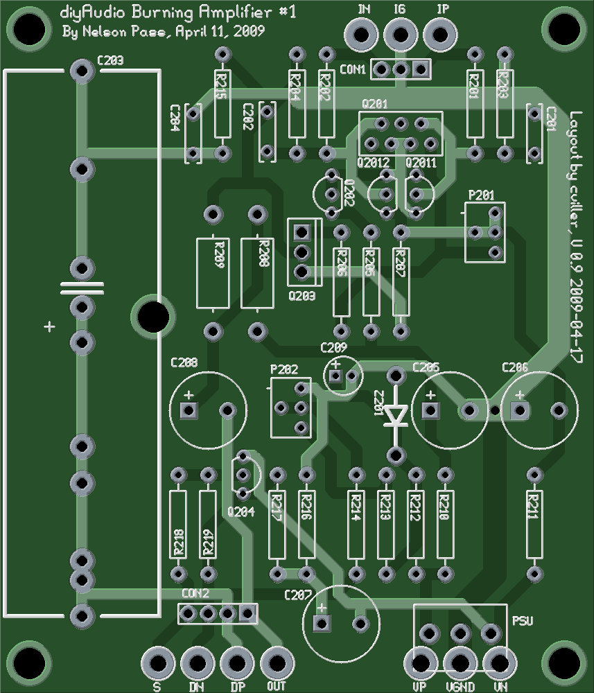

Variac asked me to make a layout for the frontend and here it is. It is version 0.9, which suggests I'll pick up suggestions from you guys before diyAudio puts it into production. Any profit will go towards the forum upgrade.
The board is 3" x 3.5", and one of the primary design constraints is that it must be able to fit into the cabinets given out at the Burning Amp festival.
I have made one change in respect to the original schematics, which is the addition of footprints for 2sj74 as an alternative to the 2sj109.
Hi Christian,
nice layout, a few first suggestions after quick look:
- Q203 should be heatsinked, so a bit space around it would be great. I would suggest putting it a little bit down, away from Q202 and the resistors right to it a bit to the right.
- C204 could also use some more space, e.g Wima FKP2 or Vishay KP1830 both have 4.5 mm width.
- C203 is very long but slim. Did you have any special capacitor in mind? Only 2 or 3 mm wider and a MKP10 would fit (20 mm)
Thanks to Nelson for sharing! 🙂
Greetings,
Chris

Variac said:
I may be guilty of contributing this idea: The thought was that the cap could hang over the edge and be secured by a wire-tie around the outside of the board and through the hole in the board next to the cap.. This would pull the cap to the outside so maybe the MKP would fit? ....Comments?
The idea is ok as long as the boards with capacitor still fit into the cabinets (cviller: "The board is 3" x 3.5", and one of the primary design constraints is that it must be able to fit into the cabinets"). I would expect that if the board with overlapping capacitors fit, it would also be possible to enlarge the board.
As the board is layouted now only axial caps would fit, if the board area is fixed maybe Christian can move the pads a few mm more to the edge so that radial caps would also fit (also hanging over the edge).
Chris
