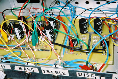

Today, I hook up my BOSOZ (balanced out) to my Aleph 2 (balanced in) and I could not believe the amount of bass that I'm hearing from the $500 Maggies. I have used the Aleph 2 with some other pre-amps for the Maggies before but today is the first time I tried it with the BOSOZ. So, I'm very sure the much improved bass is due to BOSOZ. I'm beginning to wonder why BOSOZ makes such a big difference.

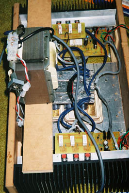

Here is a shot of my Aleph 5 with Hi Cap power supply, it runs very nicely and I may convert to the Aleph 60 or a small Alpeh X!
The Aleph 5 is still a great amp though and practical for most to contruct.
