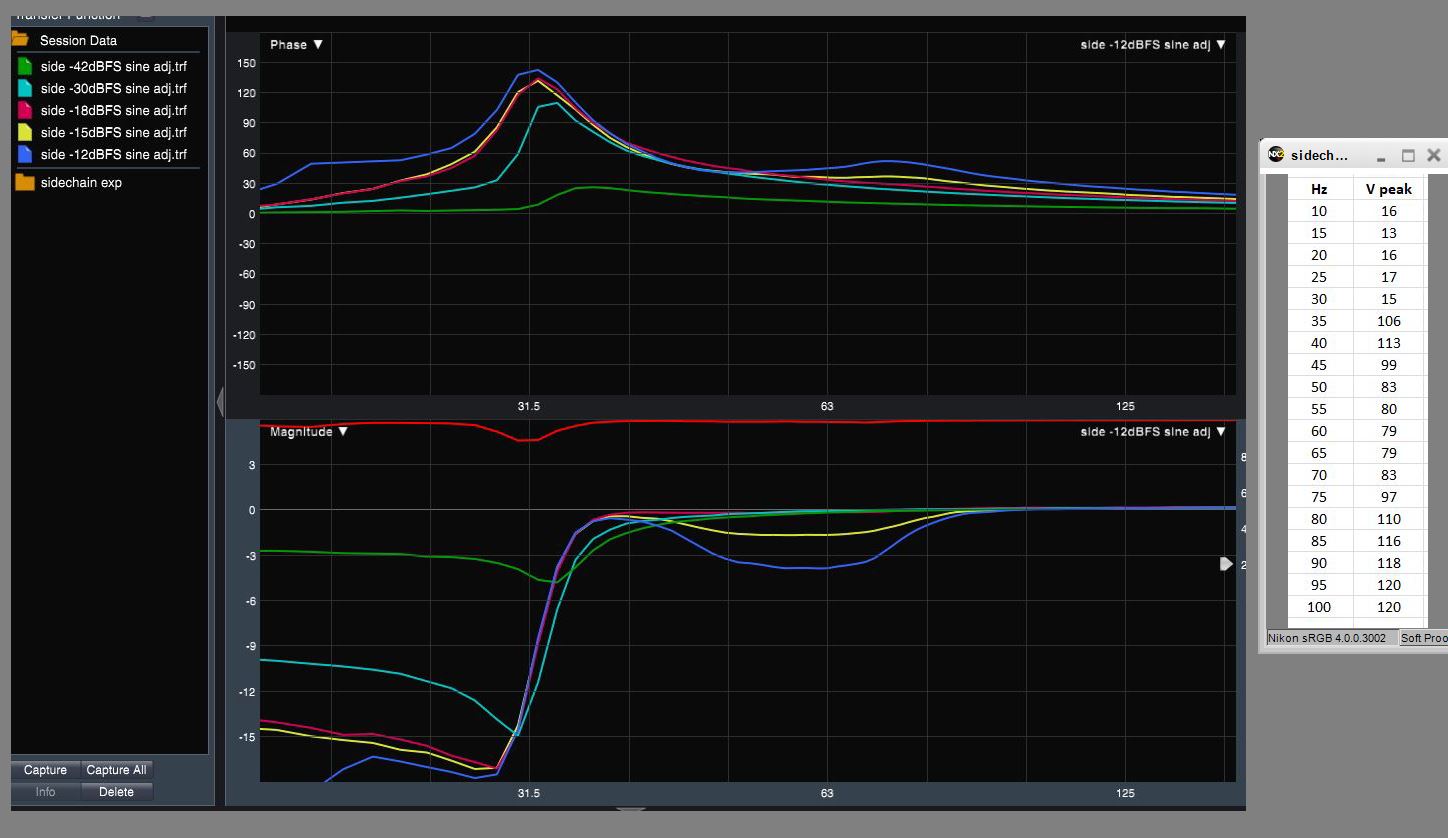

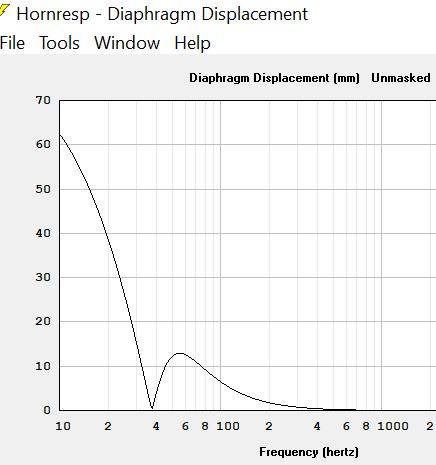

I tried this idea for a 18FH500 in a reflex box.
The box had excessive excursion at 69v around 55Hz, well above f3 tuning at 40Hz.
Attachment 974282
There was no need to lose the reponse at 40Hz, just a need to tame excursion higher up. So I built this sidechain limiter that responds to level.
Attachment 974283
The voltage chart is the peak voltage a PL340 would output with the limiter in place. The voltages tied to keeping excursion to 9mm across the freq range.
(So 80Vpk = 56Vrms = 9mm @ 55Hz))

thanks for showing your results; Low tuned bass reflex looks to be a good use case. The limiter is based off the Hornresp prediction in this case?
Yes, i never actually measured physical excursion...still not really sure how to Lol
