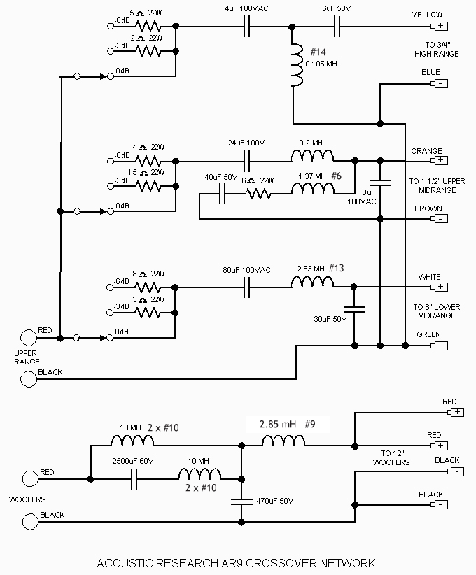

Actually, I saw the vintage speakers: Acoustic Research AR9, use the same configuration as my project — 2 x 12” woofers. When I search for their info, I found their woofers are parallel connected and, moreover, they are 4 Ohms. Thus, the impedance/ resistance may be 2 Ohms for woofer section. Can I conclude that it’s okay to use 2-Ohm configuration for woofer connection?
The two AR9 woofers are wired in parallel to the same filter circuit, however they use a clever filter circuit.
Although each driver is nominally 4 ohms, it is much higher at its resonance frequency. With two such drivers in parallel, you would expect the impedance to be well above 4 ohms at resonance but down to 2 ohms or less at other frequencies. But this is altered by the arrangement of inductors and capacitors which increase the series impedance above and below the system bass resonance of 28 hz so that the combined impedance never goes much below 4 ohms at any frequency. This protects the amplifier and flattens the frequency response of the woofers at the same time.

Concerning the bass portion of the AR-9 crossover. I suggest removing the 2500 uF cap - but NOT the 470 uF cap shunt to ground. The 470 is a critical part of the 200 Hz low pass filter. The 2500 uF cap was placed there to raise the impedance at resonance - otherwise the two 12" woofers are effectively in parallel with an impedance of about 2.8 ohms. An amp killer - particularly in the world of 1979. So if you do remove the 2500 uF cap make sure you have a modern solid state amp - no tubes need apply - that can handle low impedance loads.
I have found two amps that are comfortable with that load; Odyssey Audio Khartagos and Pass XS150.5. I am relatively certain that ANY Pass amp in his XS or XA models would work well with that kind of load. There may well be other solid state amps that can handle such a load - but DO NOT try to drive the modified Nine with any "vintage" receiver - the result will be smoke, possibly flames and a dead receiver. Nor try to use an H/T receiver - those things are at best rather flimsy in terms of actual power capability.

Could anyone help to explain the principle and the calculation of this circuit, please?
Is this filter be a 3rd-order low-pass filter?
If I would go for 2nd-order with 85 Hz x/o point, could I simply calculate it by using a normal 2nd-order method and only paralleling those large capacitor and coil to the first inductor?

Using two 4 ohm woofers in parallel is a bad idea, unless you are an accomplished loudspeaker designer.
The AR-9 bass filter not only takes into account the electrical parameters of the woofers, but also their acoustical interaction with the enclosure.
It's complicated! :eek:

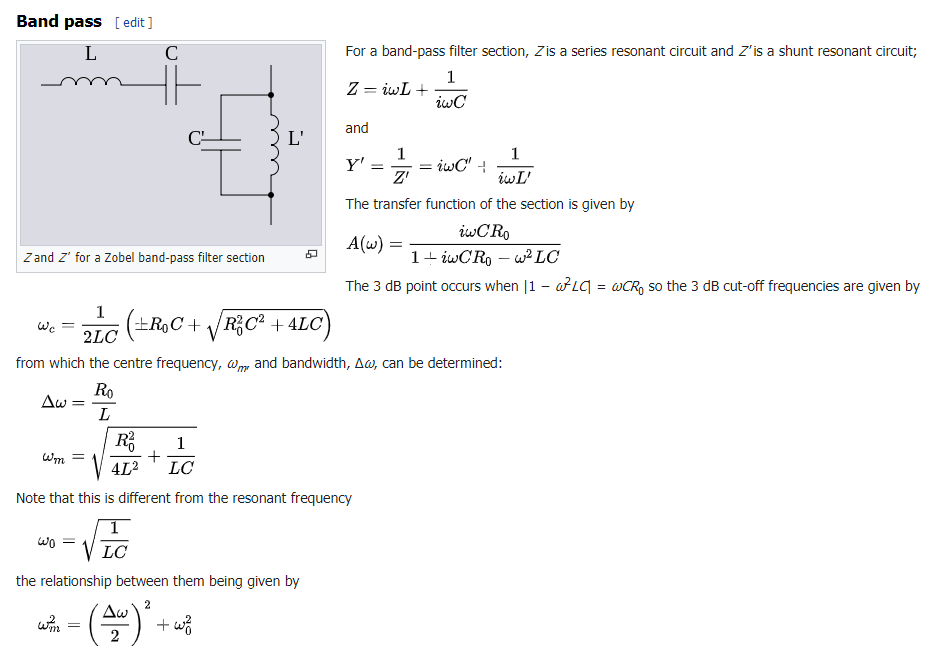

Hi all,
Let's look at, finally, what I've found. I found a calculation of that L-C circuit! :eek::D
It may be a kind of bandpass zobel circuit. The formula are already shown thoroughly. Here is a full link; Zobel network - Wikipedia
I'm not a big fan of math, so I'm needing a help on it. :p I'd like to try to reverse engineering that AR9's filter.
Please educate me, what is R-naught? Where can I find it? Thanks

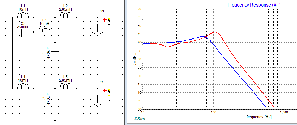

diyAudio Moderator
Joined 2008

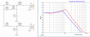

presscot, here is an Xsim comparison. The difference is the notch. It also affects the knee of the filter but that's an incidental effect which you just need to adjust for.
So, Allen, are you advocating that presscot wire two 4 ohm woofers in parallel? :confused:
I thought you were doing quite well yourself on that front but if it helps I don't disagree with you (maybe a little on the severity, but no I wouldn't go around suggesting members do this).
