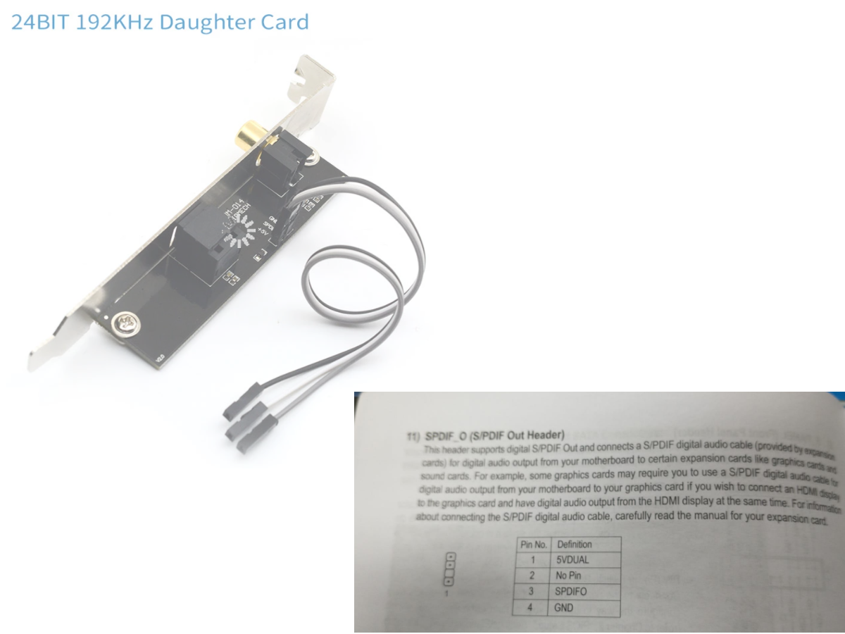

I have been using SPDIF adapters for the longest time. In the past asus motherboards used to came bundled with the adapter. I checked my last board, a mid grade z490 for the Intel 10th-11th generation and comes with the header. To my knowledge, most of the DIY type mobos came with the header, as the functionality is built into the audio chipset, all it cost is 1-2 cents for the header connector to the manufacturer. Attached is the page of my board. This is an Intel industry standard connector.
If you look at the pinout you can see that the payload is signal (SPDIFIO), Voltage (+5V) and ground. Toshiba (Toslink) created an optical standard that was genius in its simplicity, a red LED will blink out proportional to the SPDIFO, and that functionality was mostly built on the socket of the fiber conector, wo , I guess, the +5 and Gnd lines power the LED and the SPDIFIO modulates the PWM timing of the LED. Connectors are mostly either input or output I(have not seen any bidirectional). The ones in the mobo are transmitters (output)
So, 1) a very simple adapter connected to that header will give you optical SPDIF Toslink 2) For RCA coax, I guess you do not need the adapter, connect the gnd to gnd and signal to RCA.
Adapters can be sourced on ali, ebay , amazon in the range of $15. The asus is a tested design and I can see them for $15
