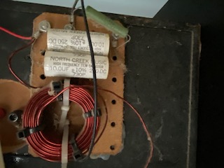

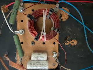

Thank you for the crossover info. It was probably 25 years ago that I replaced the Kef units with the Vifa's. They came with 2 crossover boards each which are externally mounted. I'm going to see if I can still read the values of the components. Hopefully they're not to faded to read. This has reawakening the audio hobby that was dormant for many years.
