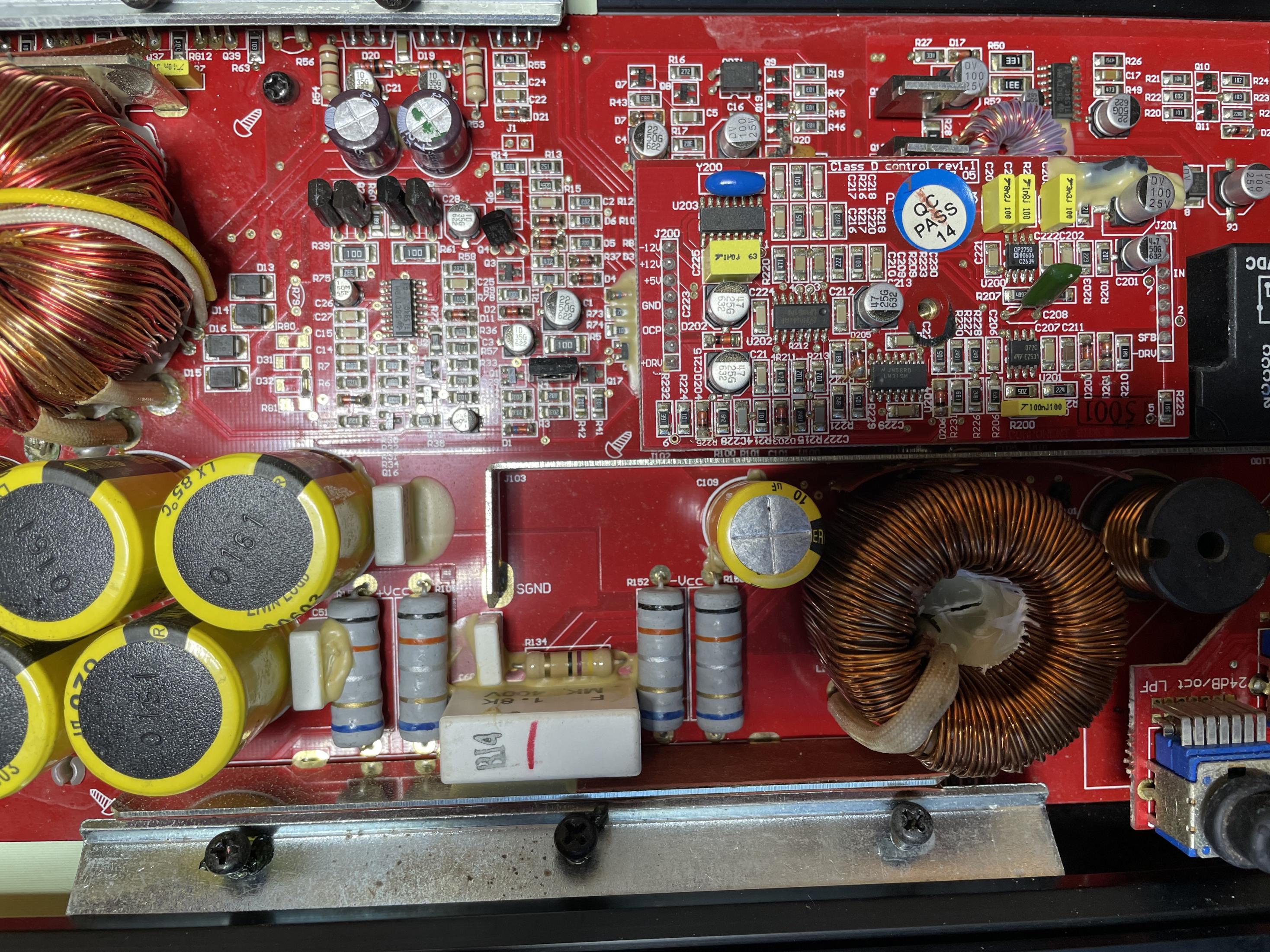

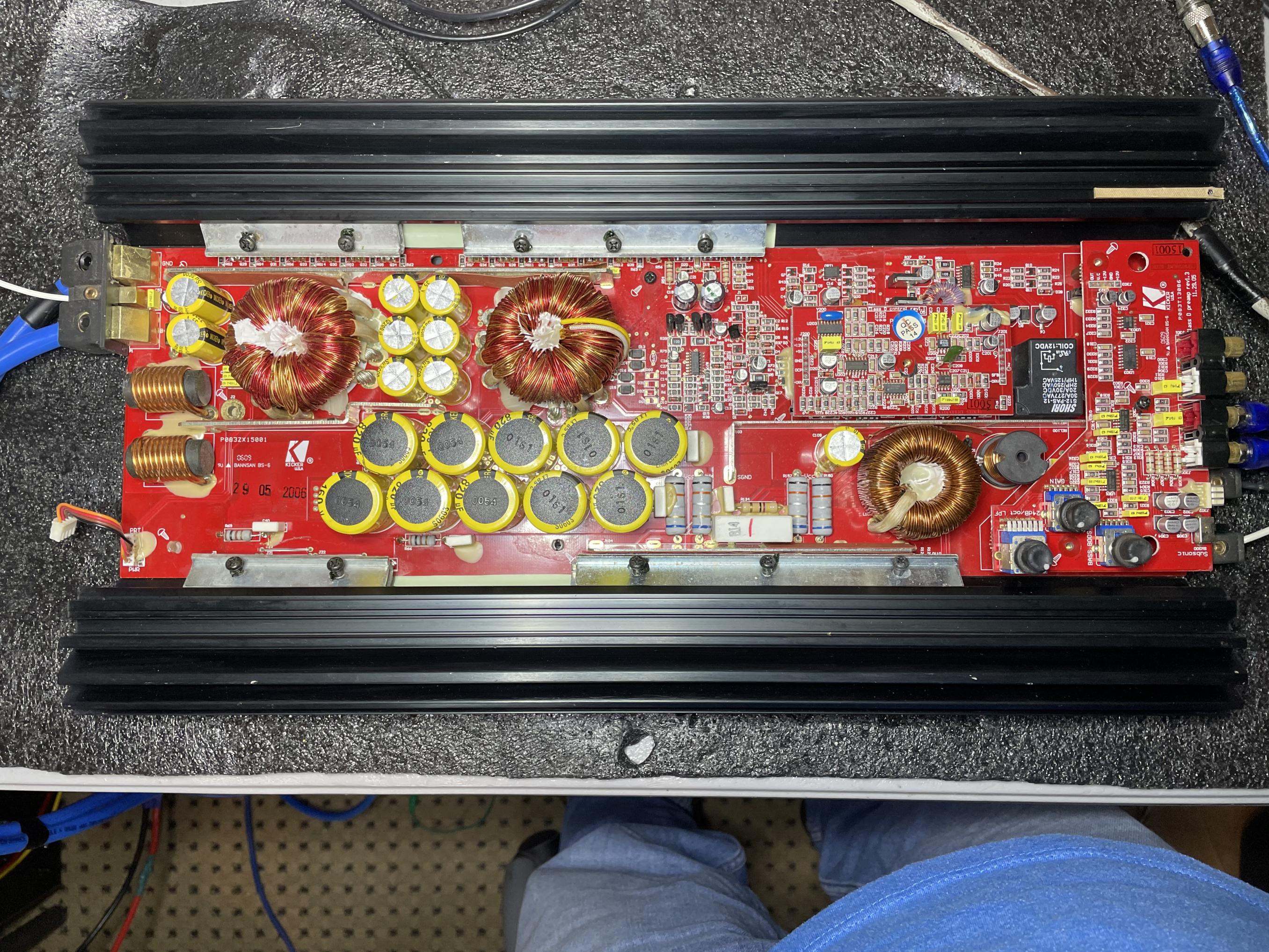

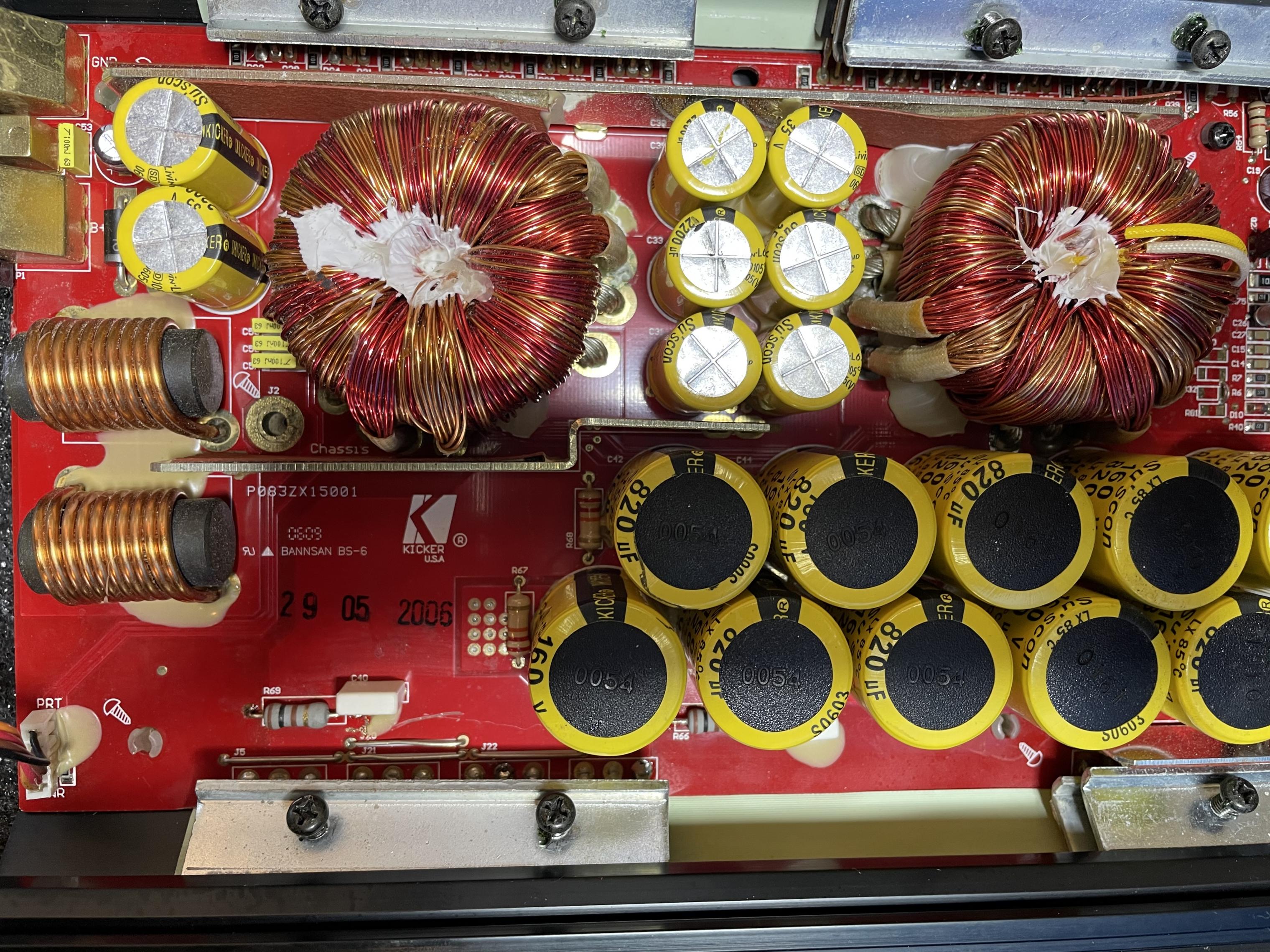

If you would Peeby, post pics of board. One overall, then two more spitting the board with and without preamp and daughter board.
D7 will disable OCP and DC Protection. I will get into this more when I see the pics. The pics will help me determine the version you have on your bench,
Here are the pics

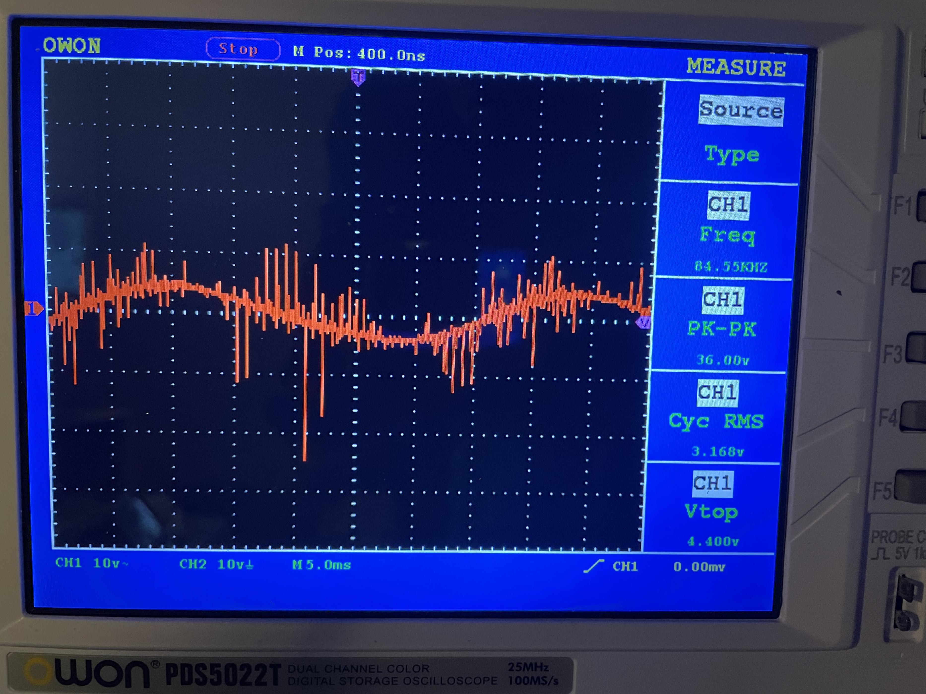

Can I ask a basic question? This amp seems to have a lot of noise, everywhere. Even on the ground.
What is the basic test for the rail filter caps.
Pic is of the negative rail. it is at -100v. I put the scope on AC so I could bring it up on 10V resolution. That sine wave follows the input sine wave to a degree.
