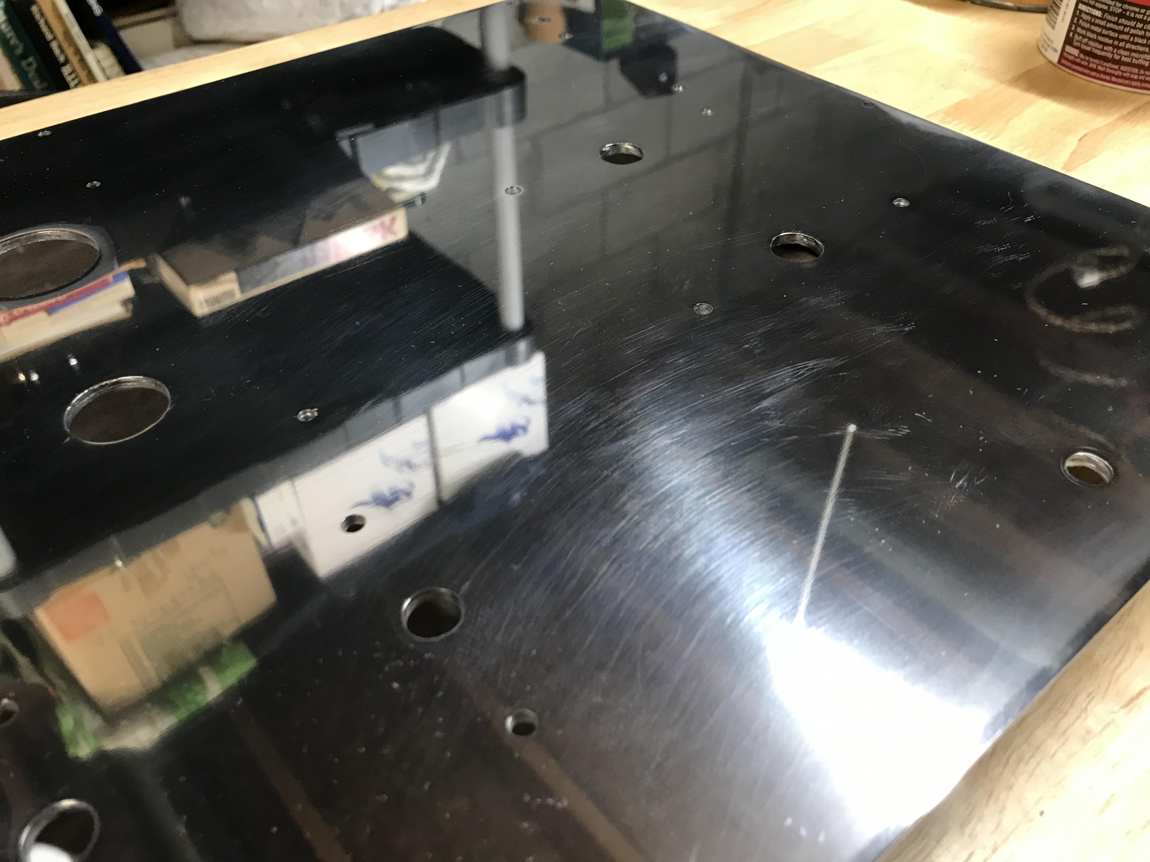

I am building a tube amp with wood sides and aluminum top plate. I have sanded to 2000 grit paper and then polished to a shine. The shine always shows scratches in the direction of my polishing is it possible that some aluminum will never polish all the way out?

I am not 100% sure, I believe your scratches are deeper than the grit on the 2000 paper. I think you have to go up in smaller steps on grit ie 220 300 400 600 1000 2000 polish etc.

I've polished aluminum plate and it's plain to see that you never got the scratches out from previous grit sandpaper. For a large surface like that use a sanding block as well. Maybe go back to 1000 grit and work it for a bit. Hit it with something like Mothers aluminum polish and give it a quick buff. All the sanding marks will pop, do you see anything that stands out? If so, go back to the 1000 grit and try again.
Rinse and repeat. When it's perfectly uniform go up to the next grit.

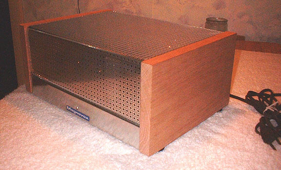

I've finished with a good wipe-down by using what's called a Miracle Cloth to lay down a protective anti-tarnish finish.
15 years later, the front facade still looks nice...

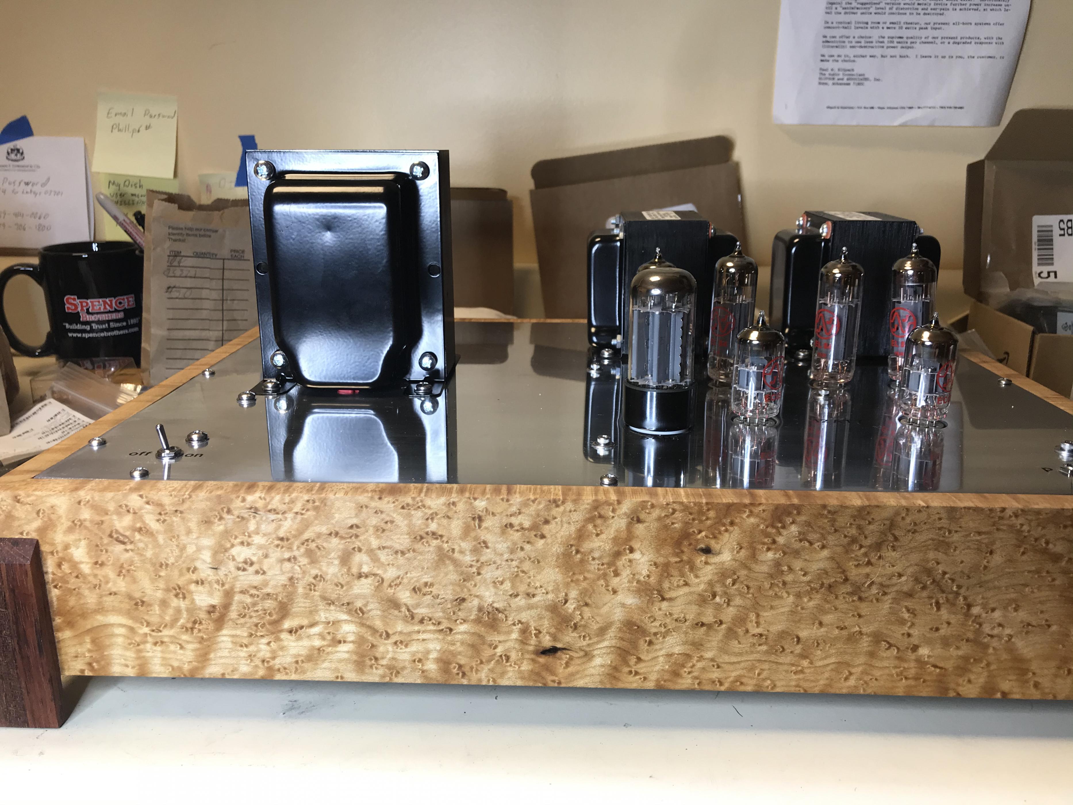

Thank you all for the time and advise! I finalized with what I call controlled scratching my water here is hard and I found some minerals must get thru and can wreak havoc Here are some pics
