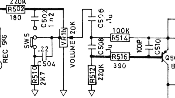

Like most 70's-80's amplifiers, the loudness characteristic is defined first by the specific type of tapped potentiometer (there are 4 connections to each wafer of the stereo volume control and one is a tap at about half volume). Then the roll-off frequency and depth is set by a quite simple little RC filter that reduces high frequencies more as you turn the volume down below the point where the tap is located.
There's quite a problem to duplicate the control though. You need a dual, tapped 20k log or audio taper potentiometer. Good luck finding any affordable tapped pot with the same characteristic now and you'll need a miracle to find the exact type for your particular version of the 3020. (there were many versions over the years)
The best you can hope for is a fairly close version but I doubt you'll find just what you need. The reference schematics show the filter and volume control as described on several NAD models and the volume control with the associated switch and RC filter is identified as VR1a and b on early model schematics showing the switching and tone control section and other sections of the amplifier in separate diagrams. You can find these at hifiengine and elsewhere on the net.

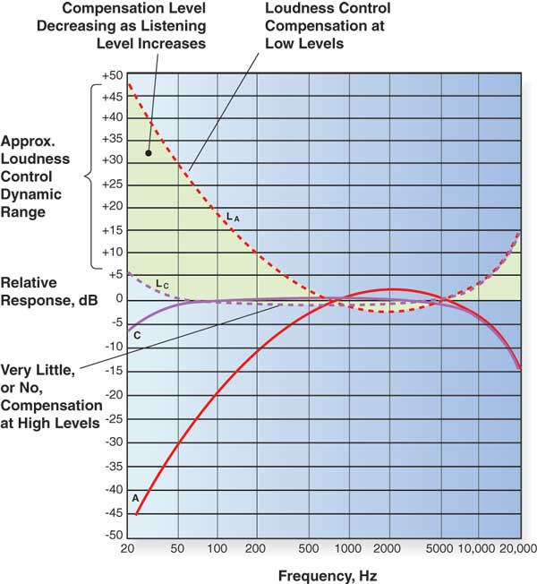

A typical loudness control compensation is shown in the attachment (dotted red line). It shows a large boost at low frequencies, a smaller boost at high frequencies and a slight dip at mid frequencies. This may give you a guide as to how to set your equaliser.
The graph is taken from: The Mysterious Loudness Control: What Does It Do? | Extron
