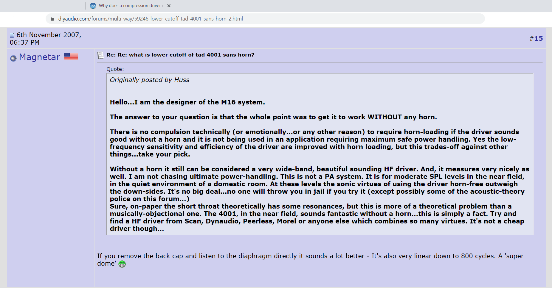

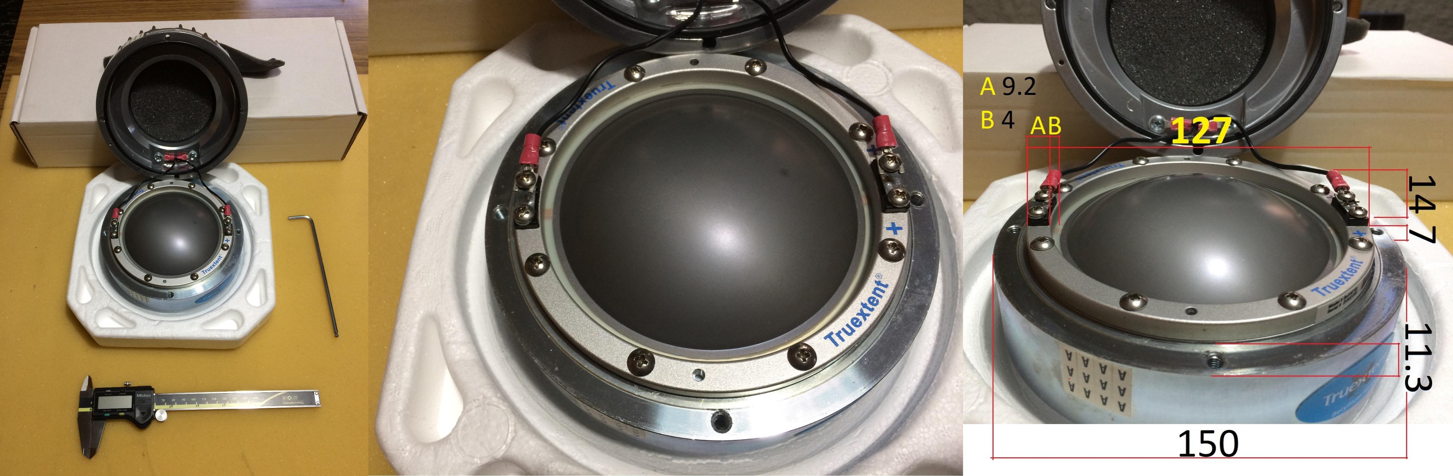

This has been tested, there are users in Japan that listen to CD as direct radiators. There was a company in AU that sold a 2-way speaker with the TAD 4001 hornless but with the back cover in place. Magnetar/others have posted this is possible. I have a 950PB with the Be Truextent and I plan to test it hornless and no back cover from 1Khz up. I have been told the lost in sensitivity will be about 10dB. We will see what is possible.
