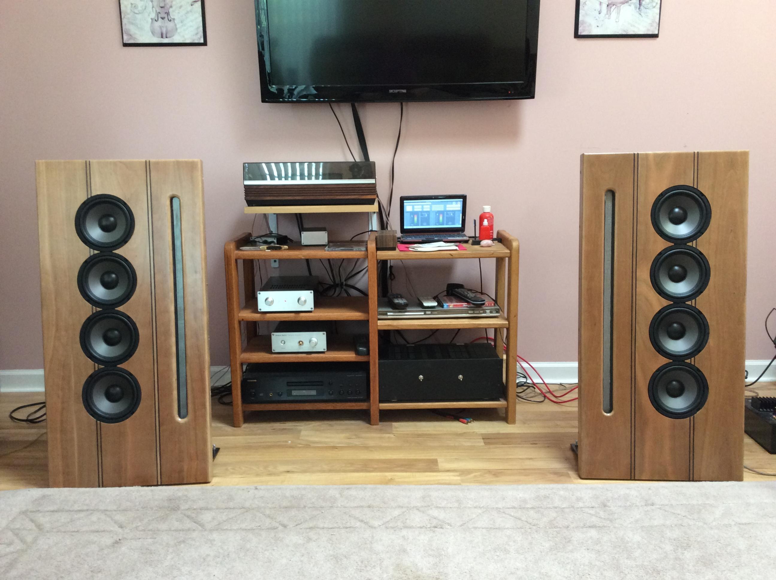

I have a pair of Apogee Centaur Minors and whilst I like the mid and treble ribbon the bass from the 6.5" isn't the best.
As a project I was thinking of building open baffle line source of woofers to go with the Apogee Ribbons.
Just wanting advice, resource etc. to help me select appropriate woofers, baffle dimensions, crossovers etc. to get the best integration between woofer array and ribbons.

Been done by PJBlakey. I wanted to do the same to mine but came to the conclusion my room isn't big enough. I've attached a pic of his build and if I get time will search out the thread.

Sorry, I just realized my post wasn’t completely clear (although I’m not sure it’s important). I meant I’ve been happy with the vertical array of six 8” woofers, none of which are really designed for open baffle use. With enough drivers, they can handle the equalization necessary to flatten the bass response without running out of linear displacement. I’ve been happy with the planar magnetic line array as well, but that’s not particularly relevant to this thread.
