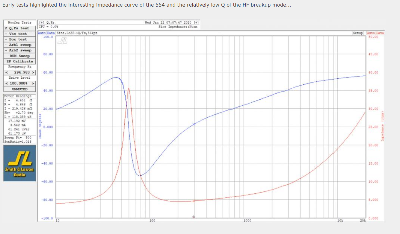

Anarchy 554 TS and impedance curve
This is a chart from Evil Twin @ DFAL More info on the link. Includes TS and impedance curve for the 554
