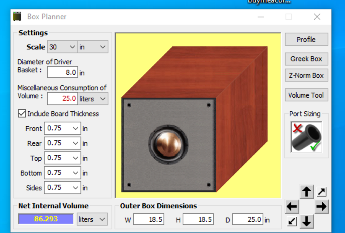

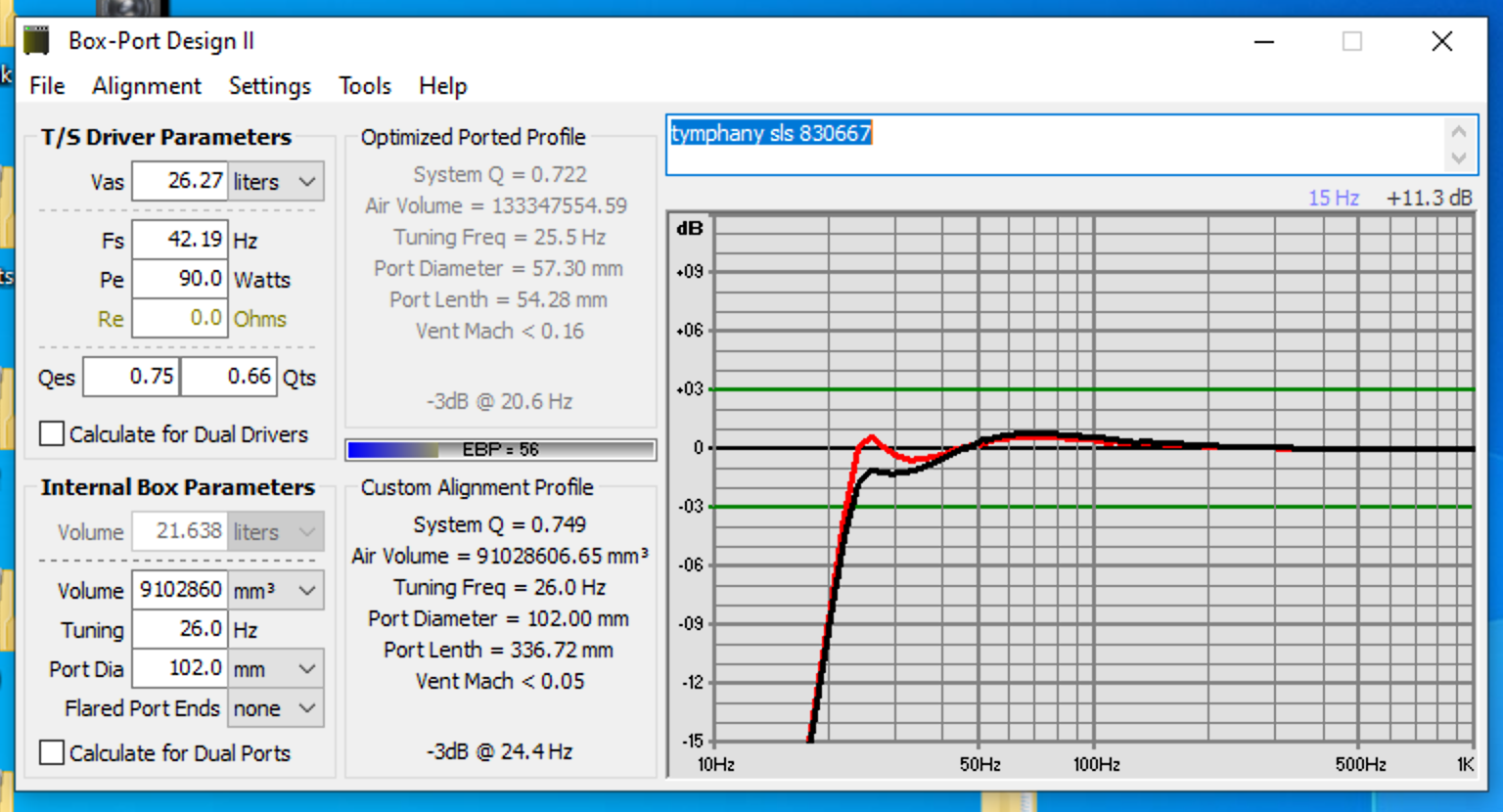

Hey guys, this is my first subwoofer build, I'm looking for some clean deep lows that will suit my living room. 7ft x 7ft.
The Peerless SLS 830677 is what I had in mind as its available for around 5k INR in my region.
Peerless by Tymphany 830667 8" Paper Cone SLS Subwoofer
Attached my design from Box - Port II . pelase correct me on this entirely new to this, came into this design after a day of research.

Did you factor in Room Gain? Having a Butterworth alignment with a 26 Hz Fc will almost certainly result in over emphasized, boomy low end, especially in a smaller room. I usually go with a "Q" of .5 to .6 and a Fc around 30 to 40 Hz or so, that way you get more natural sounding low end response, and it's less demanding of the woofer.

Oh actually the room is lil big that 7x7 as its open to the hall at one end. Which peerless driver would you suggest? also total Q factor right?
For a bass reflex PEERLESS SLS-P830667, VB = 86.0 L, FB = 30.0/32 Hz looks good. If you have the port dimensions already.
No, I don't have the port dimensions, actually confused about how I should decide the port. Can you help?
To be frank little crazy about ported enclosures, it gives the most out of the driver right?
Really?! HR shows a huge peaking at Fb, requiring an Av = Sd vent to get a reasonable vent mach at 30 Hz, making PR or TQWT alignments the only reasonable options.
With Vb = Vas tuned to the driver's 0.707x Fs [~30 Hz] practical limit, it can be reduced somewhat [~3.75"/9.52 cm dia.], but still long enough to require a shelf vent for a reasonable box ratio; ditto the pioneer's Vas/1.44 tuned to Fs optimal gain BW Vs net box size, though tuning may be too high for the intended app.
Re power requirements, if this low a tuning is used, the driver's 90 W rating is the limit down low, though with so much Xmax, hope it's a misprint as the pioneer's alignment 'wants' at least a 300 W amp.

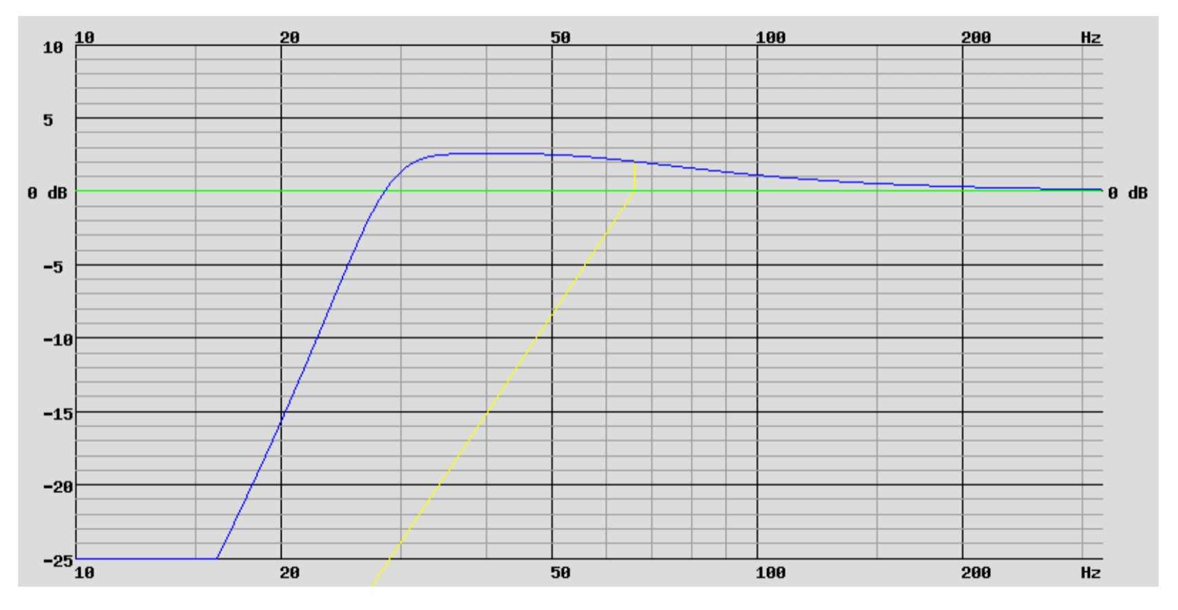

PEERLESS SLS-P830667 v2015, VB = 86.0 L, FB = 32.0 Hz, 87.3dB/2.83V/m (@0 green line)
Reflex 86L net, 32Hz: 2x Ports (20cm apart) 9.4 cm diam/39.4 cm lenght
Consider the extra volume for ports on the speaker volume.
HighPass 25Hz for protection @Xmax, good for ~130W/8 Ohms (32Hz).

Thanks for the detailed information, so this design isn't efficient?
Can you please suggest me a good solution

So I can go forward with my original box dimensions? ie 18inx18inx25in depth. Should I add two ports?
Yes 2 ports 20cm apart (c2c). If you need different dims for ports they can be recalculated for your APP.
