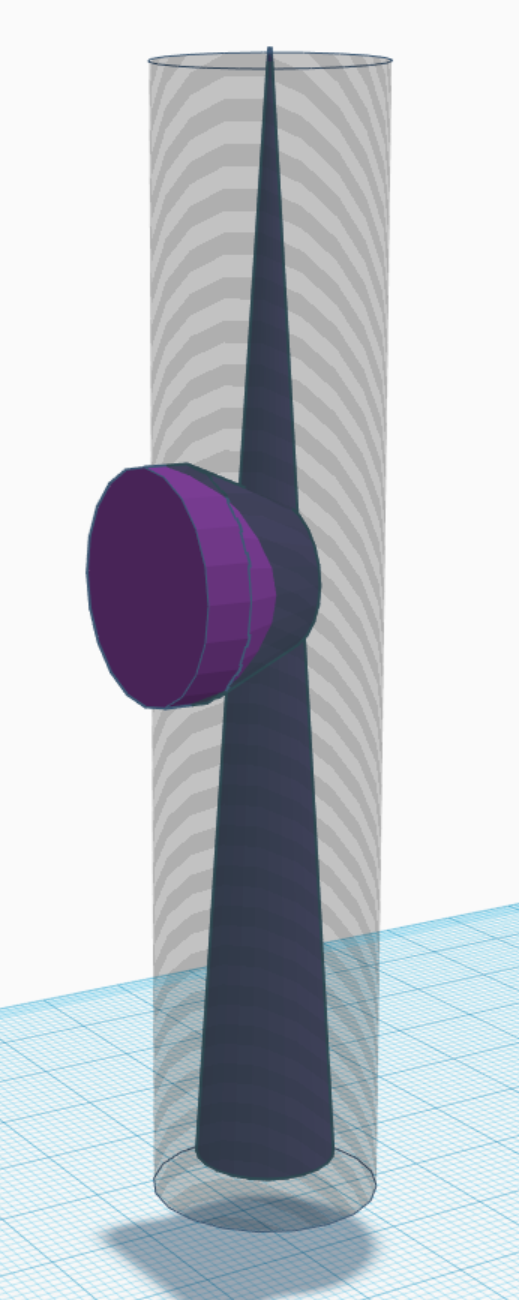

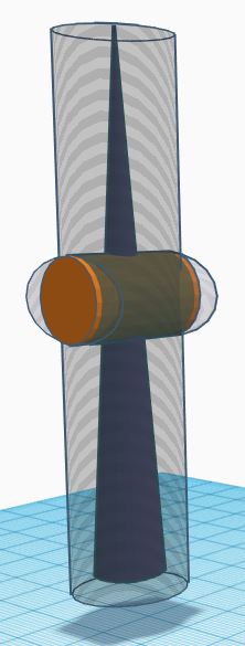

Thanks everyone for the responses.
Let me start by reiterating I have no background in speaker design theory and almost no technical understanding other than throw together a few different design elements to try and make something "cool".
Having said that, I have attached a very rough sketch of what I conceived to be the overall concept in my head. Proportionally the end result will be much taller and narrower than shown but I wanted to just rough it to show the concept. The FE168e∑ design yielded an OD of the outer pipe at 10.75" with a total speaker height of about 70".
The link to the Metronome page was actually very helpful. If you look at the "Conehead" pic what I am attempting to do is take the top part of the cone (above the blue line) and fold it back into the lower section. In my head this was very similar to the BIB which essentially takes a Voigt pipe shape and folds it in the middle to condense the overall dimensions (I know its technically definitely not that, but design-wise that's what I see when I look at the shapes involved.
Then other major difference to the conehead is rather than porting, I have essentially flipped the whole thing over and left the end of the Pipe open at it's terminus (same concept as the BIB).

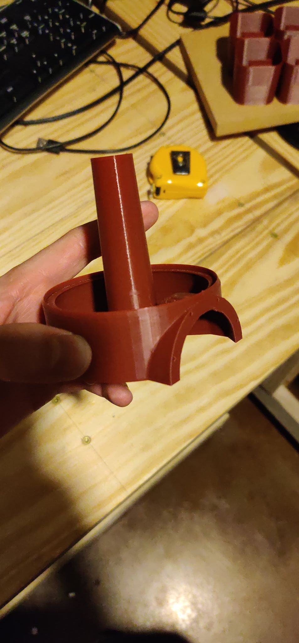

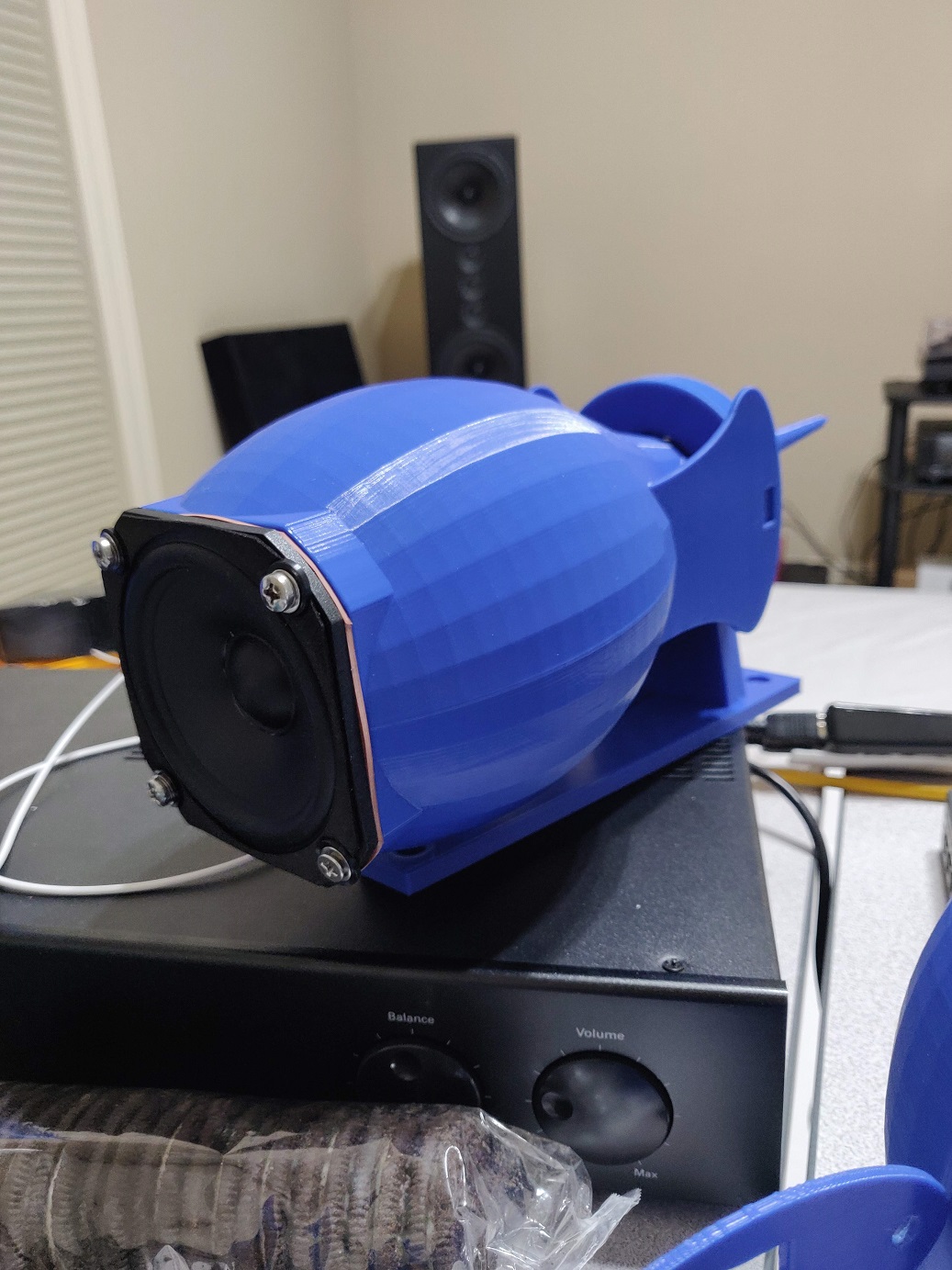

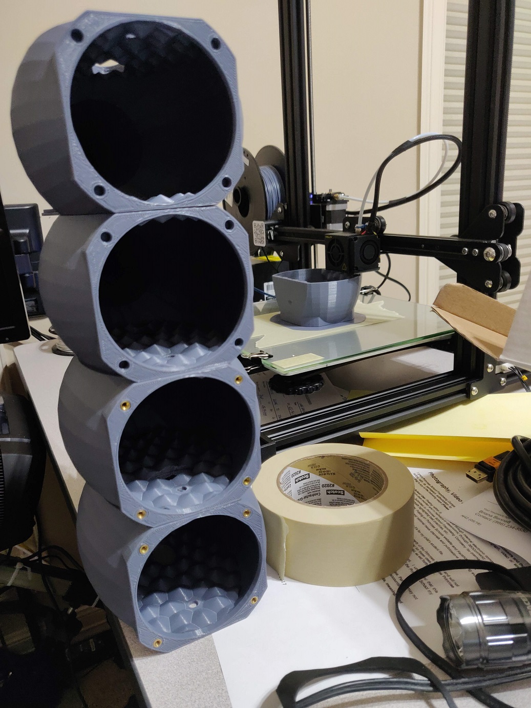

Lastly, just to show a little progress beyond concept, a friend of mine who is a whiz at 3D printing, and has some pretty fancy gear, printed one of my concept components at 30% scale to ensure that he shape was "printable". The results were pretty good in my opinion.

Somewhere i have a very similiar drawing.
...or more you could easily get reflections bouncing off 2x 45+ degrees angles...
At the wavelengths involved there is no reflection. Deflectors at the folds are counter-productive.

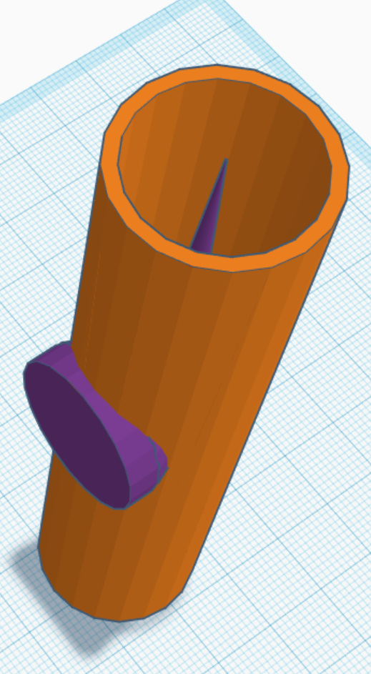

The intrusion of the coupler from the outside to the inside will reduce the cross-section of the outer-pipe as well as the little tunnel acts as a stub and i suspect impact the performance. Since the pipe is going to be 3D printed why not run one side of the inner pipe along one of the walls of the outer pipe. This will alos make it structurally more solid.
There is also a 2nd potential tap-in point for the driver (GM?).
dave

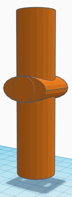

Yeah, the intersecting of the pipe is a big no no.
You are basically creating a band pass filter.
The upper part of the inner taper is basically going to be invisible to the sound. It’s way too thin. Something that in itself might be ok, but combined with the constriction just below, it’s not good.

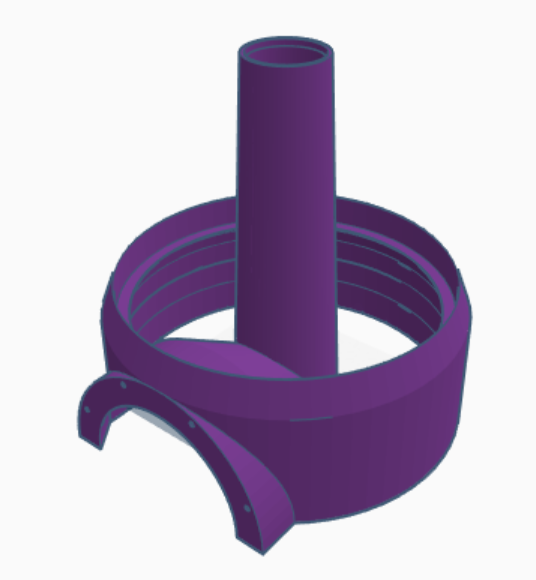

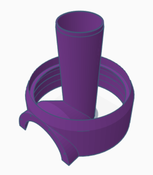

3D printing the flange is a good idea. But there is a number of ways to do a better job (damping and structurally) by hand, if you have some simple tools and a little time.

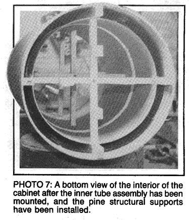

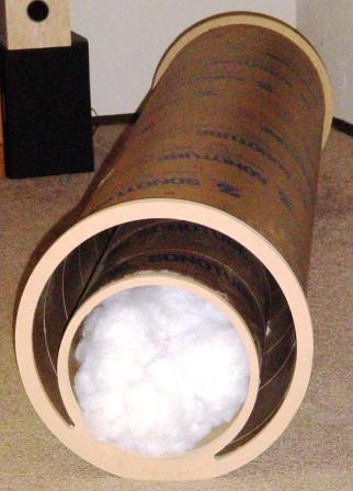

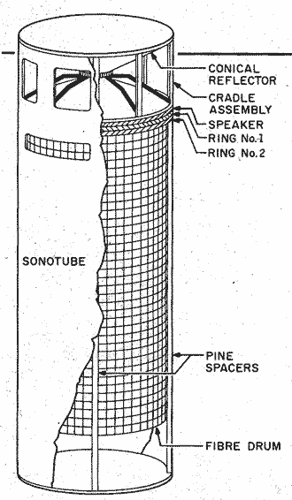

Using a plastic or cardboard tube as the outside for a speaker, is quite an old idea. Going back to at least the 60s, quite possibly earlier, with many examples and much inspiration to draw from.
I remember one project that had the inner tube cut at an angle, lengthwise and glued to the inner wall of the big one.
That resulted in in crescent moon shaped cross section. This might be beneficial for absorbing the high frequencies without too much stuffing

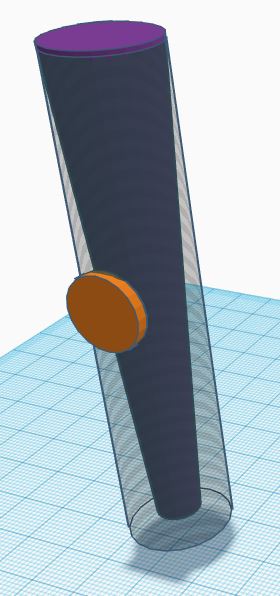

Evening All
Thanks again for the feedback. Couple of answers to specific questions/comments raised.
Absolutely. I actually accounted for this in my original concept by increasing the overall diameter of the outer pipe in the section where the driver box was located. I had to google how to calculate the area of a segment of a circle (long time since my school days) but was able to find the overall increase in ID was not actually that much to account for the area being consumed by the driver box. I then used an approximation to curve the ID back to the point where the driver box finished. You can see the effect as a bunch of circles if you look at the bottom view of the driver box in my original post.
Nope, not sure at all. The only thing I have guiding my choices on line length was the BIB calculator spreadsheet. I do like the idea of linking the line length to the fundamental resonance frequency of the driver as it "makes sense" to me, but have no grounding in the science to know if it could be longer or shorter.

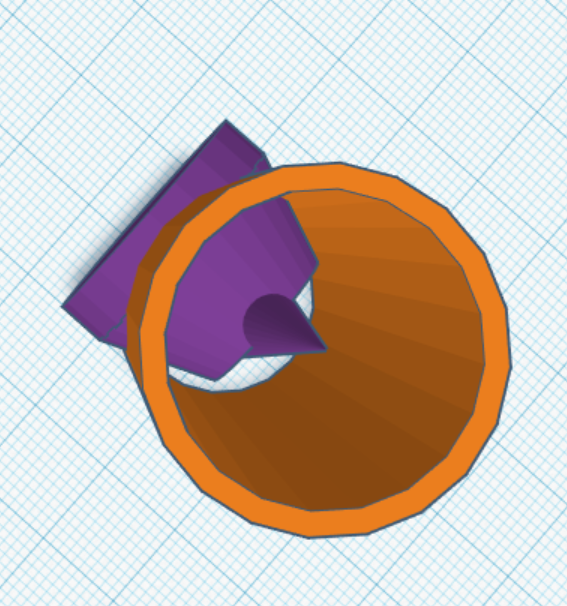

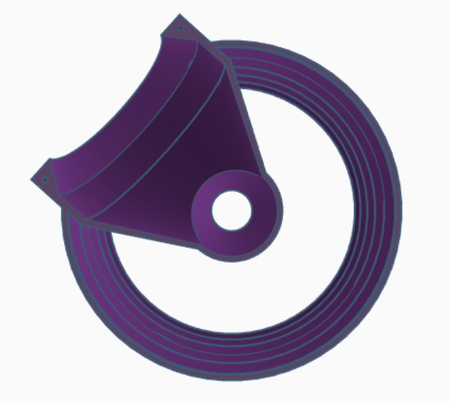

Based on the feedback and an attempt to read to Martin King's Quarter Wave Speaker Design info (of which I would say I probably comprehended a good 30%) I have come up with the following changes to iterate the design.
Remove the taper from the back of the driver box. Project rear of driver box to cross entire diameter of outer pipe. The thinking here was based on looking at some of the back loaded horn designs which have a driver box with a relatively small transition (cross-sectional area wise) into a horn (or in some cases a TL). By running my cone through the middle of the driver box what I effectively end up with is a expanding open TL (not expanding to horn proportions) from the bottom of the driver box, and a short closed tapered TL from the top. I did note the comment that the short line is probably not doing a lot sonically. The primary reason for keeping it is to provide the taper effect in the top section of the outer pipe (and I've grown to like it from an aesthetics perspective).
The thing this does do is require a much more aggressive flare of the outer pipe around the driver box to maintain the cross-sectional area of the outer pipe at this point in the line. That again should be fairly easy to design with a little geometry tinkering and CAD work.
I have attached a couple of pics of what I think this could look like. The flare in particular will need a lot of work and I think could end up looking much more spherical in nature. Will need to run some number of cross-sectinoal area consumed by the driver box.
Couple of questions/thoughts:
1) If using this driver box approach (as employed in BLH design) is there any guidance around box volume or minimum dimensions of the box?
I've looked at lots of designs and some of the driver boxes are quite small with the rear panels being very close to the back of the driver, but can't see anything to provide guidance on size.
2) What is the best shape for the back of the driver box?
Most obvious choices would be completely flat or following the curve of the outer pipe. But given this piece will be 3D printed I could do something more exotic. Perhaps a saw tooth deflector (something I have seen in some BLH) or an egg crate style. I could even open it to the rear and simply have an open stuffed tube (like the LX mini driver pipe). I guess the goal here is dispersion or absorption of the back wave. Perhaps this is something I could make a few designs and experiment (once the main concept has been proven).

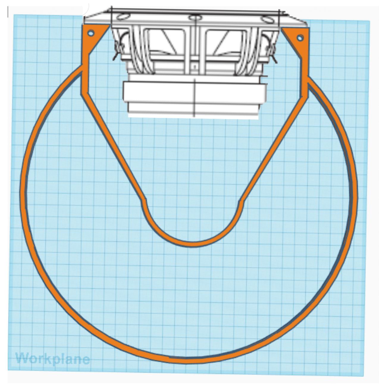

You mean like this?
I laughed when I first read your comment but I think you might actually be right.
The only challenge I can see is that at the Zdriver distance from the top there would only be about 6.5mm between the ID of the outer pipe and the OD of the inner cone (based on some quick rough calcs). So I would need to build the driver out from the pipe a bit.
Need to think about that one some more.
Evening All
Apologies for the lack of updates on this thread. Long story short, the BIB Pipe project is on hold for the moment. It has been a very hectic summer which included moving house which not only slowed down my progress but also created some new priorities for solutions.
The good news is I have been working away on a 3D printed speaker solution which I intend to create a new thread for, but which is also giving me a ton of experience in 3D design and printing techniques.
Not wanting to be the guy with a ton of ideas that never follows through, I thought I would hold off on creating a new thread until I had some progress to show.
Attached are a couple of pictures of what I have going on. Once I get done with this project, I plan to return to the BIB pipe design and apply some of my learning. Plus I have about 2 months worth of 3D printing to complete this project so may get a bit bored.
I didn't get any significant testing done before the move, but did find some alternate candidates for cheap outer pipe material by using Sonotube (a concrete forming cardboard tube) which I believe has been used by some in the community in subwoofer type applications. I think this could provide a cheaper solution, particularly for larger diameter pipes.
Thanks for the interest and I will be sure to get back to this one once I get done with the other project.

...but did find some alternate candidates for cheap outer pipe material by using Sonotube...
Many projects have been based on pipe. Sonotube does not like people using their brandname for generic purposes :^) There are lots of sizes and brands of cardboard concrete pipe forms. They work well. PVC pipe is better but, unless you can score a free surplus bit, is pricier.
