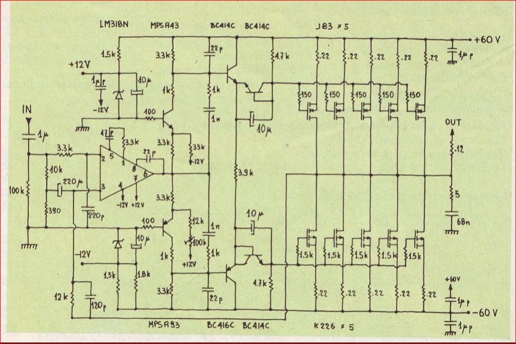

I have a Musical Fidelity A370 Mk1 that I have had from new - it hasn't had any work done on it. I mothballed it a while back as a refurb project because of strange noises (even stranger than usual) through the speakers after switch off and unpleasant hot smells (which I now think were due to dust).
I've opened the amp up and found the forum here where there seems to be some good knowledge about the amp, especially https://www.diyaudio.com/forums/solid-state/139711-musical-fidelity-a370.html.
My plan is to replace the big power supply electrolytic caps (following the advice on the A370 thread) but I have a couple of questions. I am a (digital) electronics engineer so have a reasonable range of test equipment.
1) The amp boards have a number of electrolytics caps on them. Electrolytics in seem to have relatively short lives compared to other component types so should I replace all of these?
2) In the A370 thread Don / AMV8 and Jez talk about adjusting the bias. There is a 100K preset pot on the amp boards which I guess is the bias adjust but I don't want to randomly turn the pot, presumably there is something I can measure. How do I set the pot 'correctly'?

What's there is just a hand drawn schematic, much the same as any other MF design of the era, with an LM318 input stage followed by a discrete BJT VAS and 5 pairs of complementary Hitachi lateral mosfets (obsolete H-PAK plastic types 2SJ83/2SK227)
The solitary adjustment pot appears to control DC offset rather than bias and considering the high current of class A operation, it would be smart not to have that amount of current adjustable.

The adjustment pot is for the bias, I built a P170 clone some time ago and recently a discrete version of the circuit. The P170 just does not have the driver transistors as the gate source capacitance can easily be driven from the op amp as it’s only a single pair of lateral FETS on the output stage.
I stand corrected if that is in fact a bias pot. but how would offset be adjusted, if not by swapping components in the production line? Then it probably also requires the same parts swapping process whenever semi replacements are necessary.
A class AB amplifier certainly needs bias adjust but I would have thought it unnecessary for class A, where fixed resistors are generally fine, cheaper and superior for reliabilty. If it's only a partial class A or high bias class AB design, it becomes arguable whether bias adjustment is a wise inclusion or not because there is a likelihood of overheating and serious damage in the hands of unwise tweakers.

Quite so and no problem with questioning. For starters, small class A designs like JLH's 1969 design and some of Sugden's commercial offerings can certainly be adjusted from modest levels to full class A bias.
However, if I were concerned at all about the effect of DC at the output of a balanced rail supply amplifier, I'd hope for either a blocking cap, DC servo (nulling circuit) or adjustment pot. to reduce it with certainty to <50 mV. I wouldn't trust the 5% tolerance carbon resistors in Sugden's early designs, for example, to achieve that without trimming.

Think of it as a boosted output op-amp, the op determines the offset, which in terms of the input bias currents, offset voltages and feedback resistor values adds to to the grand total of sweet FA.

Yes, that's all there was at the site. The pic. looked hopeless for any reference use. To the matter, bias is measured (calculated actually) by measuring the DC voltage drop across any resistor in series with this current. i.e use Ohm's law, I=E/R with any sort of calculator if you need to. Suitable series resistors for testing bias are the 10 x 0R22 cement types connected to each power Mosfet source pin.
There is a problem though, as there are 5 parallel complementary pairs of Mosfets, each Mosfet with its own source resistor. So there are 5 parallel currents to determine and add up before you arrive at a total bias current. Or you could assume that the currents are approximately equal and determine the current through one resistor in a pair and multiply it by 5. This is probably more than adequate accuracy for Mosfet bias setting but check the other 4 pairs too and select a median current pair for more precision if you wish.
Regarding Mosfet bias, let's be realistic. Unlike BJTs, the bias current is arbitrary and the more the merrier for lowest distortion, virtually up to max. current capacity but that's only possible with a massive power supply and cooling system. The limitations here are the small heatsinks and transformer so if you increase the bias for some reason, you must be able to dissipate the corresponding increased heat. With MFs notoriety for overheating, I wouldn't choose to do it but by all means measure what you have and compare total currents for each channel. I would not expect even 10% bias difference to make any audible difference, t.b.h.
MF must have made a decision to use the arrangement they did based on temperature, I'd suggest. So you'll need to determine what the factory setting was and how it was set during production to ensure you don't overheat and cook the amp. or underbias it such that sound quality deteriorates noticeably.
Personally, I would not touch what you have unless there has clearly been some alteration or significant change since new. Old amps deteriorate with years of heat cycling and adjustment pots are cheaply made, particularly fragile components, so take care if you must make adjustments.

I meant to describe the source resistors above as wire-wound though they are still coated with cement-like high temp. insulation. Note that actual component values used were often different to the spec. and different from the schematic, batch to batch. (That's MF for you) They are the green tubular resistors shown above or below each power mosfet in this preview - click on for a larger image: Heres the amp board, the short lifespan... - Audio Tech Service Network | Facebook
