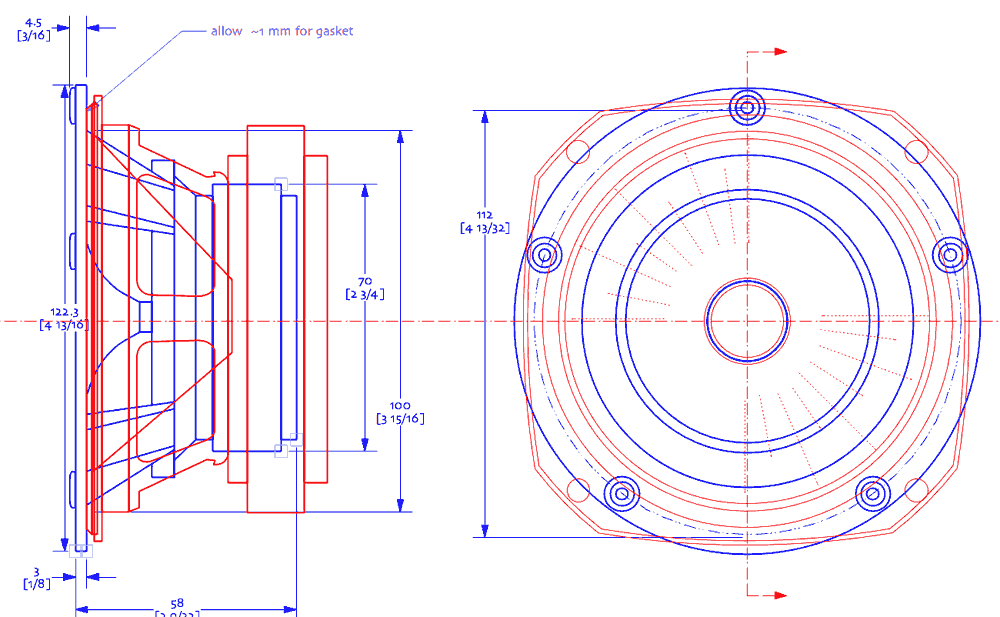

All the mentioned drivers are nominal 4”, the FE126 4.5” so youneed to check the thru hole.
Could you elaborate on what I would need to modify in order to use one of the mentioned drivers?

[/quote]Could you elaborate on what I would need to modify in order to use one of the mentioned drivers?[/QUOTE]
I use the driver drawings to judge how easy it is to retrofit a driver that uses no or a different rebate.
The new Pluvia 7 basket does not require a rebate, you are looking to see if it adequately covers the 126 rebate (if not it will need filling in, but the cutout also needs to be a size that is close enuff.
Red is FE126, bue is P7.
attachment.php
Looks like the cutout migh need a touh of rasping, and the corners of the fE126 reabate would not be covered, so:
1/ fill in the rebate (messy if you use something like bondo
2/ get the router out and add sufficient rebate (at the FE126 depth) to accomodate the parts of the P7 that reach beyond the FE126 rebate
3/ nuclear option. Cut a much larger hole in the baffle and add a supra baffle
dave
