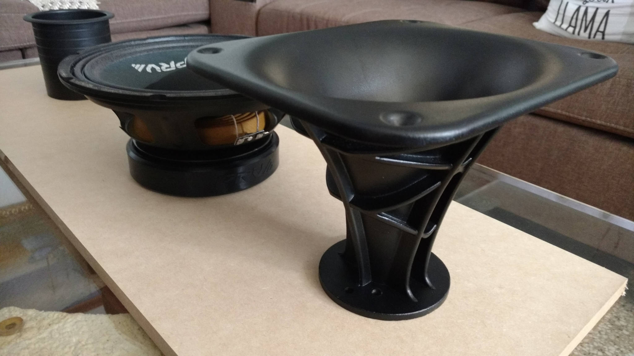

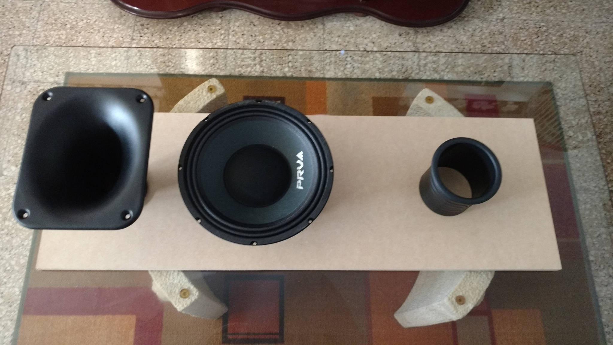

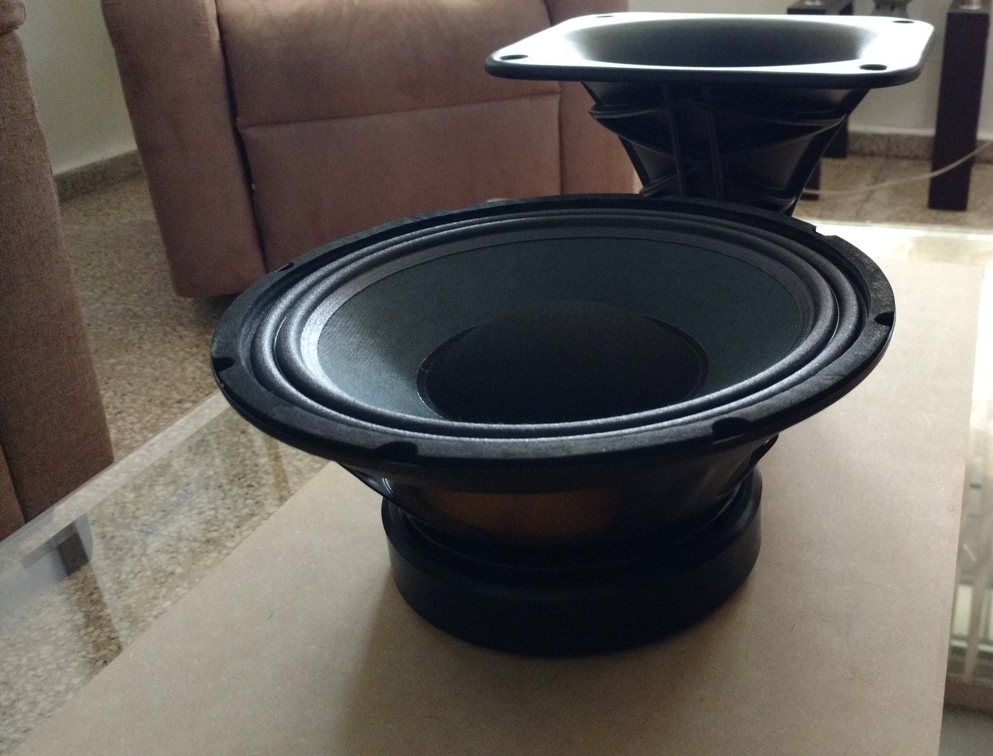

The drivers/parts of my choice are as follow:
FaitalPRO LTH102 Tractrix Horn.
B&C DE250-8 CD, (optional: any suitable/tested clone).
PRV 10W650A Woofer, (optional: Eminence Delta 10A).
Audyn Q4 33uF 400V MKP, (CD protection capacitor).
Speaker Cabinet Port Tube 4" ID x 4-3/8" L, (~3.88" ID x 2.75" L cut).
Neutrik NL4MPR 4-Pole Connector.
Penn-Elcom F1686 Rubber Foots.

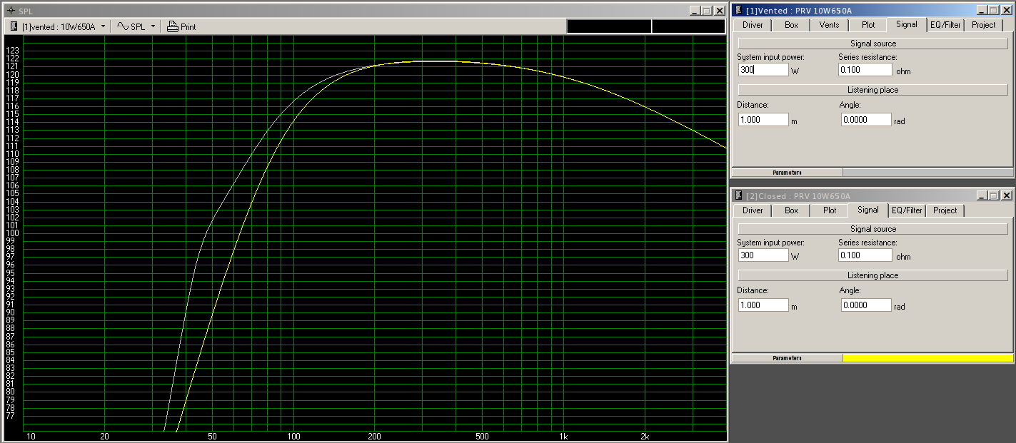

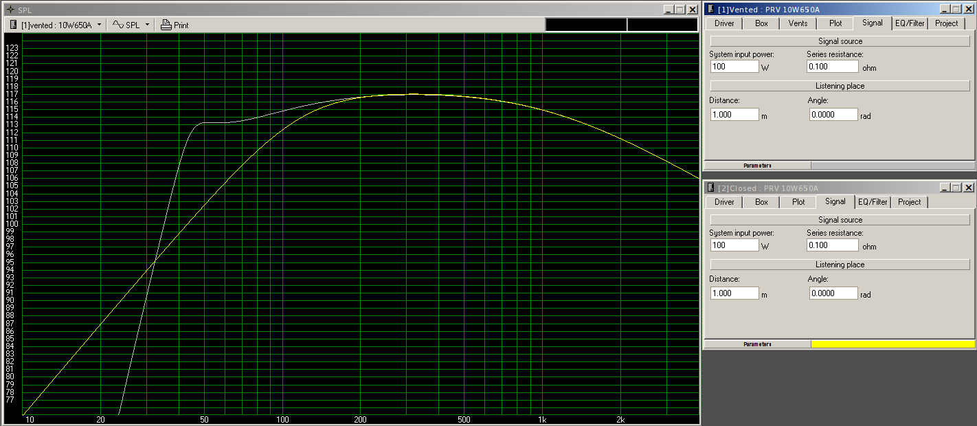

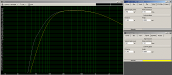

Some WinISD modeling of the project
F3 comparison vs sealed enclosure:
SPL with just 100W, 30Hz LR4 HPF on the ported speaker:
SPL with 300W, 80Hz LR4 HPF on both speakers:

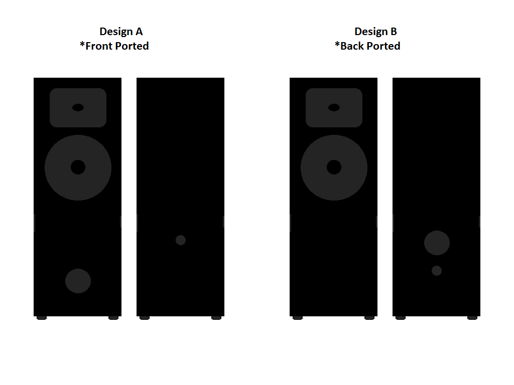

The wanted front ported black-matte finish:

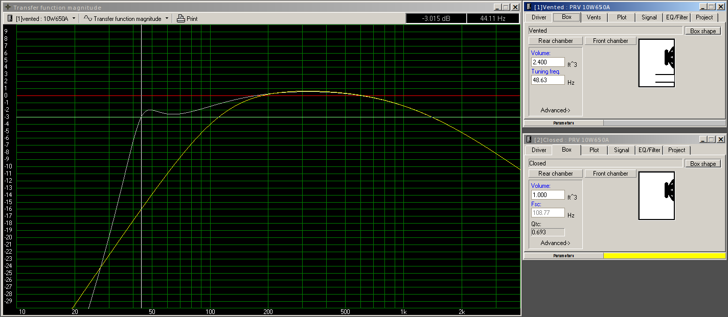

The $66 10" PRV 10W650A is not a woofer.
You will not get deep bass with Fs=72Hz and Qts= 0.46, even in a large volume box.
Optimum Cabinet Size PRV 10W650A (determined using BassBox 6 Pro High Fidelity suggestion)
Sealed Volume 11.03 ft.³
Sealed F3 191.7 Hz
Vented Volume 40.71 ft.³
Vented F3 52.81 Hz

The $77 12" Dayton DS315-8 paper woofer with Fs=25Hz is popular because it is a true midbass(F3=37Hz) which matches the SEOS12 waveguide depth, and when slightly counter sunk into the baffle, also closely matches the SEOS15 and $14 PRV-WG35-25 waveguide depths. The flat impedance and extended low frequency SPL curve on the $65 Peerless DFM-2544R00-08 compression driver simplifies 1000-1200Hz passive crossovers.
Optimum Cabinet Size Dayton DS315-8 (determined using BassBox 6 Pro High Fidelity suggestion)
Sealed Volume 0.93 ft.³
Sealed F3 60 Hz
Vented Volume 1.9 ft.³
Vented F3 37 Hz

Hi LineSource, thank you for your suggestions and observations about the bass response and FS of this drivers, however since I have a local distributor of this brand I've listened few of the 10" and this drivers drove me attention from the first time I've listened to them, as they can play loud and clear even when pushed, hence I've selected the same drives for this speakers project.
I agree this speakers will be a bit bass shy and will struggle playing below ~50Hz, however this speakers will be crossed at 60Hz LR4 and mated to an existing DIY UM18-22 5FT^3 sealed subwoofer temporarily, but they will be actually crossed around ~80Hz LR4 when mated to two B&C 21SW152-4 11FT^3 subwoofers tuned to around 19Hz, but this is another project, the system is for 99% music listening.
As fort the DBX DriveRack PA2 alignment delay, yes it provides up to 10ms alignment delays per channel, additionally 8-Band PEQ's with bell, low and high shelf for speaker tuning, also several handy processors.
Again thanks for the Dayton DS315-8 recommendation, however I'm more of a Pro Audio driver fan, also want to limit the mid/woofer size to 10" max, as the only spacer left of my room is reserved for the two 21" future subwoofers project.

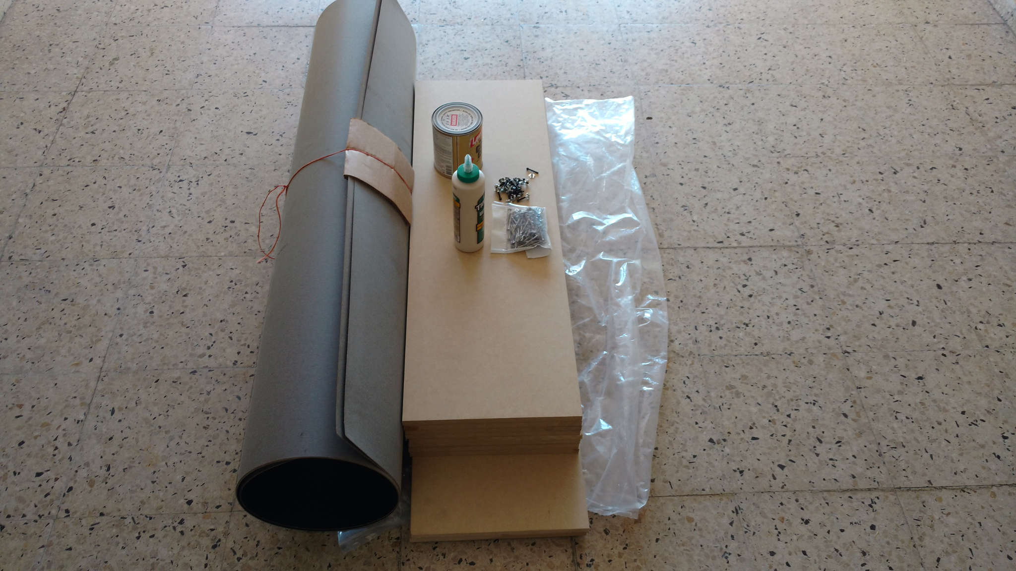

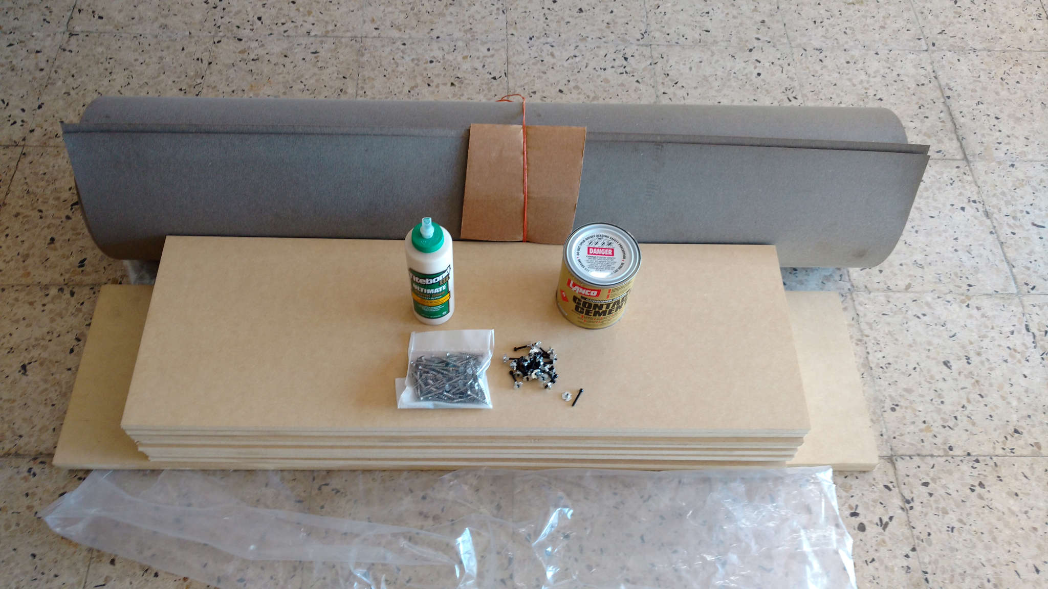

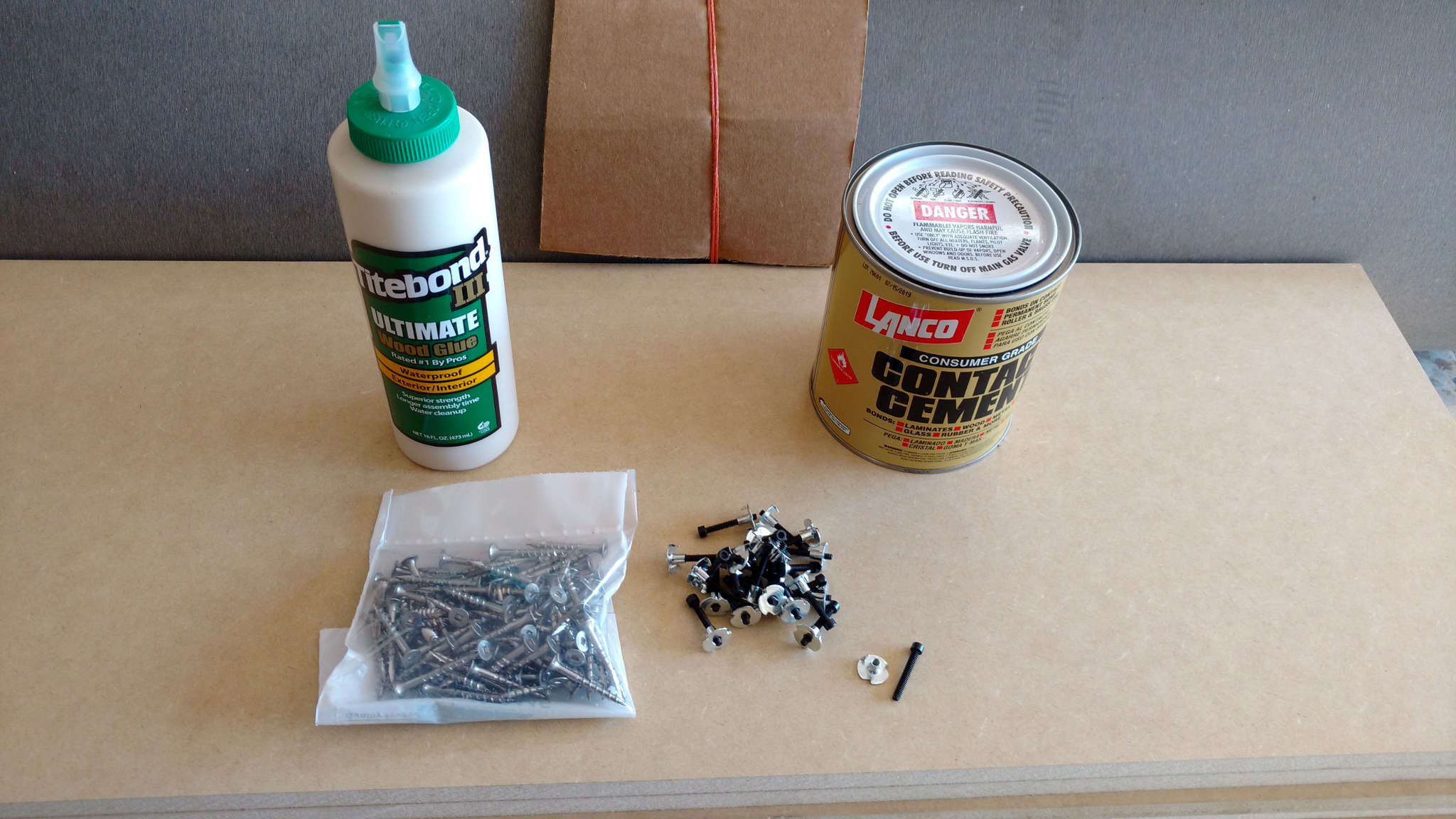

Here are some of the materials I will start working with tomorrow, I still have to cut the 8 pieces used for the top, bottom and the 2 windows style braces per box, one between the horn and midwoofer and one between the longest box part to minimize resonances.
I will put Epoxied 6-32 T-Nuts for the midwoofers(this stamped steel woofers have small mounting holes), with Hex socket-head black oxide screws, and same T-Nuts for the horns, but with Alloy Hex flat-head black oxide screws.
I also have some 10-32 Hurricane Nuts that are much stronger, but they looks too large compared to the tiny mounting holes this woofers have, and I didn't liked how the bulging woofer flange looks after inserting such screws with large head caps on my previous attempts.
More to come soon.

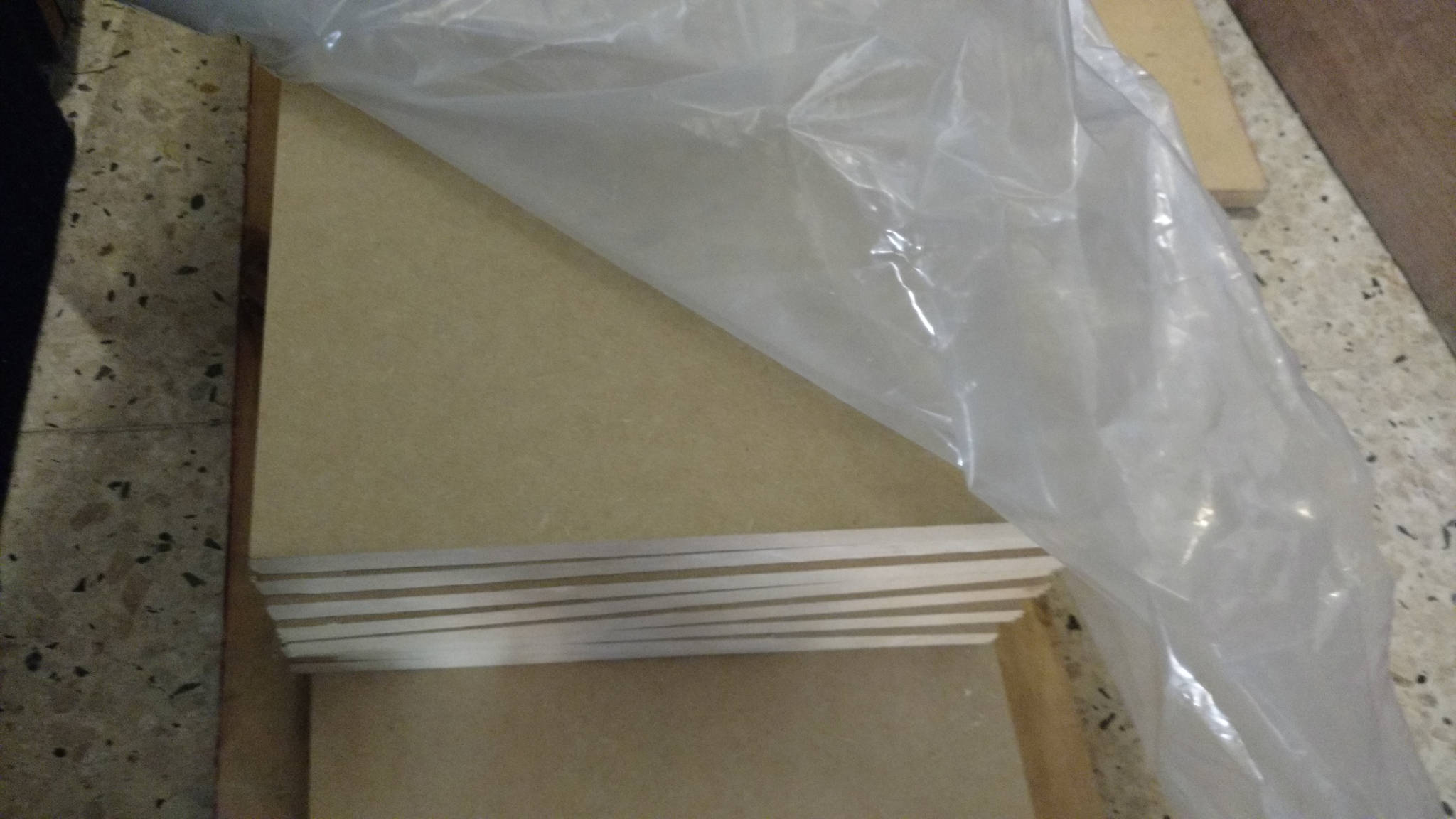

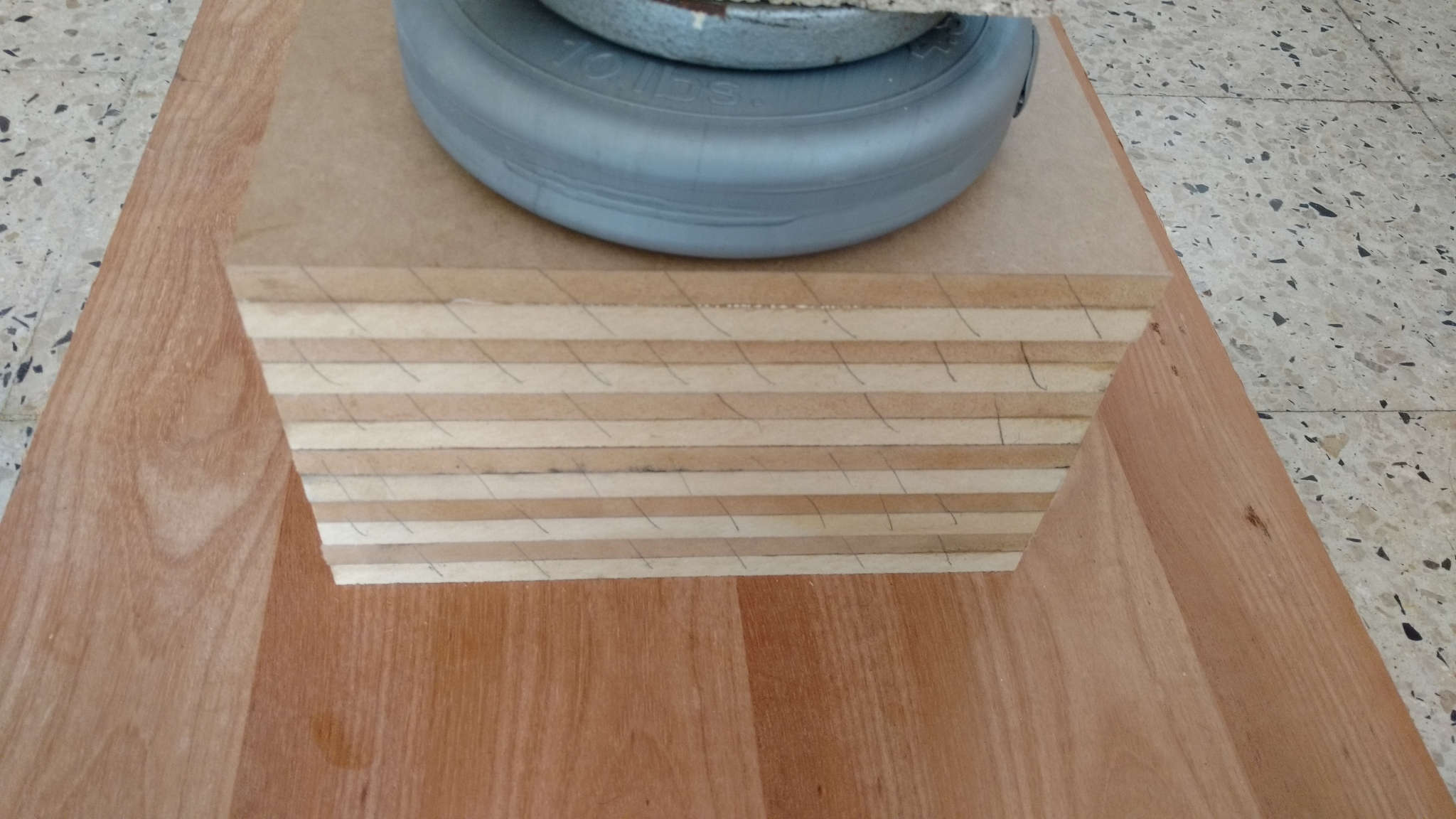

Update
Usually I'm that guy who start a wood project with some disasters before anything else.
Unfortunately the MDF sheets the guys sold me at the local store were 5/8"(16mm) instead 3/4"(19mm) which is my preferred thickness for speaker projects, somehow the guy who grab and cut the MDF sheet did a mistake, but I was confident enough to put the pieces in the trunk and sign the agreement without check the material, so shame on me.

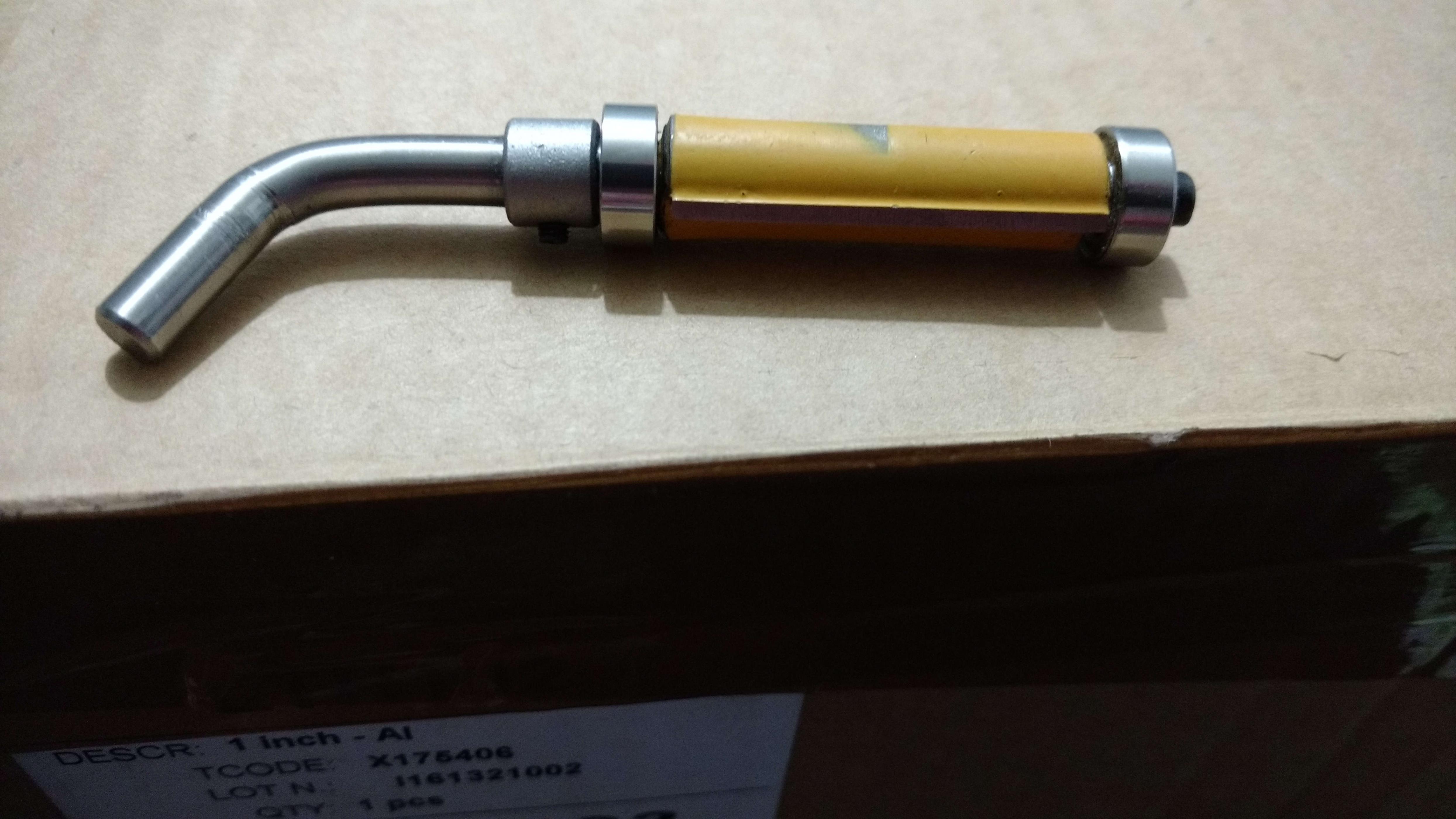

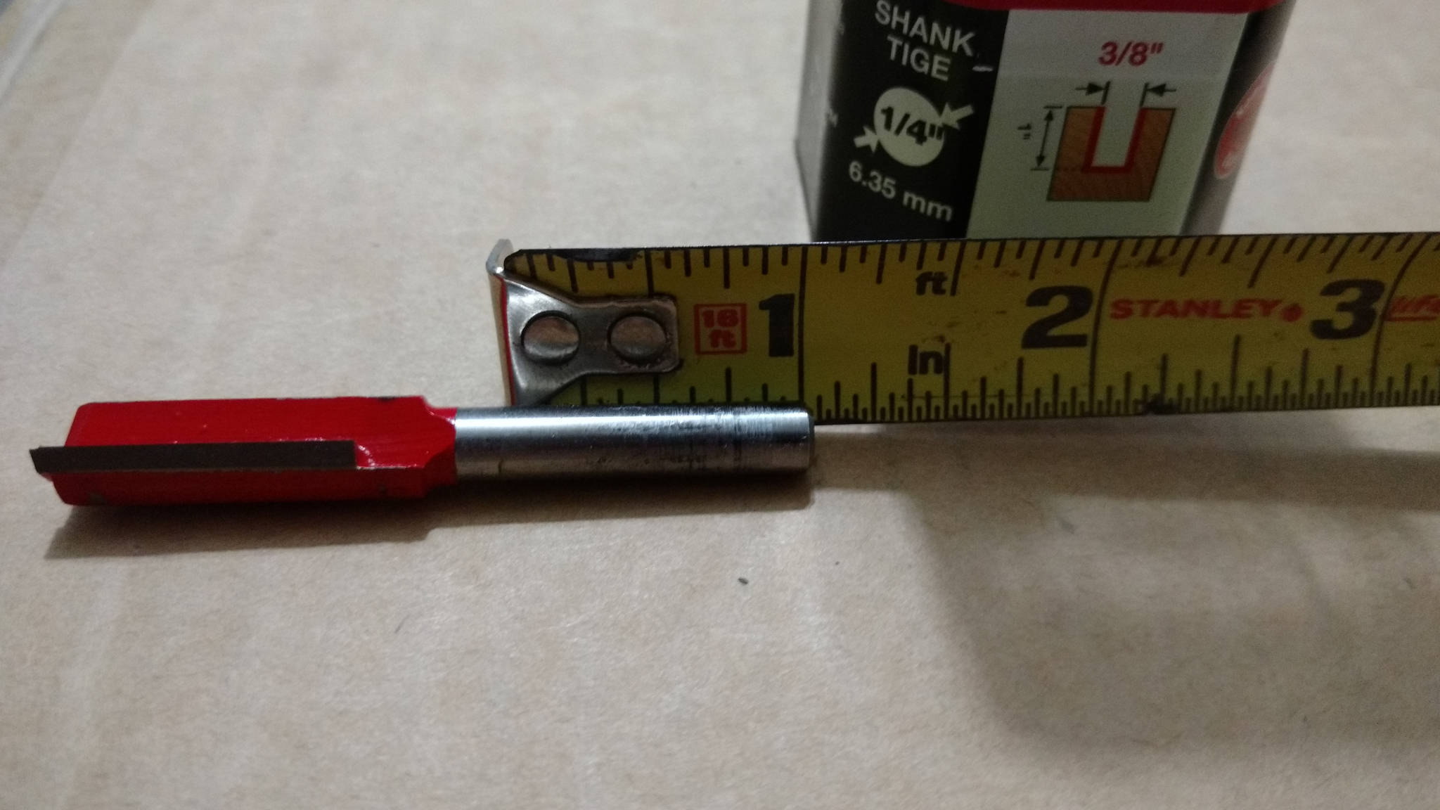

Secondly, as part of the project goal, I did purchased some cheap router bits on eBay with top/bottom bearings to save some bucks, but it turned that the 1/4" router bit did bent and destroyed my router plastic base with a big bang, glad I always wear protection glasses when working with power tools.
Fortunately I could easily fix the router base with a 1/4" panel I have lying around until I find the original, however at this point I'm not sure If I should continue the project with this 5/8" thickness MDF .
Should I have to worry if I go with this 5/8" MDF for the boxes?, will the resonance be negligible if I use 2 or 3 windows style bracing per enclosure?
Sorry for asking such questions, I just like to overbuild my enclosures and that 5/8" MDF sheet still worries me a little.

Hi, since I already have this 5/8" MDF, and already cut, I just decided to go and buy another 5/8" MDF sheet to use double thick of about 1.25"(32mm), this slightly changed the box specs but in a really good way, the box stiffness will increase thus reducing the resonances, also I will skip the T-Nuts as there will be enough MDF meat for the screws to grab.
As for the Router bit accident, it turn out that those bits shanks are too long for my router(1.5"), preventing them to enter all the way down the Router collet letting about half inch out, hence the vibration increased rapidly bending the bit in a blink, so lesson learned and will stay with the shanks of 1/4" x 1" long which is the max my router can handle.
Regards

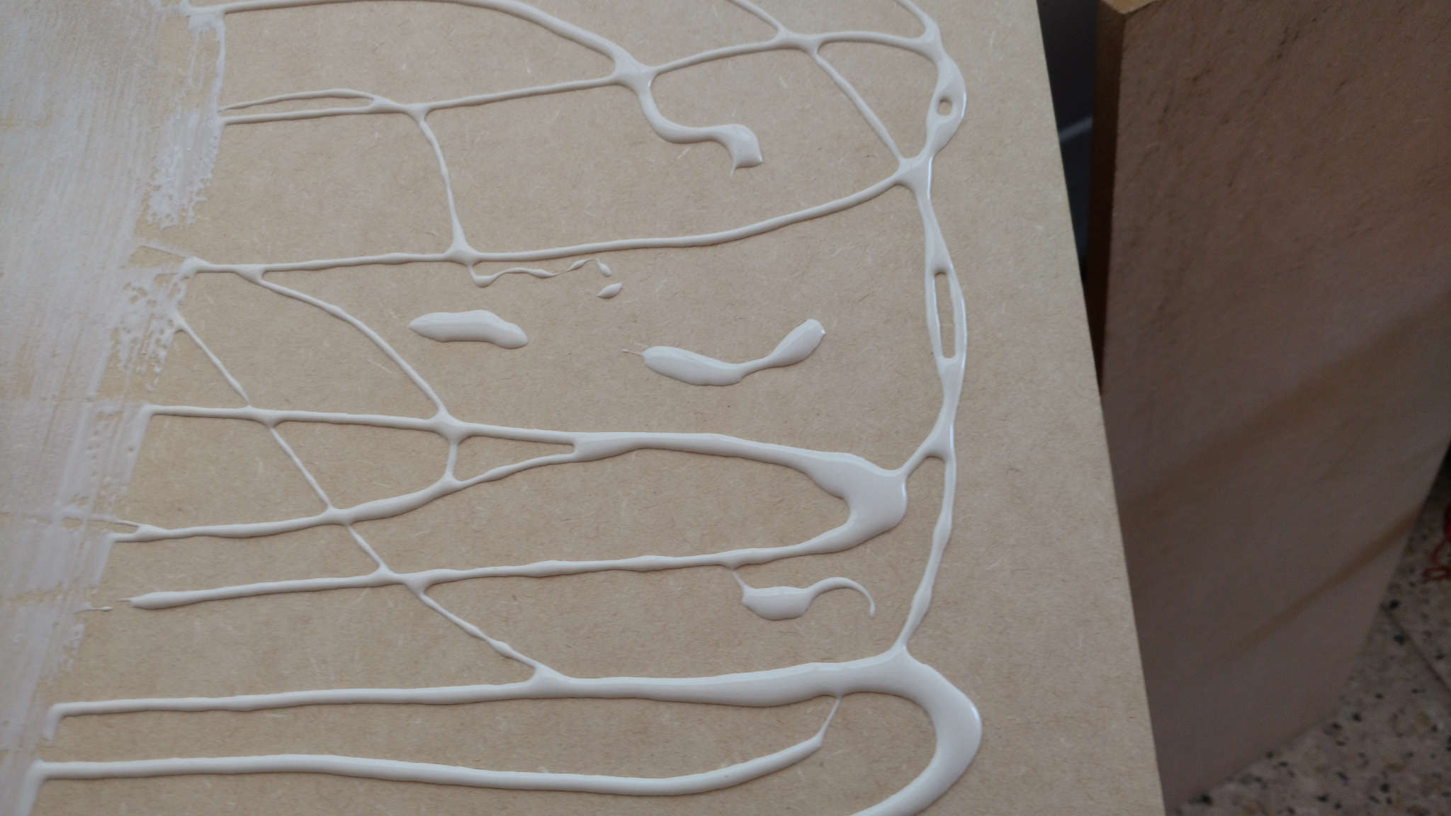

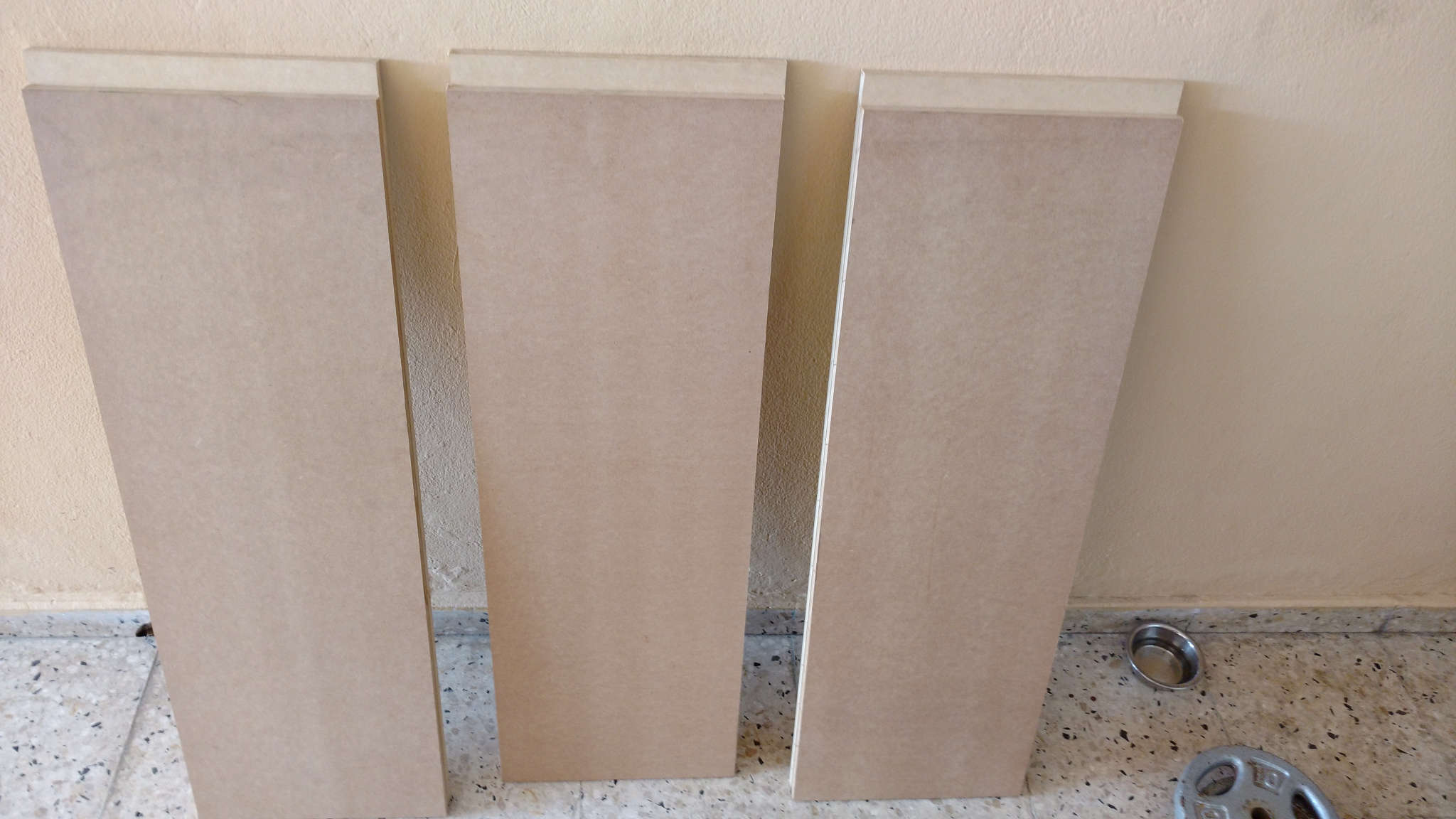

Update

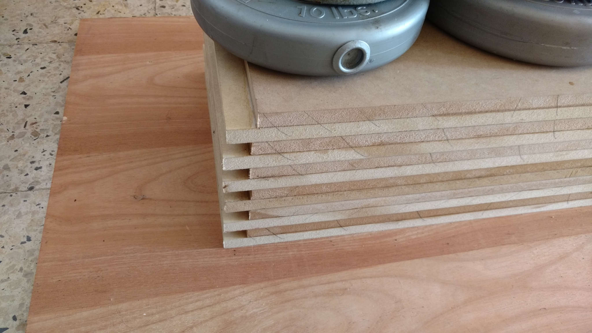

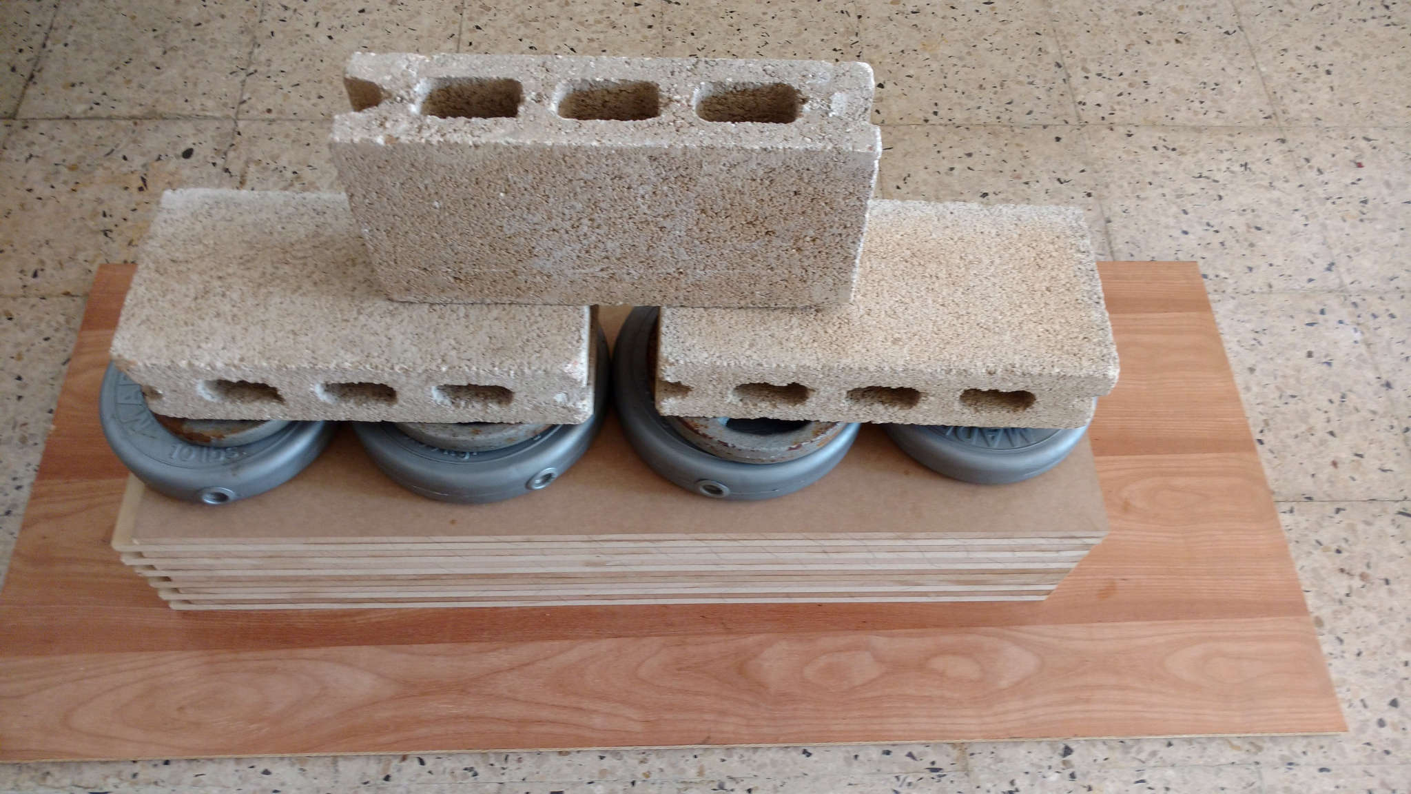

Hi, after thinking and playing around with WinISD, and since I'm a bit picky regarding speaker box wall thickness, I ended up ordering another same MDF sheet to make a 1.25" MDF sandwich plus 2 window style braces per box, so I just gave them the same cutlist for the cuts.
However, the MDF sheet was from a different manufacturer and it measured exactly the 48x96 unlike the previous 49x97 material, so unfortunately the speakers will be 36" tall instead the planned 37"(without feets), but I think is not a big deal.
The new box measures will be 36"H x 12"W x 14.5"D approximately(without feets and laminate), also I estimate for the box weight to be around 50~60Lbs without drivers and about ~70+Lbs after drivers, though I will take final weight after project finished if possible.
The MDF sandwich bonding is now cooking, but I will post more pics of the box progress soon.

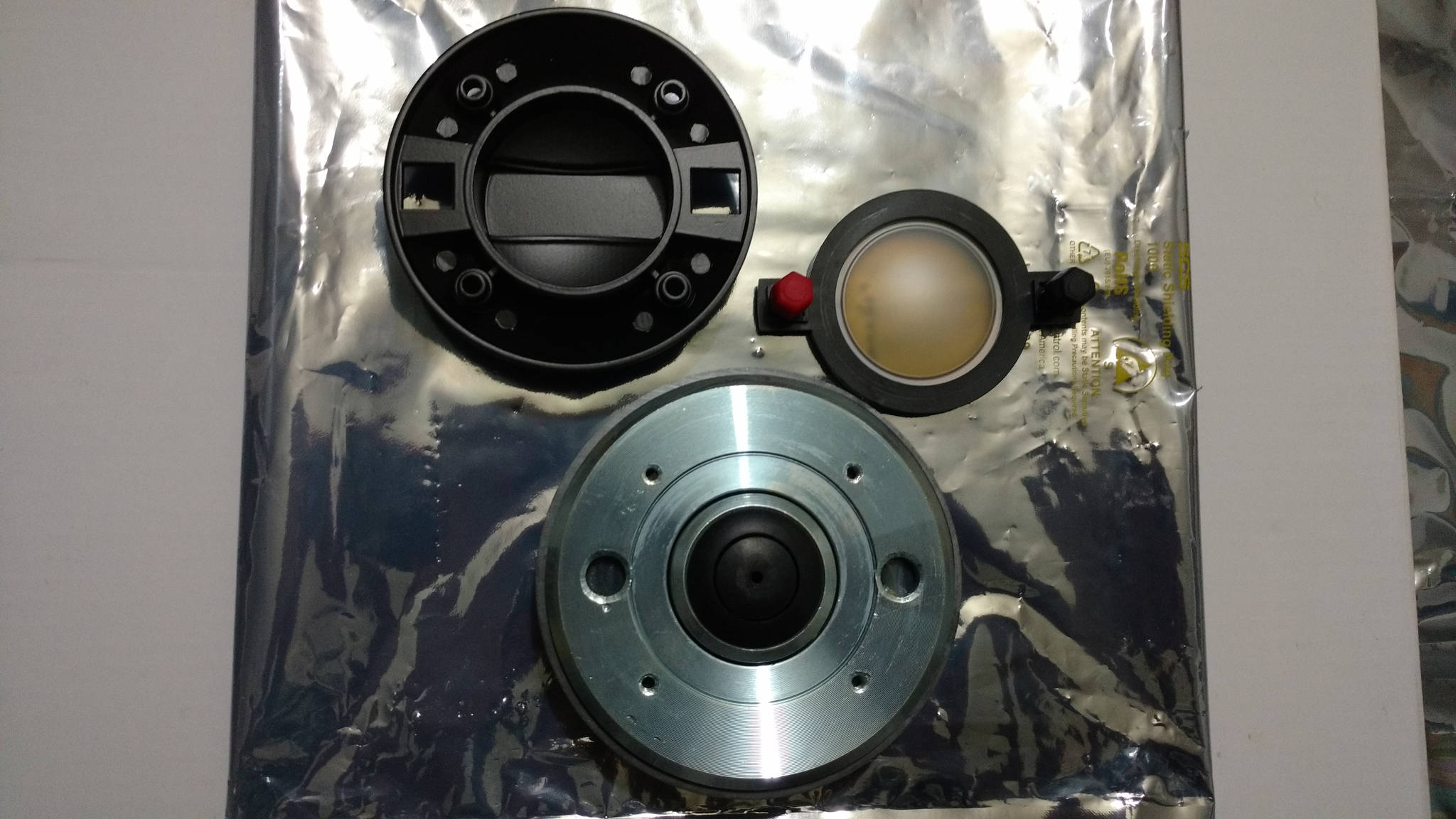

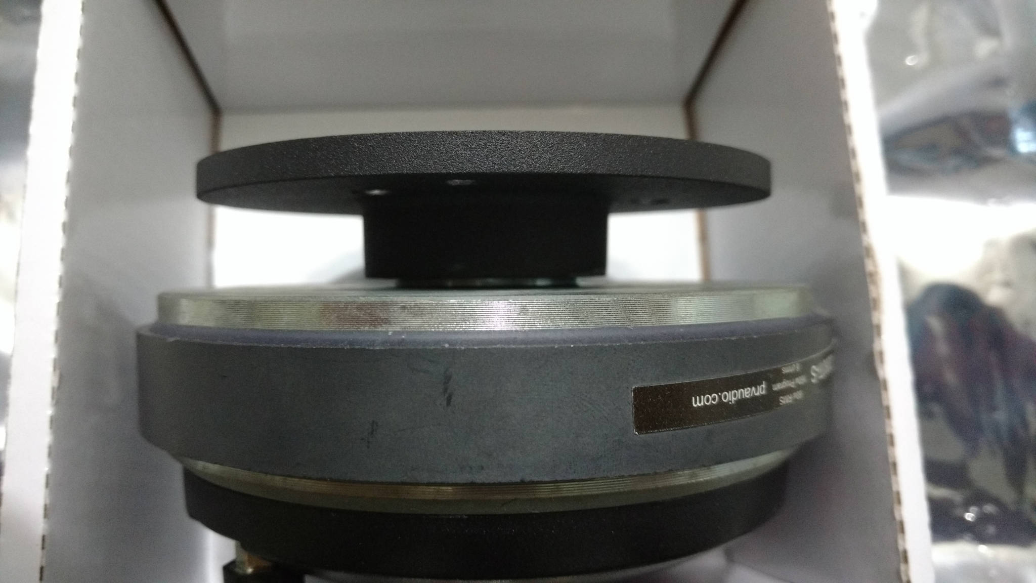

JRiv,
I see you have the MB Acoustics DE250-P clone. Did you measure these on the horn yet?
I got two of these last week and they were both so poor in their measured response on a SEOS-12 I got a full refund from the seller.
Just saying as it would be a shame if you have units from the same batch/problems.
Perhaps they'd be fine in a non-critical PA system, but for my home use the units I've measured were completely unviable.
Sorry to be a downer on your nice build. Good luck!
Cheers.

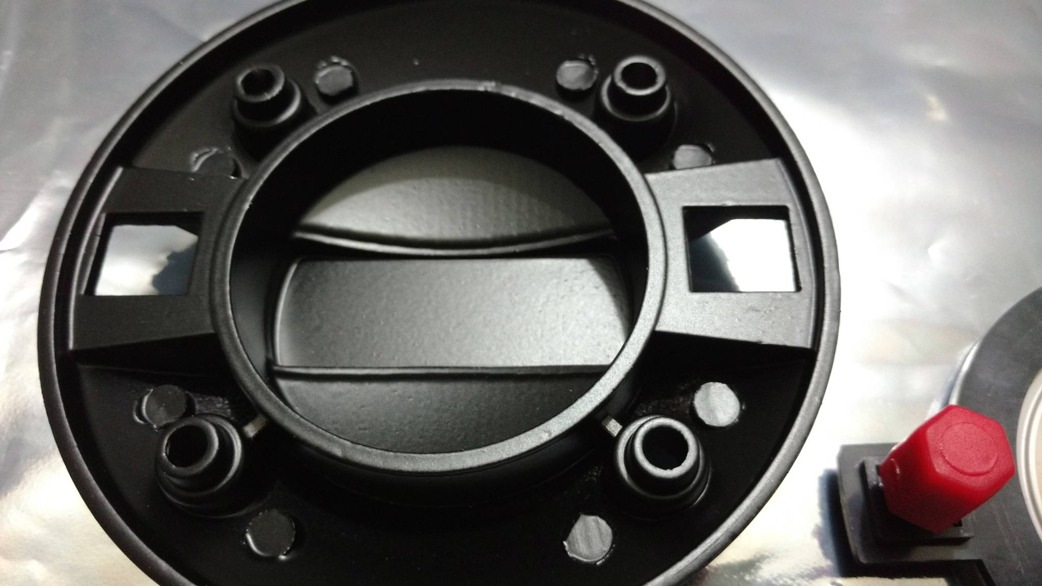

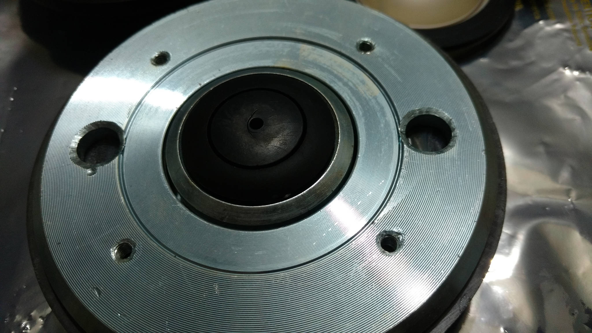

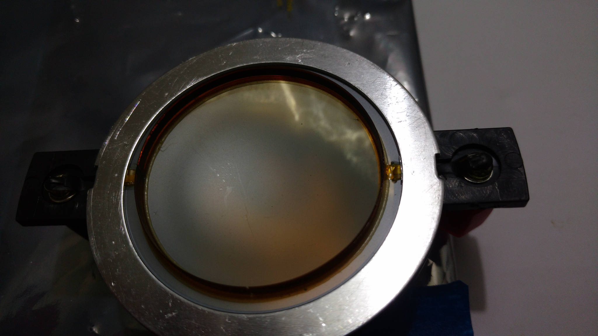

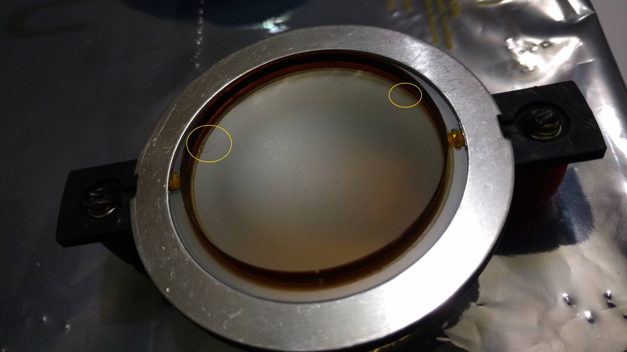

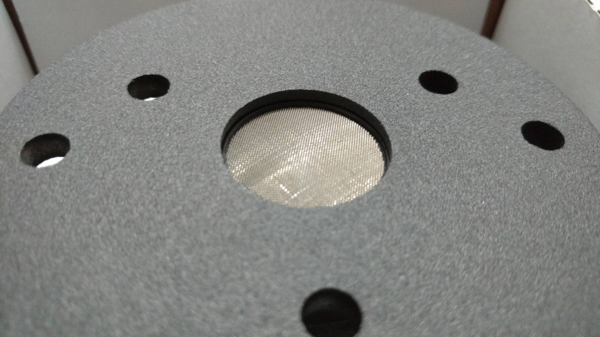

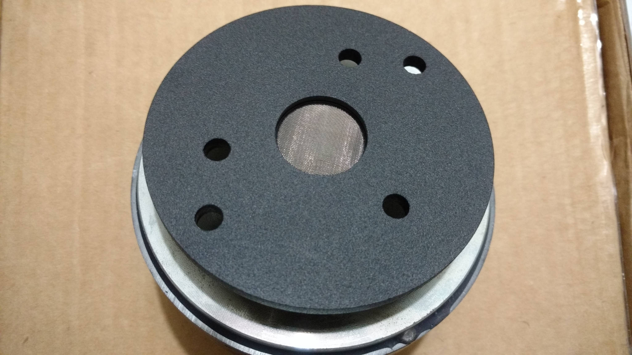

Hi Mazza, thanks for the input about the MB DE250-P clones, I originally wanted the PRV D290Py-B but it was unavailable at my local PRV distributors, then I saw this DE250-8 clones on ebay and after searching for info and measurements on this particular clones with very little results at that time, I decided to pull the trigger, although I was still in doubt about they sound and build quality. but I did a quick test by ear on the LTH102, and to my ear they sounded somewhat good with smooth top end, however this was pure speculations here.
I opened the drivers and they look exactly like yours, very poor machining on the screws and diaphragm connector holes, no foam pad in the back cup and the "Polyimide" diaphragm color is the same, plus I noticed some fine hairs of glue left-overs near the diaphragm VC that I carefully removed with an eyebrow tweezers.
I was about to take some measurements on-axis of both clones + LTH102 to see what they can bring, but after opening them I concluded to just buy the PRV D290Py-B or something else online.
Again thanks for the really useful information about this particular DE250 clones.

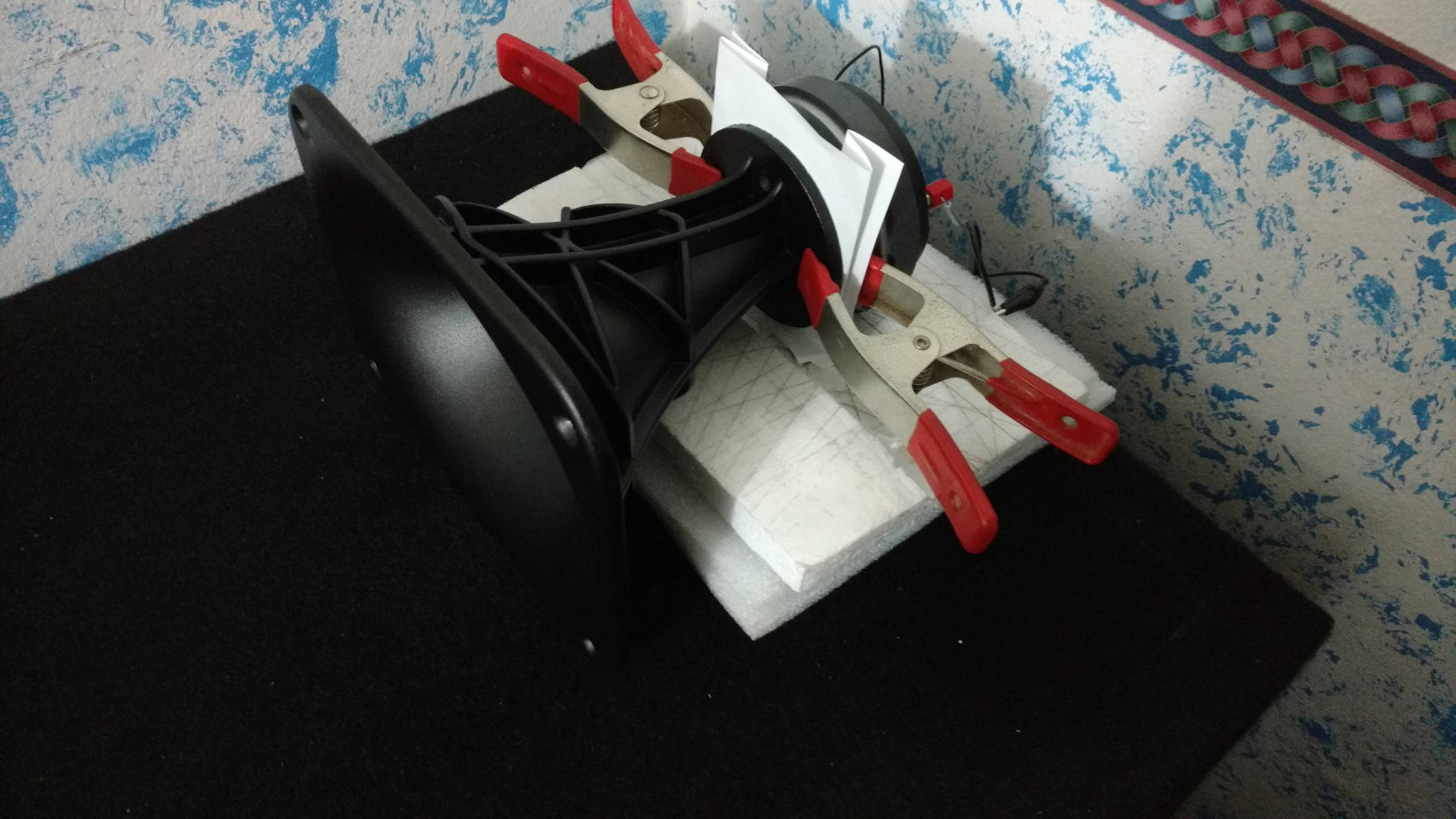

Try the Celestion CDX1-1745 it is superb!
Hi, ironically I did saw an eBay deal for two of this CDX1-1745 before pulling the trigger on the MB clones, so indeed it is one of the candidates I'm targeting right now, unfortunately PE does not provide Flat-Rate USPS services at the chekout so the shipping is mostly a dealt breaker on heavy items to Puerto Rico.
Luckily I've sold the MB DE250 clones to a friend starting in the car audio, but I have lying around a pair of the PRV D280Ti-S (from a previous build), and the Eminence S2B-A adapters I could use until I find a deal.

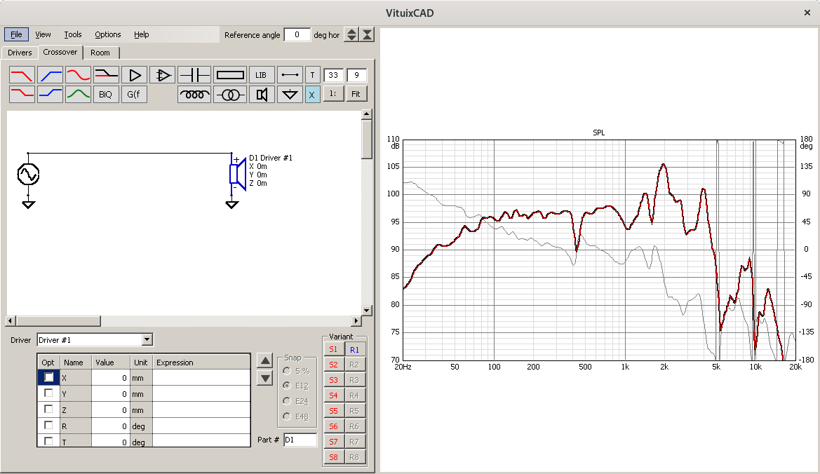

I will take some measurements on this particular combo, D280Ti-S >> S2B-A >> LTH102 to see if it can be usable at least to 1.8Khz or lower.
Regards

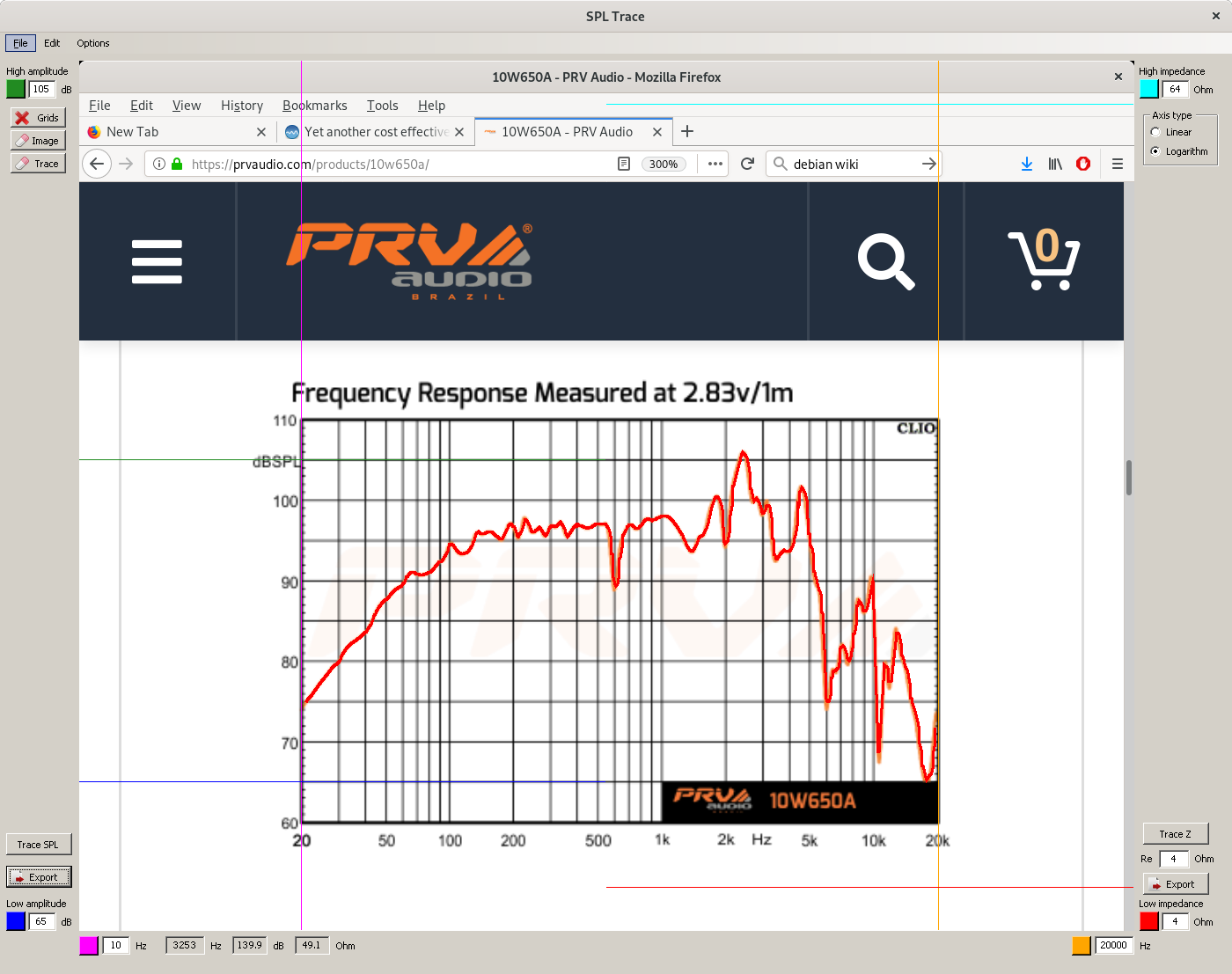

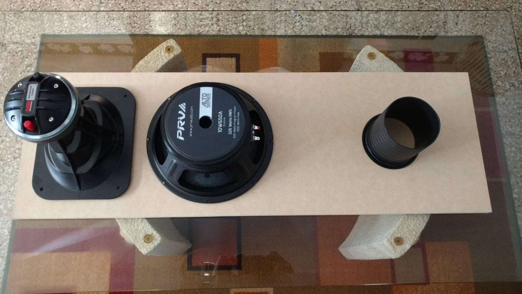

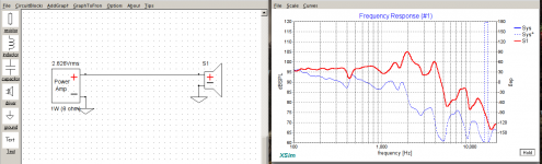

With regards to the PRV woofer. According to Sd, I would expect to cross near 1k3Hz to get 90 degree dispersion.
According to the breakup modes, I would want to cross firm near 1k3Hz to get all the usable bandwidth.
According to FaitalPro, LTH102 horizontal matches 90 at 1k3. Vertical doesn't reach 90 until 1k4, and pattern flip happens at 1k6.
This may be ok, and it is only 0.25 octave, so 1k3 is where it appears you should initially cross. The mouth is large enough to support the directivity in theory, but it remains for measurement to see whether the mouth wants an extension for smoothness.
BTW, nice Sankens

So I did some quick on-axis measurements off the PRV D280Ti-S on the FaitalPRO LTH102 using the Eminence S2B-A aluminum adapters at about 1 feet from the compression driver throat to the mic, also the horn and mic placement was far from ideal, and the window air conditioner unit was on, the results will be tainted with reflections noise etc., but just to get an idea until I can make proper measurements, I hope someone with more technical background with this measurements can tell me if they look ok or bad to tame.
All the measurements was done with 24db/oct LR crossovers and without the 33uF bypass capacitor:
What I noticed on that measurements is that when I applied a quick PEQ(the PA2 has 8-band/ch) the response flatten a bit and lifted the top end, so maybe with more effort they may be tamed, OTOH they don't like to go lower enough to reach 1.3KHz even crossed at 1KHz unfortunately.
Note that I've used a paper as gasket and some clamps for this quick test but the horn and CD throat was well aligned, I will use 1/16" thick neoprene pad with adhesive back to make proper gaskets if I go this route though.
Regards
They don't naturally want to go there. If you had a crossover simulator you could set them against a target response and push them into shape. At the least you could do it by sight working off a plot. It isn't yet sure what the smallest effective rolloff would be.
Thanks AllenB, that's indeed a great idea, I could simulate some in XSim if I could manage to get/generate the FRD/ZMA files for the PRV drivers, but I guess I will continue with the speaker project(can't wait ), then perform several measurements on REW with the combined drivers in the enclosure.
Regards
In case you want to start passive, I prefer to begin there too. Shaping the CD may take a few dB. ZMA should only be necessary for active if your amp has a non-zero output impedance, or you do something creativeZMA files
That's absolutely awesome AllanB, thanks a lot for the data file on this PRV woofer, I've been looking for it for quite some time, I did duplicated and renamed the files as FRD/ZMA extensions and XSim is happy with them.
I will try to take a better measurement of the D280Ti-S on the LTH102, with some pillows at the back and bottom of the measurement area to minimize the reflections, so I can upload a screenshot from REW, hopefully you can CAD it so I can have a better idea if they will integrate well with the 10" woofer at xover point.
EDIT: I've used your latest PRV10_Z.txt as .zma, and now I can see the impedance curve.
