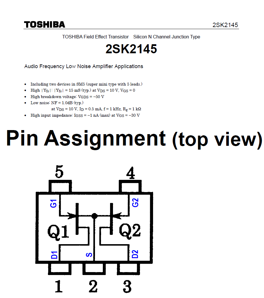

2 questions, how do you handle 2 transistors in 1 package, as an IC? Do you have a diagram showing the individual computer files associated with each device component? In the line of which computer file is associated with the schematic representation of a transistor in a circuit, which file represents the 3d display, etc. etc.

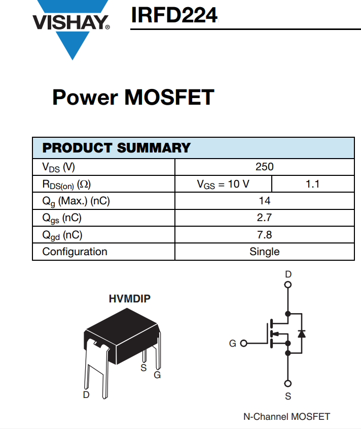

I suspect there are several ways to tell KiCad about a single package which contains two transistors. Here is the way that I would do it, myself, on a Toshiba 2SK2145 dual transistor (see attached image).
I would treat the 2SK2145 as a semiconductor device which happens to have 5 pins, whose names are G1, D1, G2, D2, and S. This is the same general idea that's already used by several other devices:
  • The 1N4148 is a semiconductor device which happens to have 2 pins, whose names are Anode and Cathode.
  • The 2N3904 is a semiconductor device which happens to have 3 pins, named C, B, E.
  • The IRFD224 is a semiconductor device which happens to have 4 pins, named G, D, S, D.
I would create a schematic symbol for the 2SK2145 which has 5 pins, and whose graphical drawing shows two NJFETs with common source.
I would create a PCB layout "footprint" for the 5 pin package in which the 2SK2145 is supplied, and store it in my footprint library. Done.
There may be other ways to do it in KiCad. There may be better ways to do it. But this is the way I would do it. Or at least it is the first idea I would try.

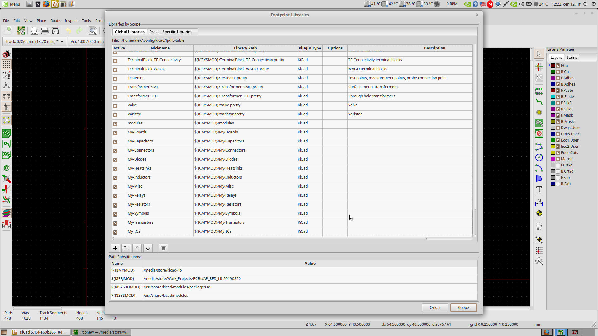

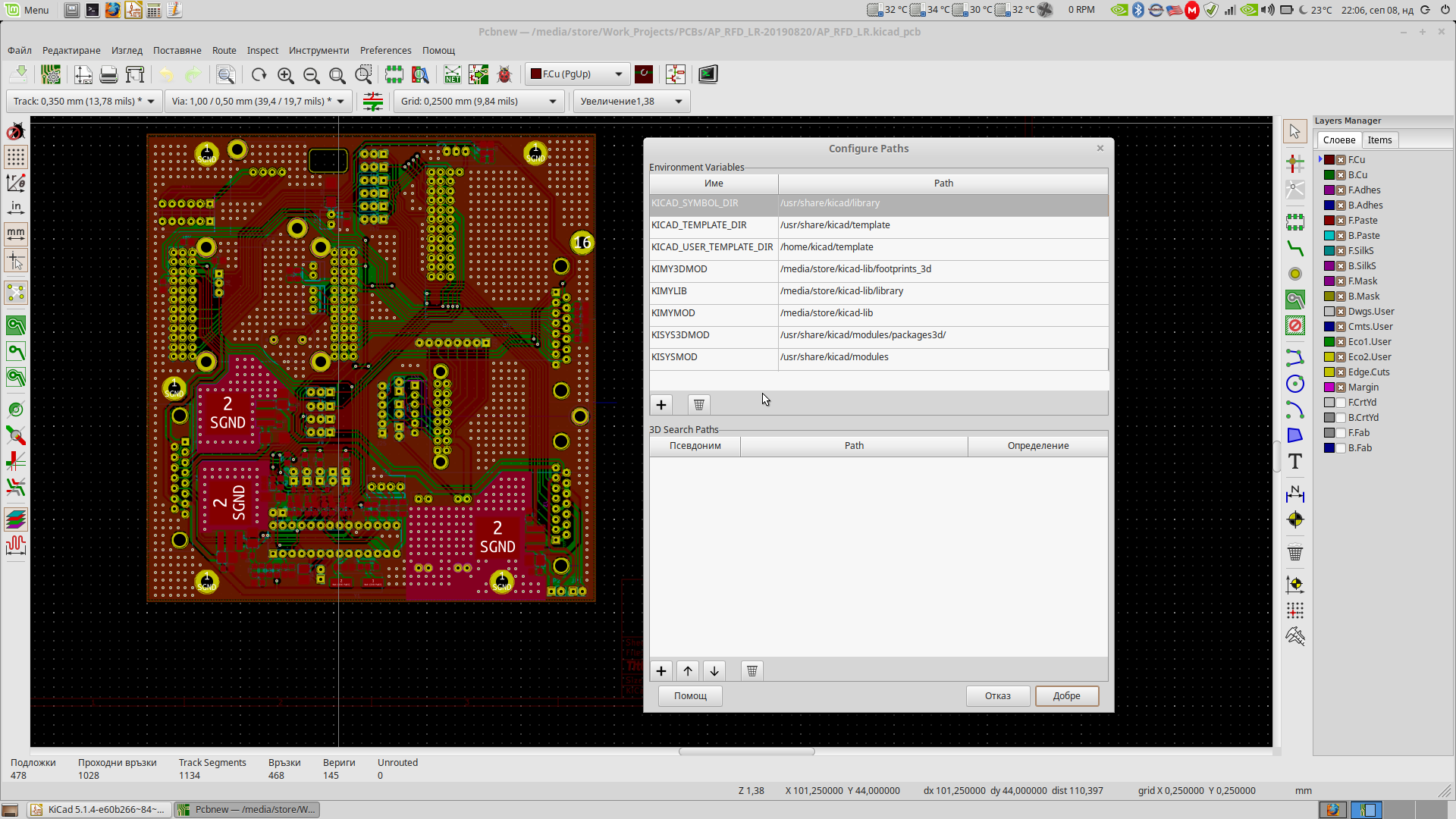

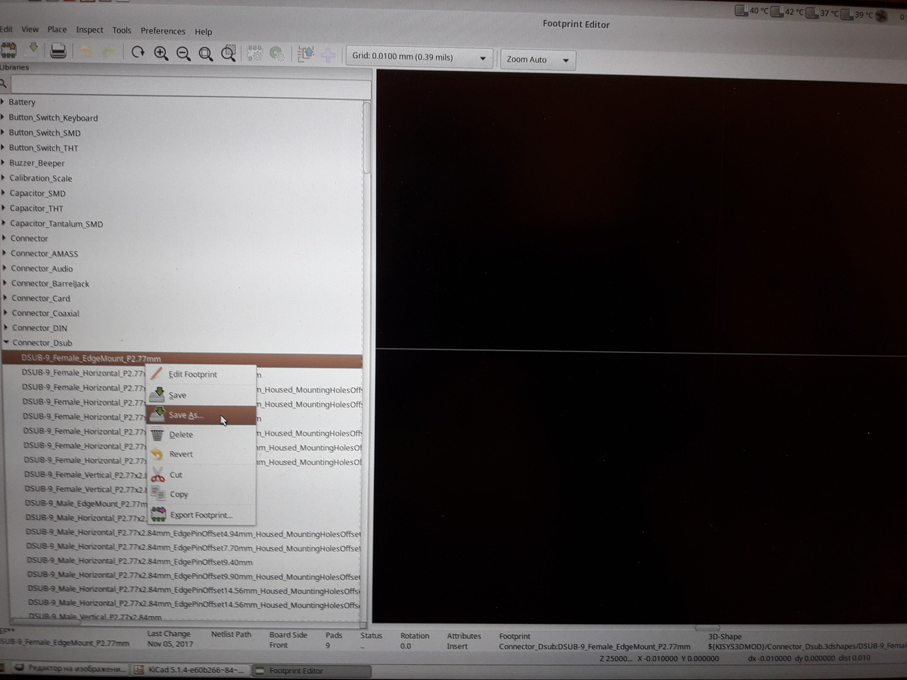

- In order to ease your life its highly recommended to organise your files (electric components, footprints, 3D-models) into well-known folders (known to the KiCAD SW via PATH environment variables). I'm attaching here the PATH variables in my KiCAD. I use Linix so the absolute paths may differ. The most important thing, however is the addition of my own PATH variables to the standard ones (KIMYLIB, KIMYMOD, KIMY3DMOD). They represent the paths to the folders I store my own symbols, modules (a.k.a footprints) and 3D models.
- Unlike some other EDA packages KiCAD uses a concept "one-to-many" which means you're not required to have relation "one electrical symbol - one component". On the contrary - you can use only one electrical symbol for NPN transistor and subsequently to assign to all transistors in your schematic particular footprints. This is done using so-called CV-PCB program module. So, it's not necessary to have a numbers of electrical symbols named for example BC550, BC547, BC546 etc. You can use only one NPN electrical symbol and assign different footprints to any of them.
For your question about dual transistor unit - in EeSchema firstly check the section "Devices" - I hope you'll find an electrical symbol which will best suite your needs. Then, if there's no suitable one, you can use an existing one as a "basis" for creating your own symbol.

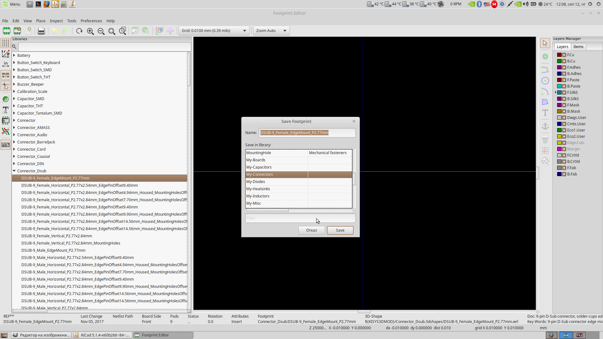

I'm suggesting you to look at the existing libraries and modules which came with the installation of KiCAD. If you think there's a module which you want to use but with some "tweaking", you can copy this module to your own folder and modify it at your taste.
BTW, on Linux the standard libraries are installed in folders with read-only access from regular users so even if you want to modify some module, you won't be able to do this. That's why the only way to modify it is copying in some of your defined folders and edit it after.
As you can see on the pictures below I split the footprints to several folders - Diodes, Resistors etc.
When copying the module I chose the appropriate folder to copy in.

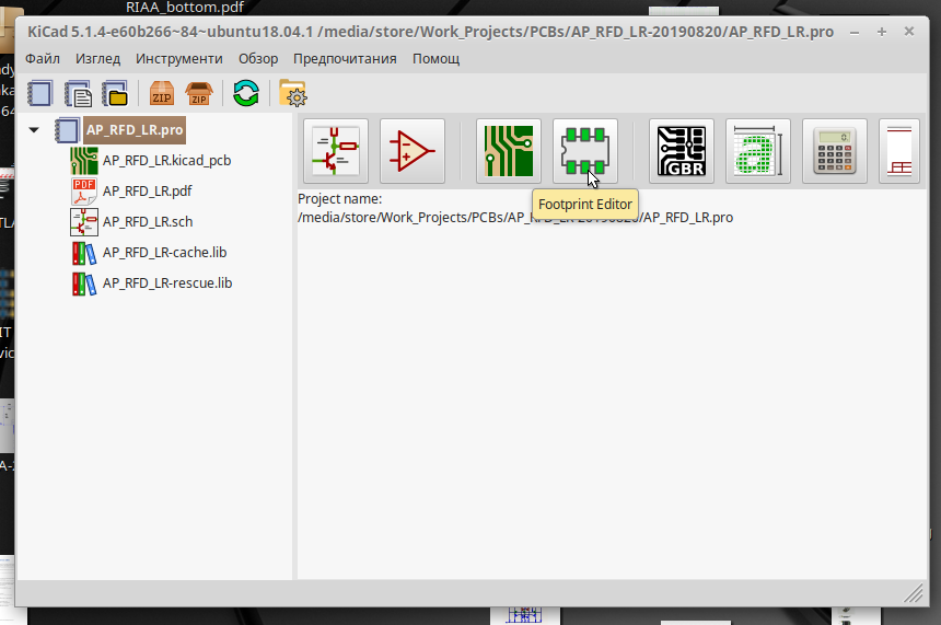

I thought I've managed to explain this but I'll try this again:
1. Open EESchema. Go to "Preferences" -> "Configure Paths"
There you can see the "EnvironmentVariables" which means the path to the library folders and its Variable Name
2. Close the window with Paths and open "Preferences" -> "Manage Symbol Libraries"
Here you cane see The NickName of the Library, the full path to the library file(s), type of the Library and description (if any). The string in the curly braces is actually the "Variable Name" defined in the window, shown on the first picture. So, actually ${KICAD_SYMBOL_DIR}/4xxx.lib translates to /usr/share/kicad/library/4xxx.lib on my system. If you use Windows, you'll definitely have a different first part, but the remaining must be the same.

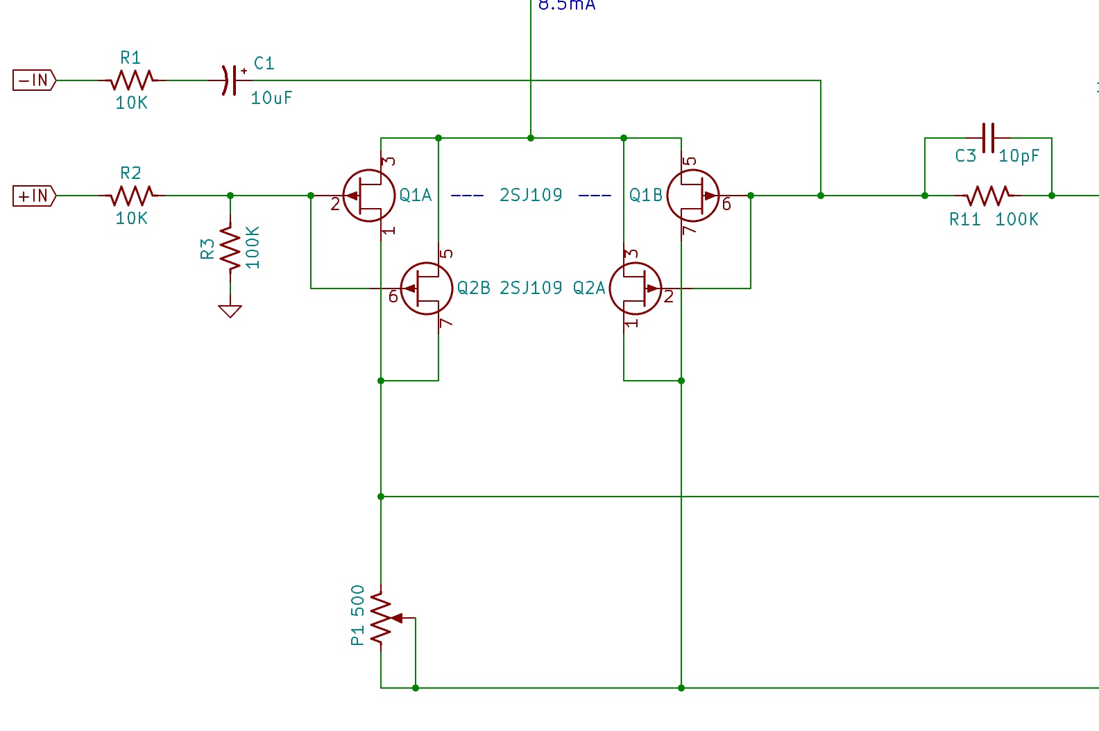

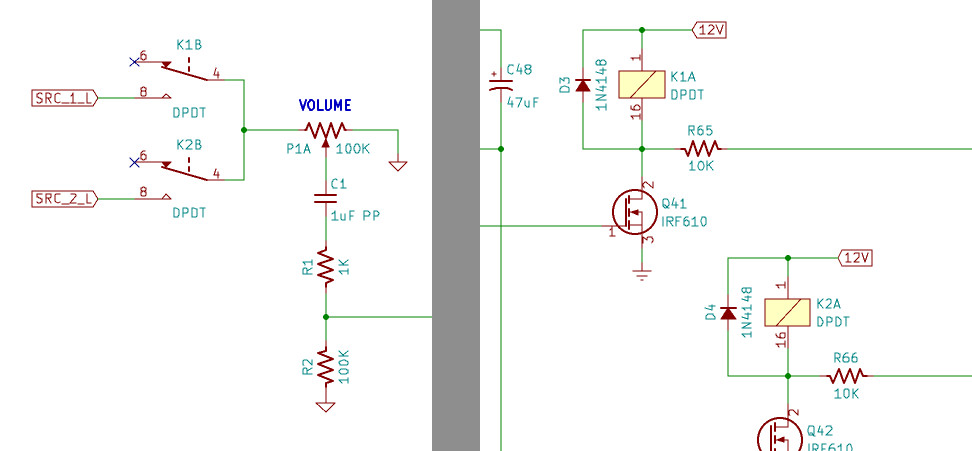

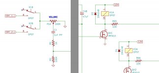

Symbol units are also a good solution for multiple transistors in a single package. They allow you to insert each transistor separately into the schematic, so that the layout doesn't always have to be identical. For instance:
attachment.php
Same for something like a relay, where you want the coil on one part of your schematic and the switch on another:
attachment.php
