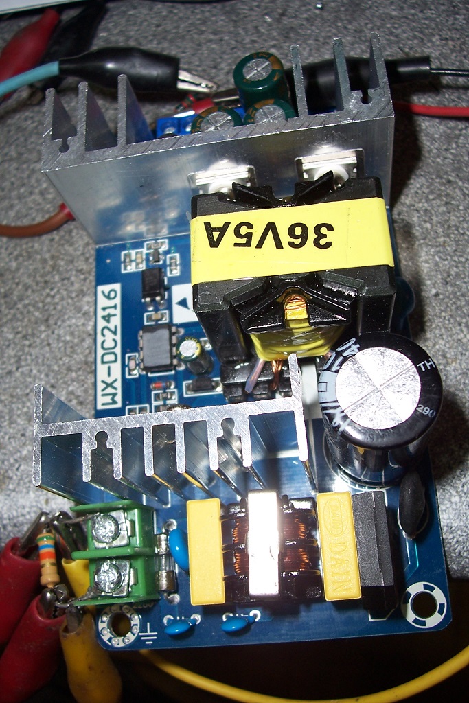

Recently, Daniel sent me a supply example to evaluate its suitability for his pet amplifiers: EZmos and OldFashioned.
The supply delivered the goods, and would be sufficient for two amplifier channels, but I also noticed its horrendous CM noise. Here is the CM voltage picked up at the output GND:

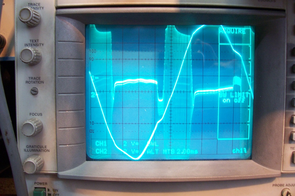

The oscilloscope is earthed, thus the waveform is measured wrt. earth. There is a large 50Hz component, which is normal, but regions of the waveform also show a significant HF hash, between 20 and 30Vpp. Such a residue can cause various symptoms in audio equipments: hissing, buzzing, whistling, etc.
The 100Hz modulation is caused by the conduction of the input rectifying diodes: when they conduct, the primary circuit is connected to the mains, and the level is heavily reduced. In-between, the converter circuit is fed from the filter cap and is left floating, causing a maximum of disturbances. It is not always the case, and sometimes an opposite situation is observed.
This converter module is particularly poor, which means it is an ideal test-bed for a correction circuit, the Cancellator:

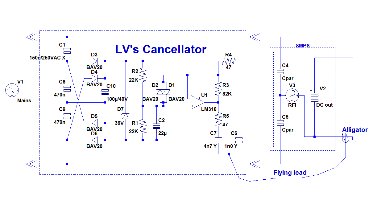

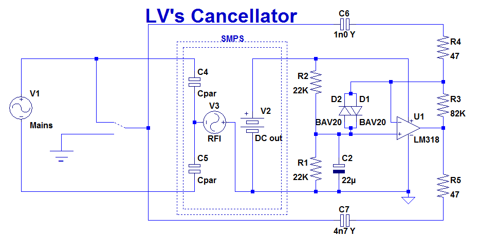

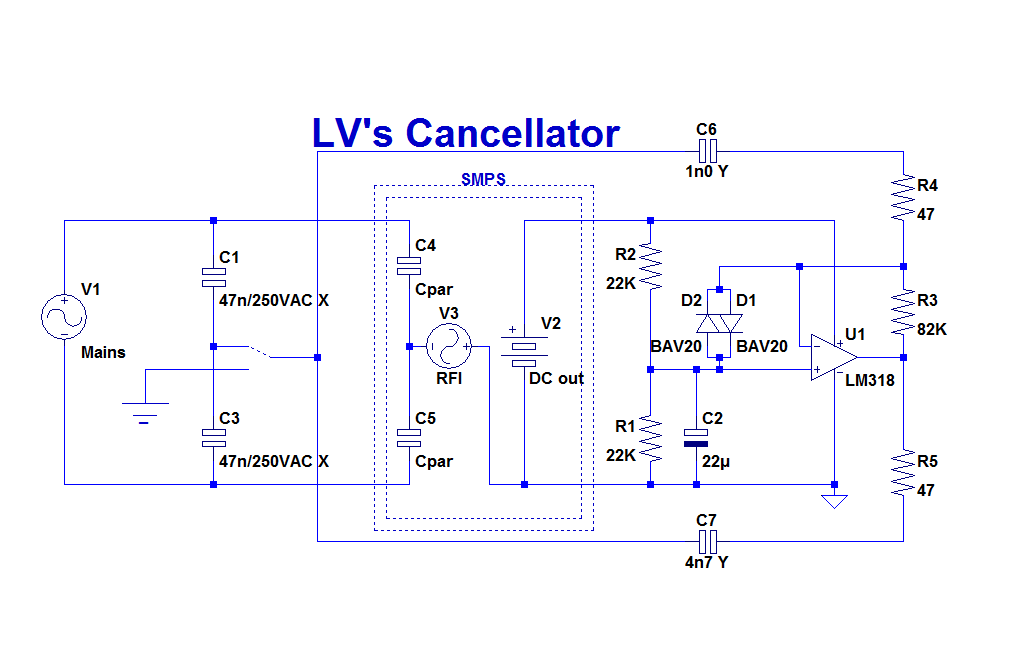

The principle of operation is extremely simple: the output GND is taken as a reference, and an amplifier actively forces the input 0V (or neutral, or whatever) into a virtual ground by injecting a suitable counteracting signal. Note that in fact the opposite might be true, but action=reaction, and the amplifier does what is needed to make the two grounds equipotential.
As always, the actual details are a bit more gory: in particular, it is essential to do the above whilst respecting the integrity of the safety isolation barrier. To do that, two Y-rated capacitors are used: one for the input, one for the output. The output one is a 4.7nF, the maximum reasonable value for such an application, to keep the correction path as low impedance as practical. It is also necessary to provide a supply for the amplifier, something the 36V output does perfectly.

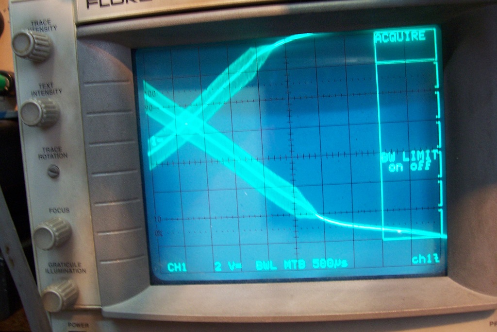

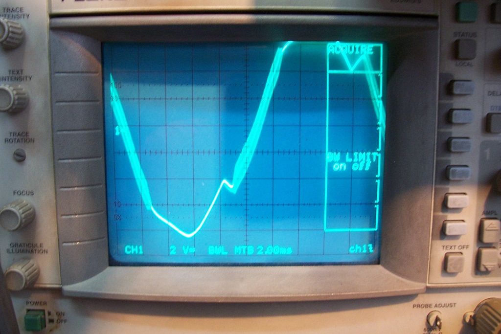

How does it work? Quite well: here are the before/after oscillograms, you barely notice a thickening of the trace on the after pic:

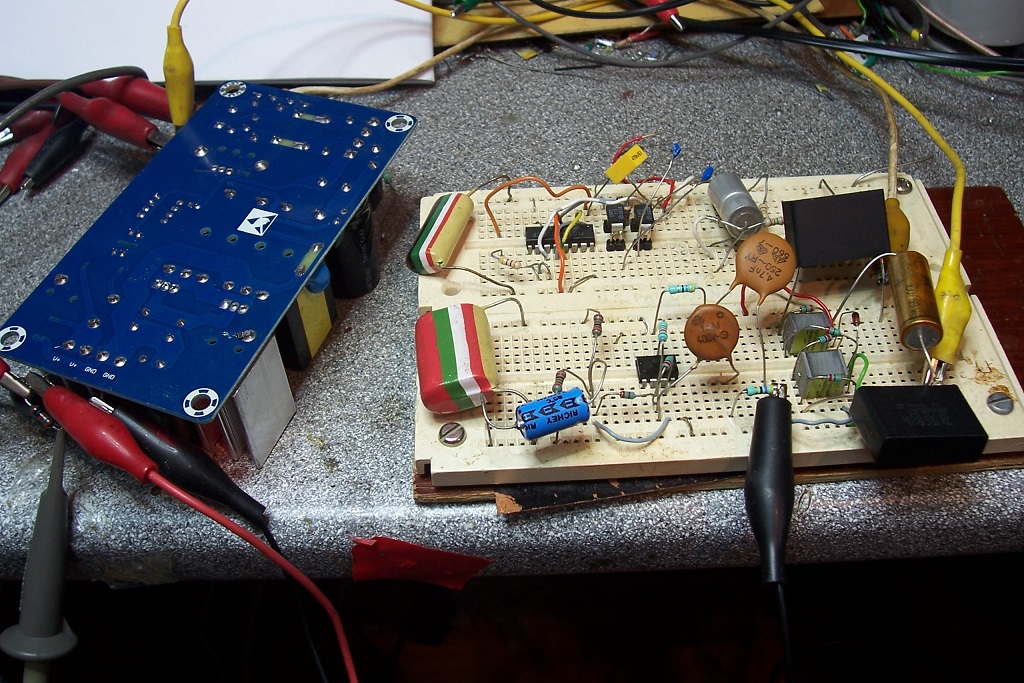

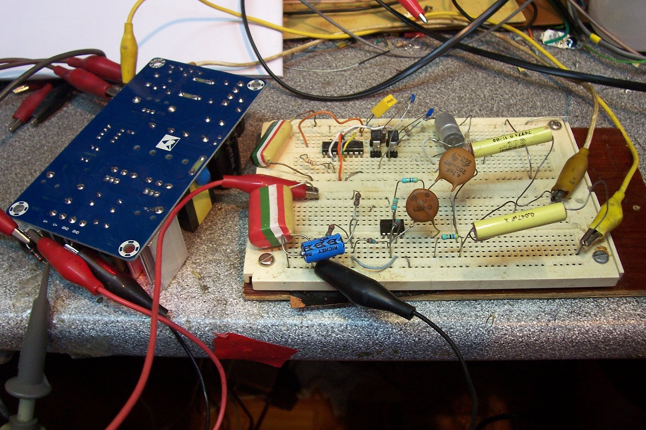

Here is the breadboarded prototype:
The base switching frequency is ~50kHz, but most of the feedthrough is from the edges, because it is a squarewave, meaning significant harmonics at 500kHz and beyond.
This is why I used a good old LM318: it has a good bandwidth, and accepts the 36V supply.
Many modern alternatives have a much wider bandwidth, but they are often more limited in their supply range. One could think of reducing the supply voltage, and it could be sometimes possible, but with this example, a really large correction amplitude is required: significantly more than 16Vpp.

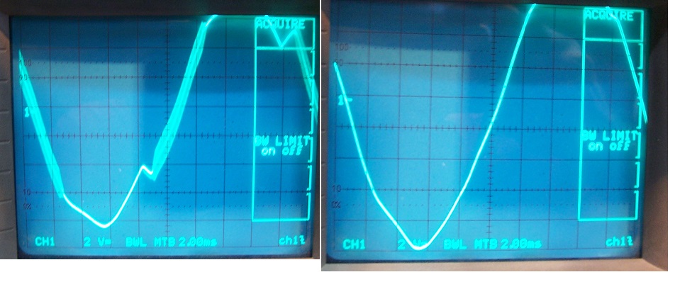

This pic shows the correction signal (measured with a differential probe) along with the corrected signal:
The bandwidth only depends on the opamp used: with something better than a 318, it would be possible to go in the tens of MHz range, but it does not look particularly necessary: the cancellation level reaches almost 40dB, because the converter module includes basic measures like a CMC and snubber

However, since the DC output voltage is not always going to be sufficient to properly power the cancellator, an alternative needs to be found anyway.
With this example (OK, rather extreme), the DC supply couldn't be smaller than 20V, otherwise the correction amplifier would begin to saturate and clip.
Thus, I devised the reverse alternative, where the amplifier is referenced and supplied from the mains. The mode of operation remains exactly the same, but the supply and correction amplifier could now be housed in a box inserted between the mains and the brick (or adapter). It brings some additional complication, but it is workable:
The ~8mA required by the opamp is supplied by a special capacitive supply: it has a symetrical configuration to ensure a continuous low impedance path to the mains for HF signals. The rest of the circuit is essentially the same, except that now the output ground is servoed to the input, but the end result remains exactly the same. Here is the prototype:
Note that an actual implementation needs to be built properly, not improvised, and housed in an insulating case, to ensure an adequate insulation from the mains. It is also important to respect the Y and X ratings of the capacitors where indicated
I have also tested other opamps, beginning with a 741.
You probably guess the result, but I had to do it and begin somewhere. It managed to improve the situation compared to nothing, but it was clearly lacking: a significant uncorrected residue remained visible.
Next one was a LF411. This was a surprise: it did barely better than the 741. By contrast, a LF356 did almost as well as the LM318. It is probably due to a tighter "grip" of the OP stage, compared to the LF411. Finally, a NE5534 did as well, or even slightly better than the 318, confirming that the robustness of the OP is paramount for such an application.

The circuits I provided for both versions are "ideal", in the sense that the input neutral/0V reference is extracted from the average of the two mains wires.
Thus, even if they are not equipotential (in HF), the reference will be optimum.
In practice however, the level of differential disturbance will be small compared to the CM, and anyway, 100% of SMPS have a X-cap at the mains input. This means that taking the "quiet" reference from just one side of the mains is going to be perfectly sufficient.
This allows some simplifications: here are the pruned circuits:

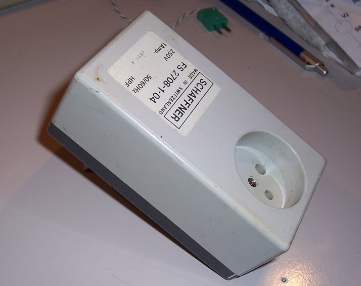

Here is how I see things, for one, two or more supplies.
You would build the cancellator into a case of this style (or a multiple outlet plug or extension):
attachment.php
A supplementary flying lead fitted with an alligator clip would connect to the output ground.
attachment.php
In the case of multiple supplies, they would of course have their output grounds connected together, and that's where the alligator clip (or other connector) would be attached.

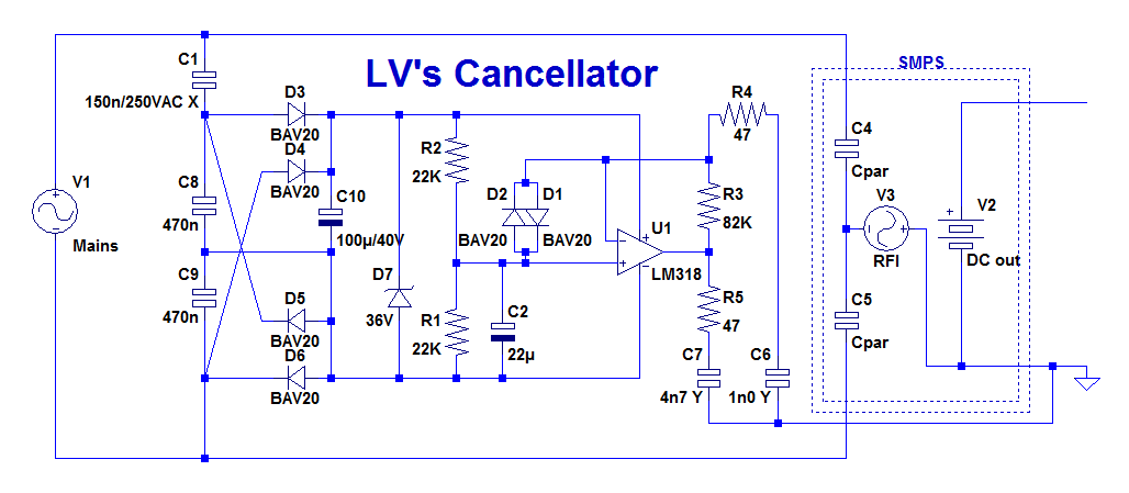

If creating a symmetrical supply ie +ve / 0 / -ve from 2 power bricks, the +ve from one supply would connect to the -ve of the second supply. The circuit works just the same if the ground is taken to the centre 0 volt point? It does not matter if the ground is to the + or the - of V2?
No, not really: all these supplies have a largish E-cap directly connected across the OP terminals, meaning that from an AC perspective they are equivalent (except for the differential-mode perturbations, but they are normally in the tens of mV range at most, whereas the CM ones are tens of volts: 60dB difference)

If a ground is available, but the device to tidy up is class II, you can try to use the earth as a "cold and clean" reference, like here:
775496d1565899795-cancellator-magic-active-cm-noise-canceller-upgrade-brick-module-smps-cancellator0-png

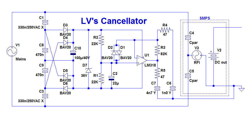

In this configuration, if you want to use an input safety earth, you should eliminate the Cancellator completely, and connect the earth directly to the GND, with the risk of ground loops.
776128d1566146496-cancellator-magic-active-cm-noise-canceller-upgrade-brick-module-smps-cancelpract-png
This risk can be mitigated by inserting a 0.1µF cap (which will also eliminate the possible safety role, but it was not needed in the first place).
Regarding the Cancellator itself, it has to be treated as class II device, properly insulated, etc., and there is no point where you can connect a safety earth
No, it is not problematic, and certainly not dangerous.
