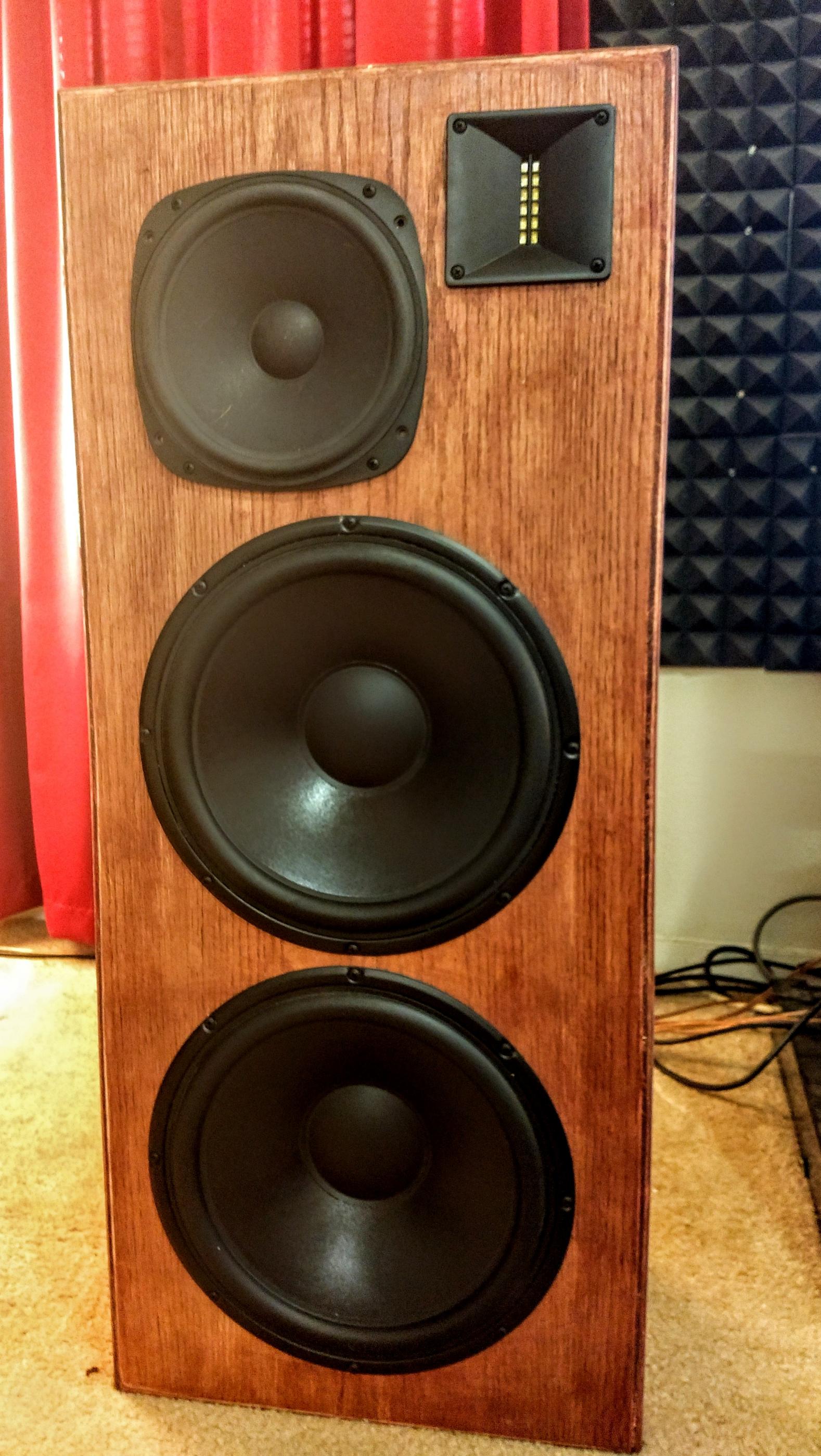

I can whole heartedly agree with the Peerless SLS line for woofer duties as well. I'm running SLS 12's and have run SLS 10's also. They just do what they are supposed to.
As far as distortion in the SB20's is concerned, I will politely dissuade you from that concern. I am continuously amazed and gratified by what I hear. For the money they are a steal. I've tried smaller full range drivers during the development of what I have now but I always circled back around to the SB20's. They keep up with the dual 12's and sound amazing; detailed, clean and will play loud with authority.

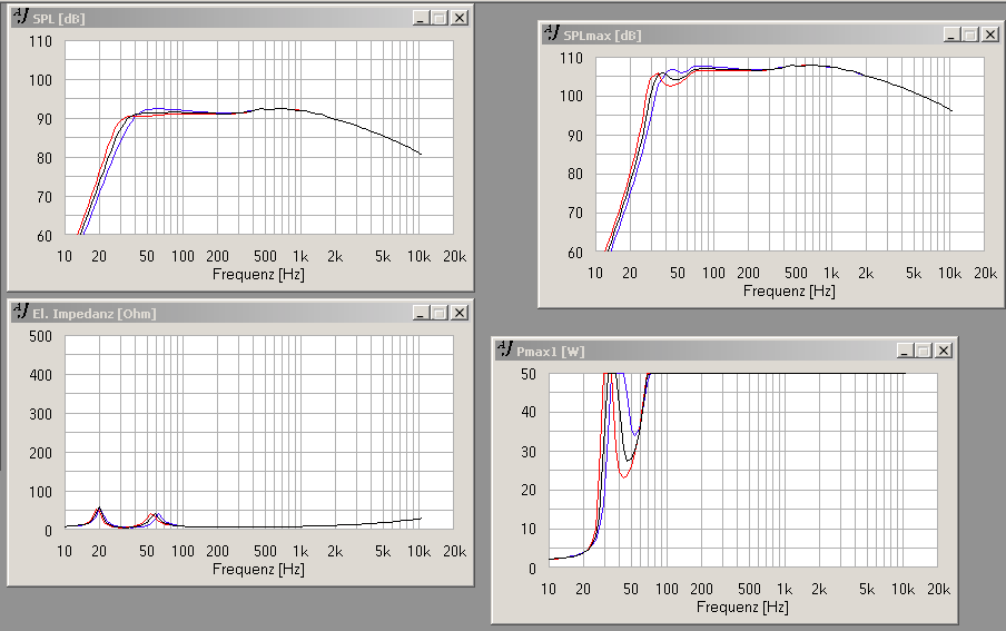

But i would highly suggest to use this driver only as a sub, due its resonating nature in the mids.
A quick simulation at 40; 50 and 60 liters with an vent of 70 mm at a length of 30 cm.
