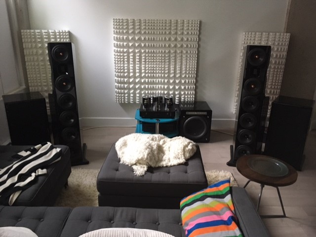

I have a system that I very much like already, but I feel like it's time to add some new speakers to the mix so that I can play with something different from time to time.
When not in use for 2 channel, they would serve duty as rear surround speakers in some kind of Frankenstein HT system hi-passed at 80-100hz, roughly 3 meters from listening position.
My new FH3s would mostly be used for late night listening in near field arrangement. The room if fairly big at about 3000-3500 ft3 (9' ceilings), but the main listening position happens to be 6 feet from the main speakers and these new ones would be even closer at about 5.5ft (roughly 4ft from front wall). Moderate volume and nothing over 90db at listening position.
Most likely they would need bass reinforcement and that would be provided by a pair of servo-controlled OB subwoofers located on each side of the main speakers.
In terms of amplification, 2 different flavours for 2-channel: high power class-d that sounds incredibly good and natural (Mivera SE amp with 1200as module) or SE AD1 tube amp similar to 2a3, 4WPC.

My room is treated with diffusion on front wall and behind main OB speakers, absorption is used on side walls for main reflection points.
So......what would you do if you were me?
Current system configuration

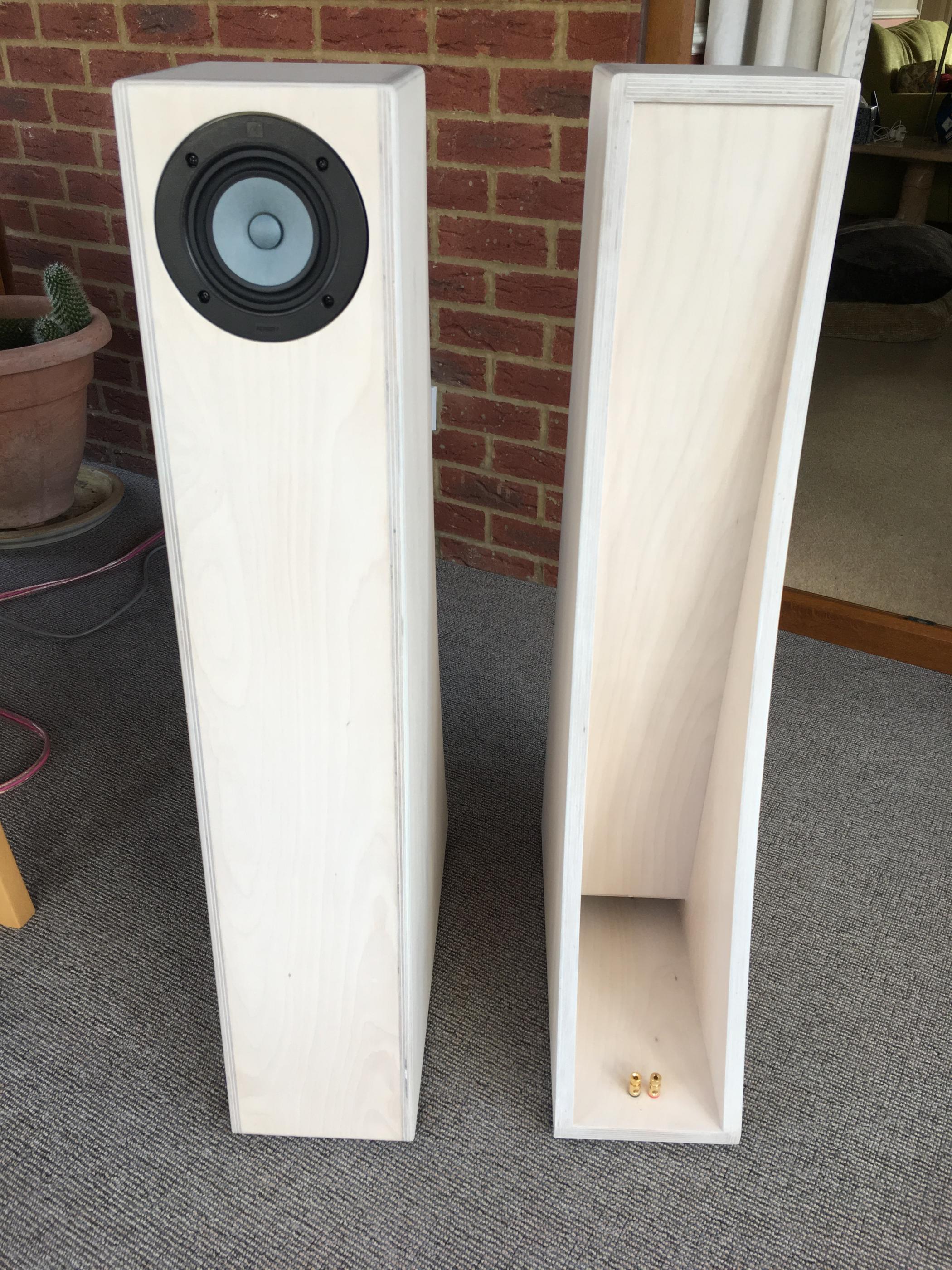

As you know I ended up ordering a pair of 7.3eN drivers from you and I can't wait to move forward with this project. Thank you for helping me out in selecting drivers.

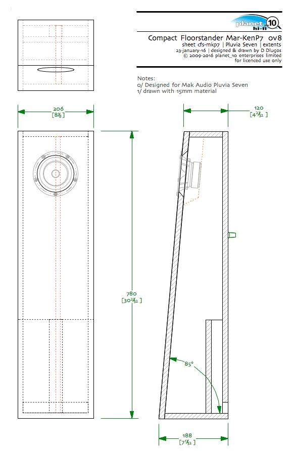

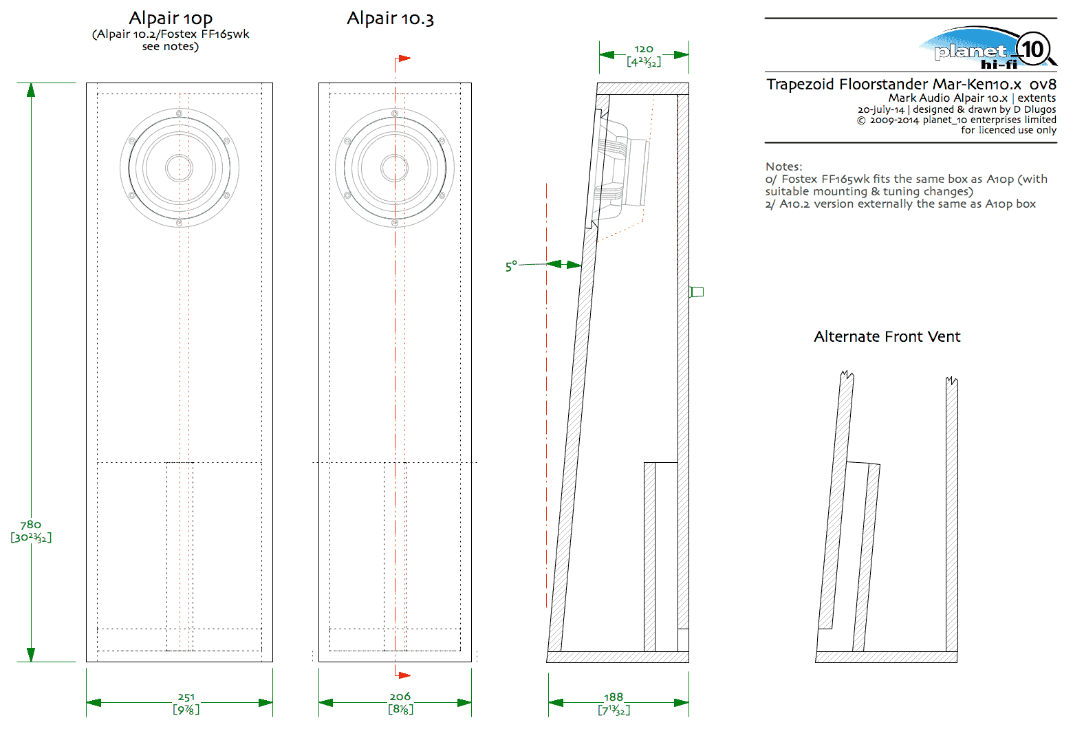

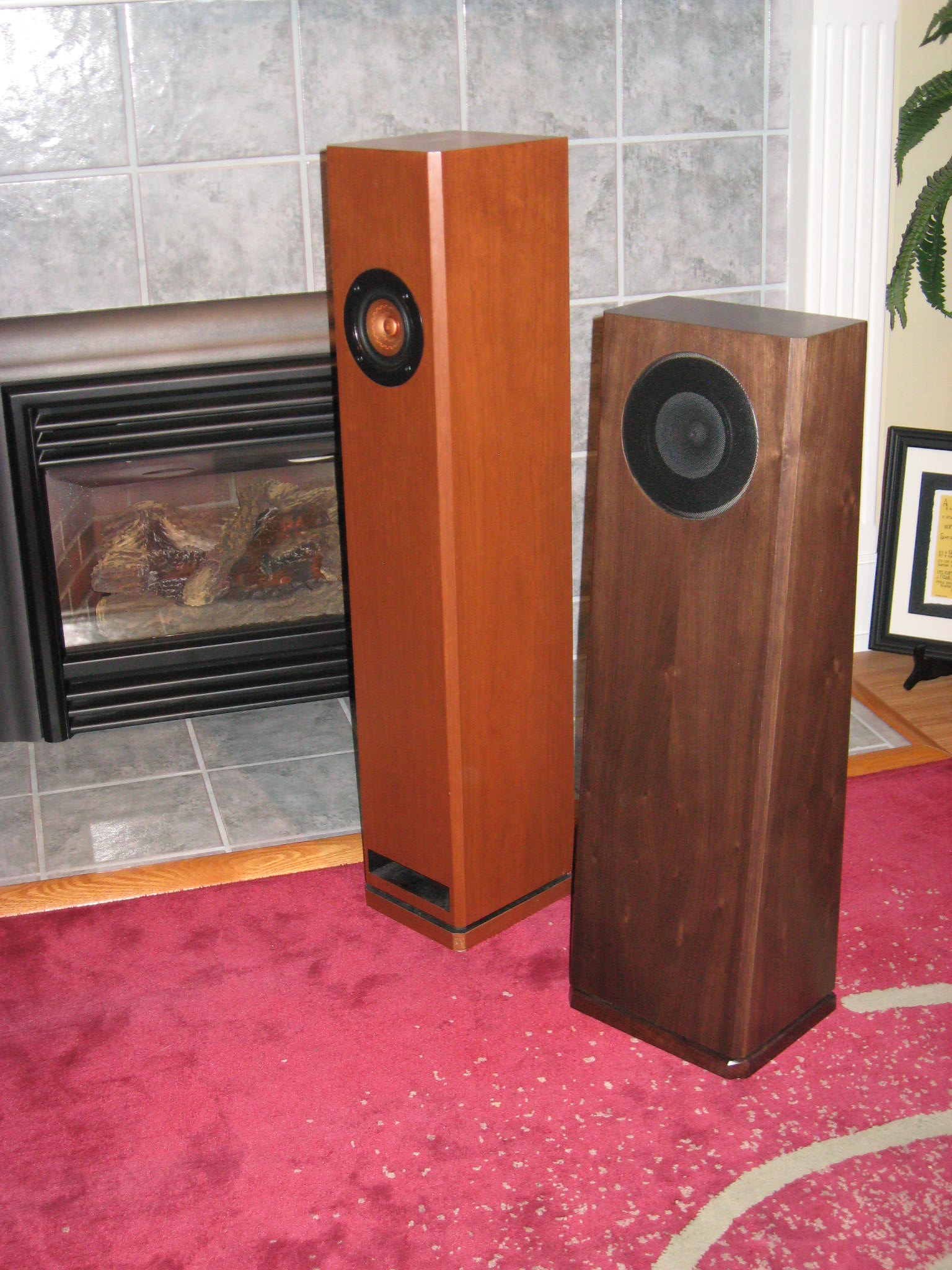

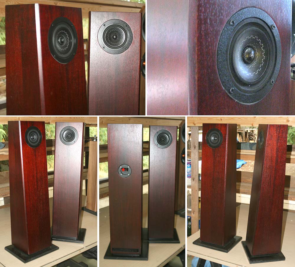

Considering the above and the fact that he wouldn't mind a bit of a retro look, I've been looking at your compact floorstander Mar-Ken design and find it rather appealing.
At this point, I'm considering the Pluvia 7 driver which is quite affordable. I couldn't help but notice that the enclosure dimensions (Mar-Ken10x) are identical if fitted with Alpair 10.3 drivers and only slightly larger for the 10p paper version. I assume that the bigger drivers have potential for greater scale and SPL which could be a good thing for ambiance music considering distance from speakers (?).
I'm also wondering how they would compare in terms of bass extension and slam (anechoic F6, F10, typical room response)? Also if you don't mind please include FH3 with P7 driver as well as half-tower mltl (pluvia 7) in the comparison just in case they're the ones that get approved by his spouse :D

Compact FloorStanders (so far) come in 2 sizes so far, the original 13 litre (EL70, A10.3, Pluvia 7) and a wider version for A10.2, A10p, FF165wk. The last 2 drivers will fit into the smaller box with a bit less extention. Each driver is tuned to its optimum retention, the P7, EL70, A10.2 have the greatest potential extention.
In the FH3 the horn dominates so drivers tend to have the same potential (but some like the FE126 need some help — ie corners). It will have an edge over the floorstanders for extention.

Well that doesn't look too bad. Thank you, Dave.
Would you advise to go with the vent located in the front? That way they could be kept relatively close to the wall if needed in order to reinforce that bass response a bit?
Does the rest of my reasoning make sense or does it simply come down to a matter of taste?
13 litres.
A10.3 est F6 mid 40s, F10 40.
P7 by the sims only goes moderately lower. Tiny bit.
Not as much as i thot.
