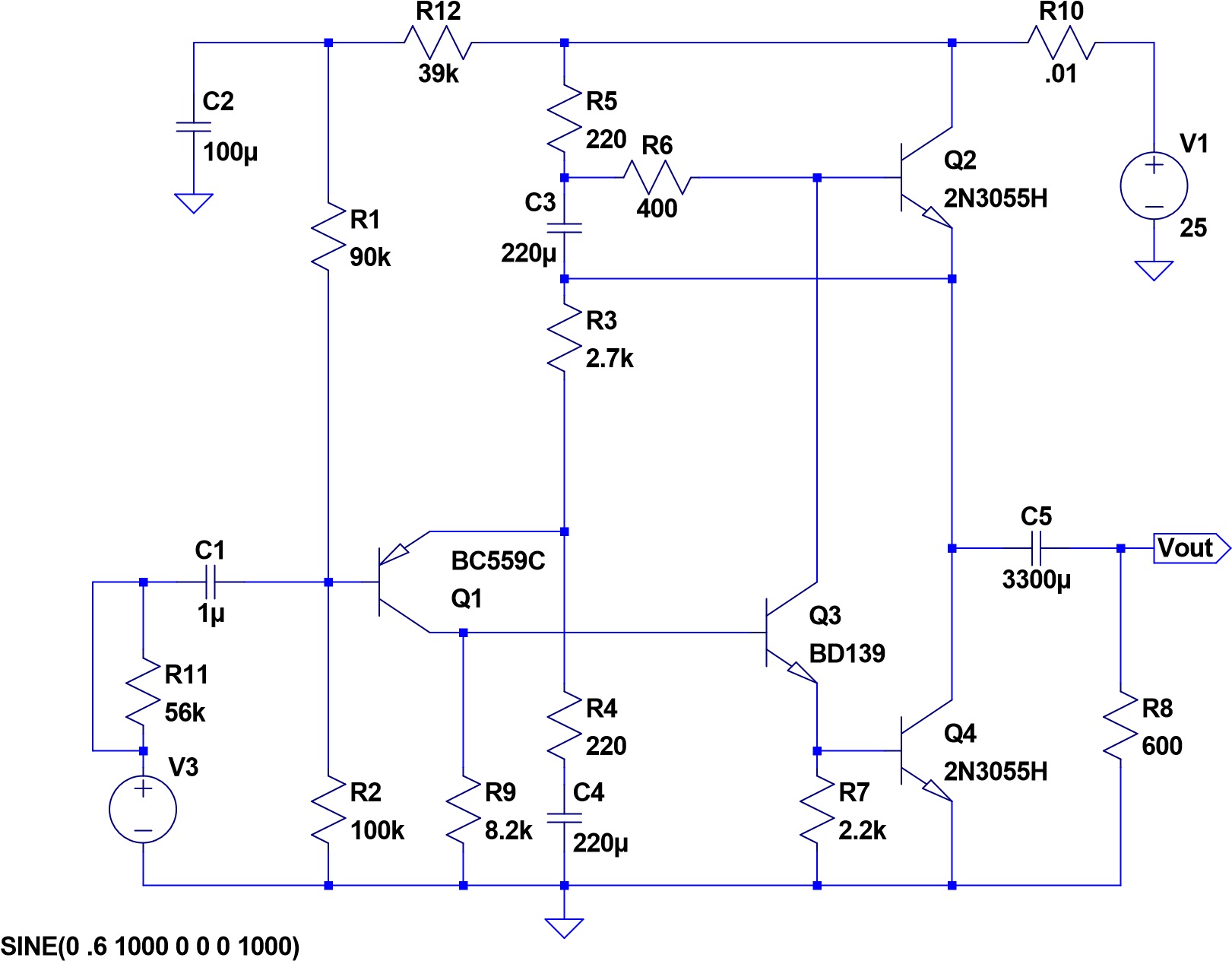

What am I seeing here?
Joined 2004
The attached plot shows the emitter current of Q2 and voltage at the node between Q2 E and Q4 C. What is going on with the wiggle at the bottom of the current plot? I see the same thing at Q4 E but 180 degrees out of phase obviously and everything looks fine in the load resistor.
Thanks,
Marty

That connection between the emitter of q2 and collector of q4, and the junction of C3 and R3 is weird. If you look at the JohnE Basic50, and the Apex AX6 Retro Amp 50W Single Supply - Page 22 - diyAudio
they run the feedback back from that point to the emitter of the input transistor Q1. The AX6 schematic is on page 1 of that thread or somewhere close. AX6 also runs feedback from the output of the final capacitor to the emitter of Q1 through a resistor & a DC blocking cap.
This schematic is primitive anyway, with no emitter resistors to prevent the output transistors from thermally running away. Two drivers works better also, in a day when driver transistors cost $1 instead of $10 like in 1974.

Thanks for all of the replies. It works the same way with a couple of 3055 models I have both of them below. The swing at the output is 7.82 volts peak. Taking C3 to ground fixes the current waveform but the distortion at the output goes up considerably. Reducing C3 to 4.7uf fixes the simulation. I have no idea why it works though. I should mention that normal loads in the 4 to 15 ohm range I don't see any of this.

The top transistor is a CCS so it is always better if you can choose the lower transistor to be the one with higher HFE. Try the 2N3055H at the bottom. The BF=129 (versus 73 of the 2N3055) shows that it is of higher gain.

Using a higher hfe part at Q4 fixes the current distortion at Q2 but Q4 still shows the distortion. Reducing the size of C3 seems to work well no matter if the outputs are equal or using the higher gain part at Q4. If C3 is too low the harmonic distortion at the output goes way up. (second is raised by 20dB or so at 1uF)
I have still have no idea why it does the weird frequency doubling thing unless I change C3 and maybe it is one of those things that won’t happen IRL.

If you want to use the amp both for speaker and hp, you can add dummy load just like traditional amplifier, to keep the load impedance around 8 ohm. But if you want to use it only for hp then you can modify the amp.
C3 is to make sure there is constant voltage across base resistor. This in turn create constant base current. This base current, with hfe, turns top transistor into constant current source to make distortion lower. But you cant just reduce the cap without affecting bass roll off. There is a minimum (RC) value.
To solve your current issue, i think you can reduce the overall gain, which you don't need much if only for hp. Or, may be you can move the bootstrap point closer to the rail. Your base resistors are 220 and 400, you can change this probably into something like 100 and 520. The total resistance determine the base current.

On the negative peak, Q4 is turning Q2 back on because the 600 Ohm load does not draw all the Q4 current. You can adjust R7 so that Q4 comes on when Q2 Vb is at half V1, but this does not work when you have a reactive load or not exactly the predicted load value. A successful class AB output is designed so that the crossover can happen at any voltage. This is 2019 so I suggest you buy some xx2955 PNP power transistors and make this dog of a circuit into one that works well.
