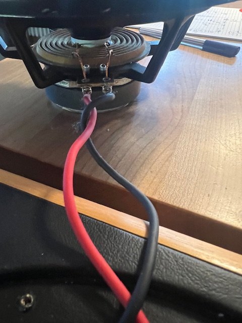

Hello everyone,
I saw these posts here about the Dave Barriman DBS6, I found 2 of them in a friend's basement and would like to restore them. If anyone can provide me with information, including copies of the articles from Hifi News and Record Review, that would be great.

I attach a PDF of the original articles, and am still using my DBS6's as recently as 10minutes ago :)
There is nothing to deteriorate with the crossovers, no electrolytic caps. The tweeter is the Morel MDT30 - still available as are the tweeter diaphragm service kits (the soft domes are easily pushed in by idiot children but can be sucked out with a gentle kiss :) Mine have always popped out fine with no damage. The woofer is (I think) a modified Vifa unit with no tendency to rot or crack surrounds, which are butyl rubber not foam. With a bit of luck, unless they have been grossly mistreated they should be fine, with refurb limited to cabinetry. Even the internal cabling was good quality VDH CS12.

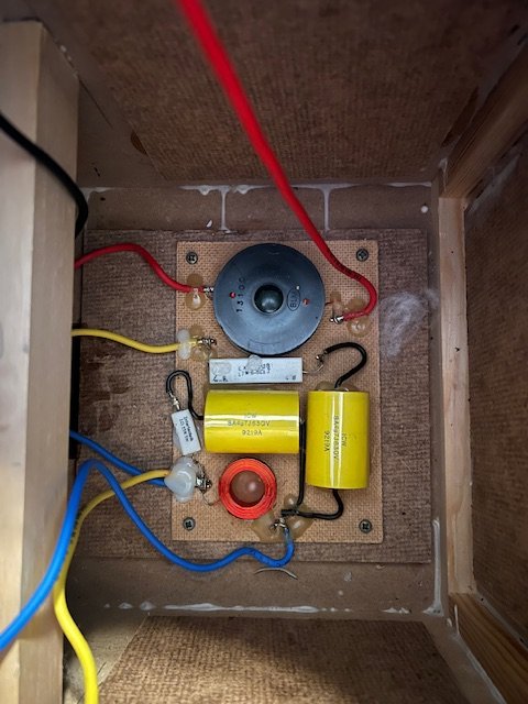

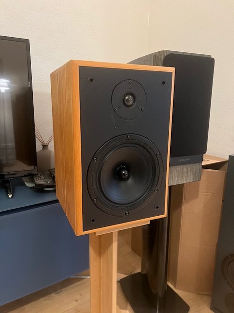

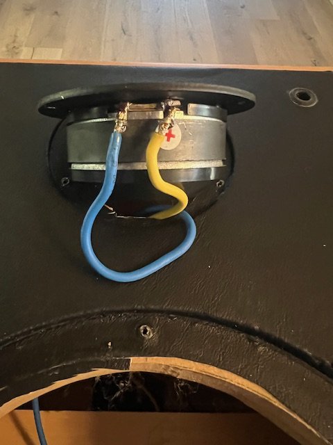

Hi Halftone,
thank you very much for the quick help, the circuit diagram of the crossover is super helpful, as I suspect that's where the problem is (a bit dull in the highest heights), otherwise I'm also listening via the DBS6 at the moment :)
In the article I could see that my uncle did everything exactly according to the construction plans, I had drawn the crossover myself, so the article is a great help. Thanks alot!
I just see that all cables have the color code as mentioned in the article :)) Very good replica :)

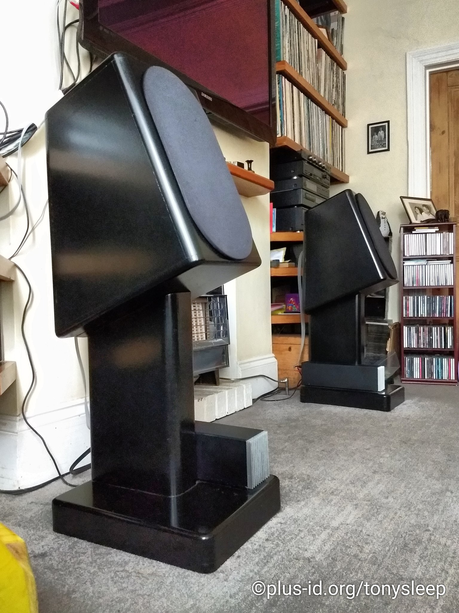

IME DBS6 are best with your ears on, or a bit below the woofer axis, IMV that gives better integration and tonal balance. I think the woofer beams midrange quite strongly near the crossover point. Off axis this seems to be part of why the DBS6 can sound dull in the near field.
If your stands aren't tall enough the speakers can be tilted backwards to raise the axis, which also puts the drivers in better time alignment. Or try them inverted with the tweeter below the woofer.
Because I don't have the room for 60cm stands and have to sit 2.5m from the speakers, I diverged from Berriman's design by tilting the back panel, and making stands to support the speakers angled upwards, on very heavy sand-filled and spiked pillar stands. They have a chamfered platform that slots into recesses in the speaker base, so can't be pushed off or over by kids (this mattered when I made them). Box volume and baffle size are the same, but all edges are radiused. I've not regretted this perversion, although if I did it again I'd reduce the angles by 5-10degrees. There is no sense of 'sound from a box' - the image just floats in space. It also has the very useful side effect of making it impossible for people to put cups or pot-plants on top of the speakers.

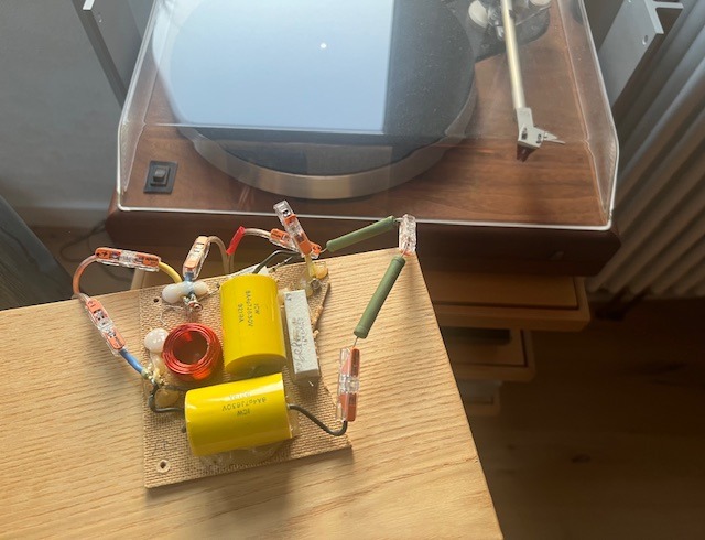

Hi, that’s a lot of good information, I’ll listen to the DBS6 even more in the next few days, and I have the impression that the longer they play again, the better the sound will be, they haven’t played for at least 10 years!
With their information, I will consider taking the crossover out of the box so that I can try all the variants from the outside.
It’s going to be a long weekend :) Thanks for the tips :)
your Dbs6 is very cool with the stands
Hi, I mounted the treble section of the crossover outside the box. I quickly tried out 4.7 ohms and 5.5 and ended up with 5.5 ohms, only in the row position. A light turns on in one corner or another. It's fun to listen to. This is already going in the right direction!

I'll give you an interim result, the resistance of 5.5 ohms in series has proven itself! At 4.7 Ohms the timbre of some female voices also changes slightly.
I don't hear any difference with the Zobel, whether it's the standard version with 1 ohm or with 4.7 ohms or without the circuit at all. It's very likely that I won't change anything about it.
On the weekend in the evening a friend who supposedly has better ears than me is coming, let's see what the result is :)
I'll get back to here if we come to a conclusion.
