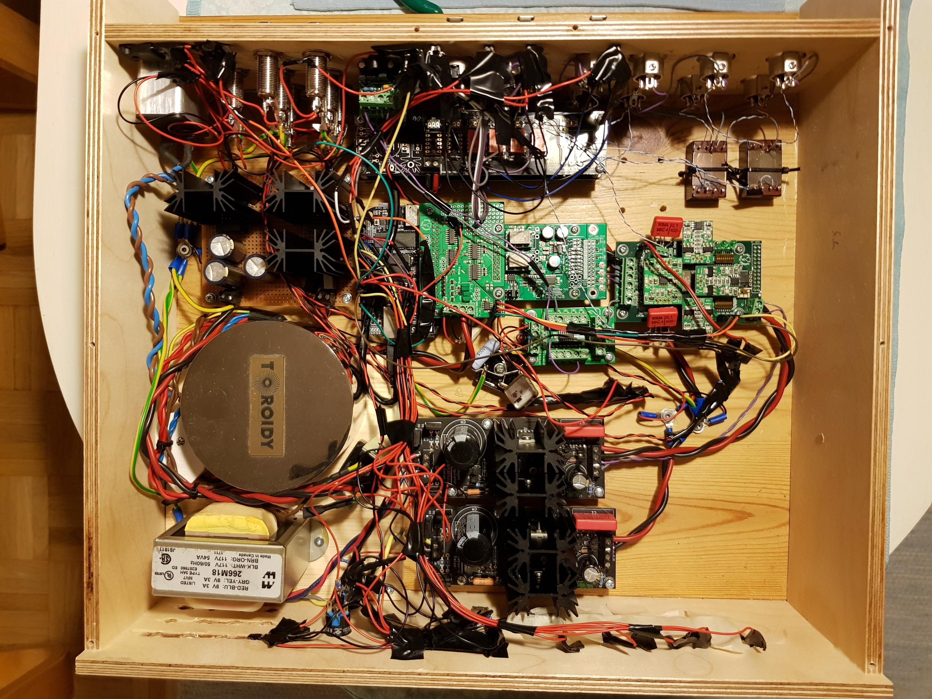

It took me a bit of googling to put everything together, so I'll describe my build it in case it is useful to someone else. I'm a beginner in DIY audio, comfortable with Linux but not with electronics.
About this build
I used a 7805 regulator for powering the bbb. My unregulated voltage is about 16 V. The 5V-regulators heat sink is quite hot while the battery is charging, but cools down when charging is done. Input selection relays and LED:s are powered with 12 V from 7812-regs.

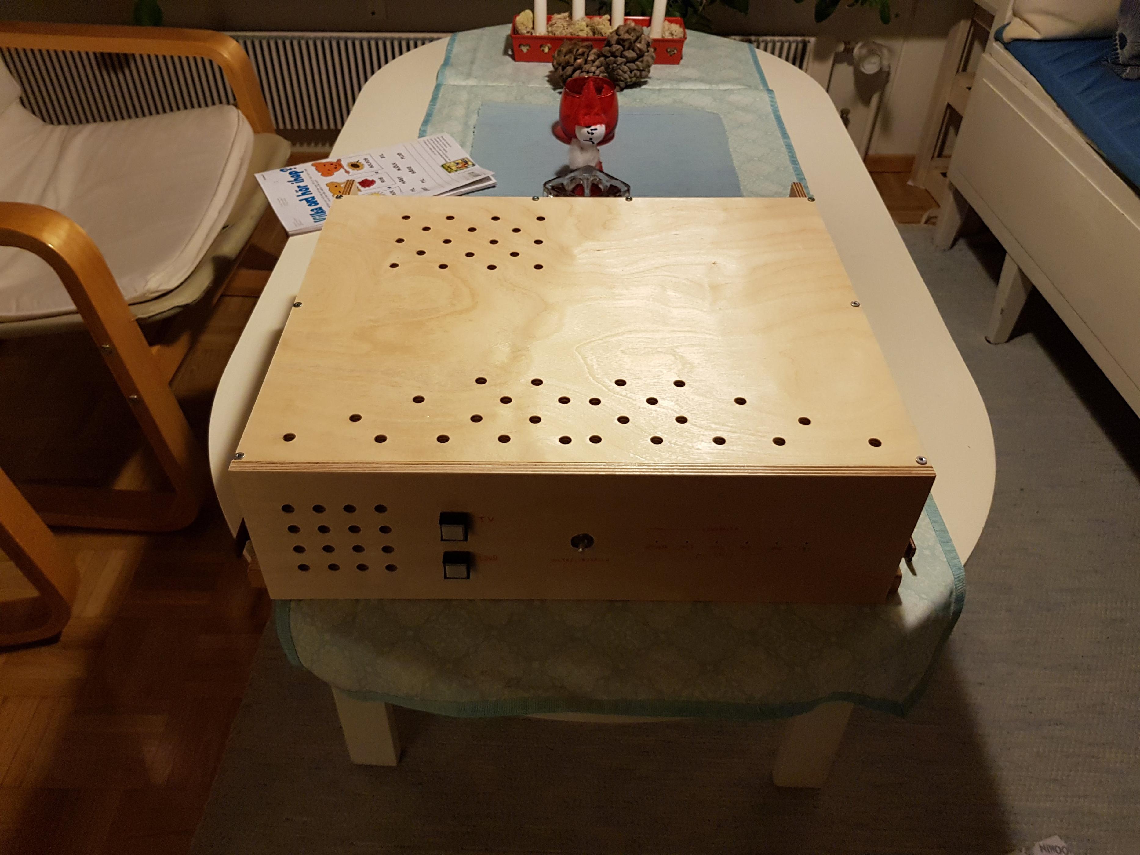

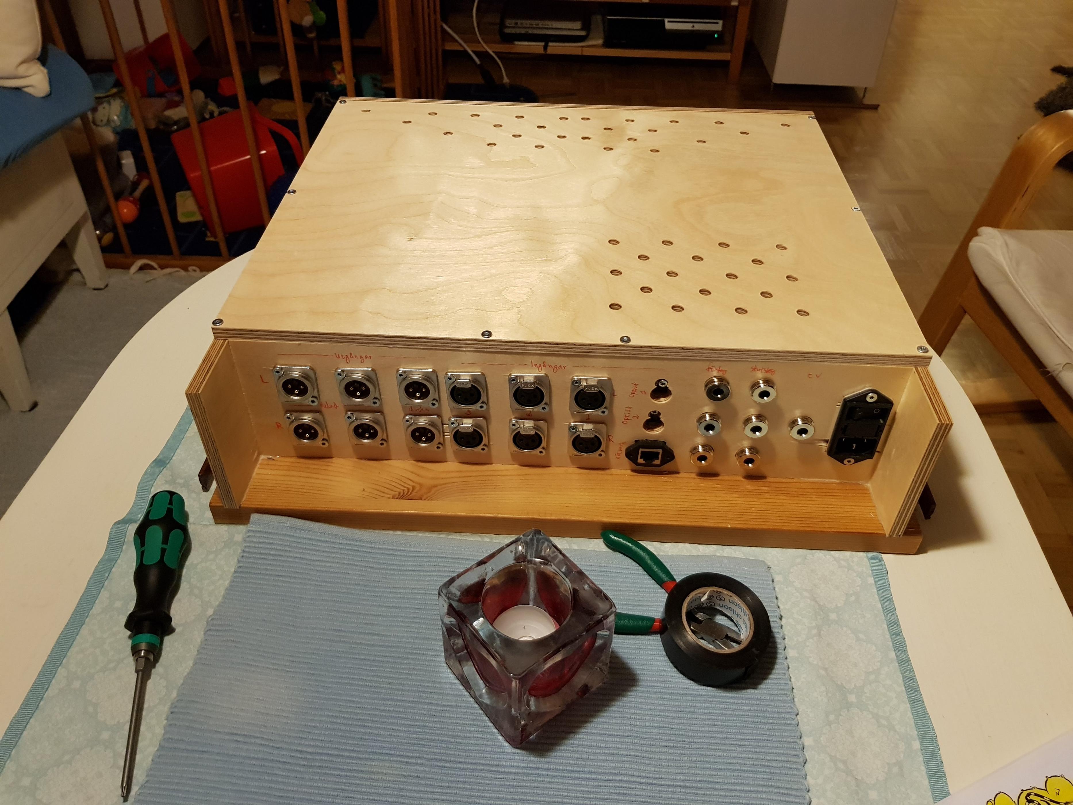

The appliance accepts IR remote control, has buttons for turning on the soundsystem and the TV (via external relay boxes) and 3 XLR aux-inputs. My better half has accepted it as useable and output level is limited so that my children won't blow anything up.
The dac-portion is unremarkable (but good-sounding), B3SE with iv resistors to a Salas iSelect and after that raw and transformer coupled (LL1527) outputs. I run my bass amp from the raw and my mid+treble amp from the transformer coupled output. The transformer does the low-pass filtering.

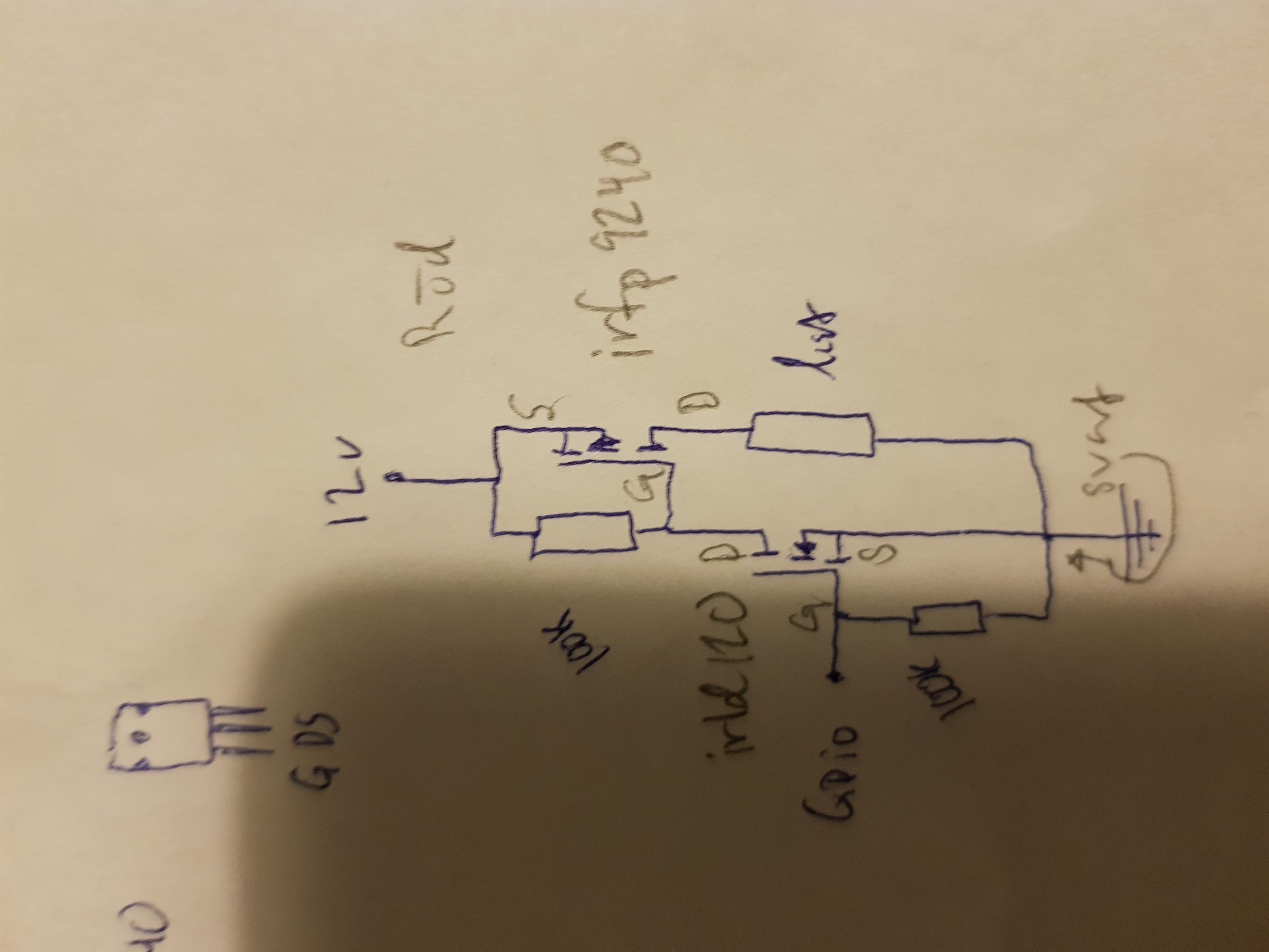

For logic level switches, I have used IRLD120. These are cute and cheap little mosfets. I measured a couple and they had Rds ~0,2 Ohm @ Vgs 3,5 V. Works like glue.
For switching mains-relays, I did a high side switch using IRFP9240 and IRLD120.

Overall I'm very happy with this build. When I do this again, I will not try to fit everything into one box and make it at least slightly repairable/less crappy. The twisted pear stuff really deserves to be made in a not crappy way.
There should be something like 100K resistors tying the XLR-inputs to ground (to avoid loud pops when switching to an unconnected input.)
